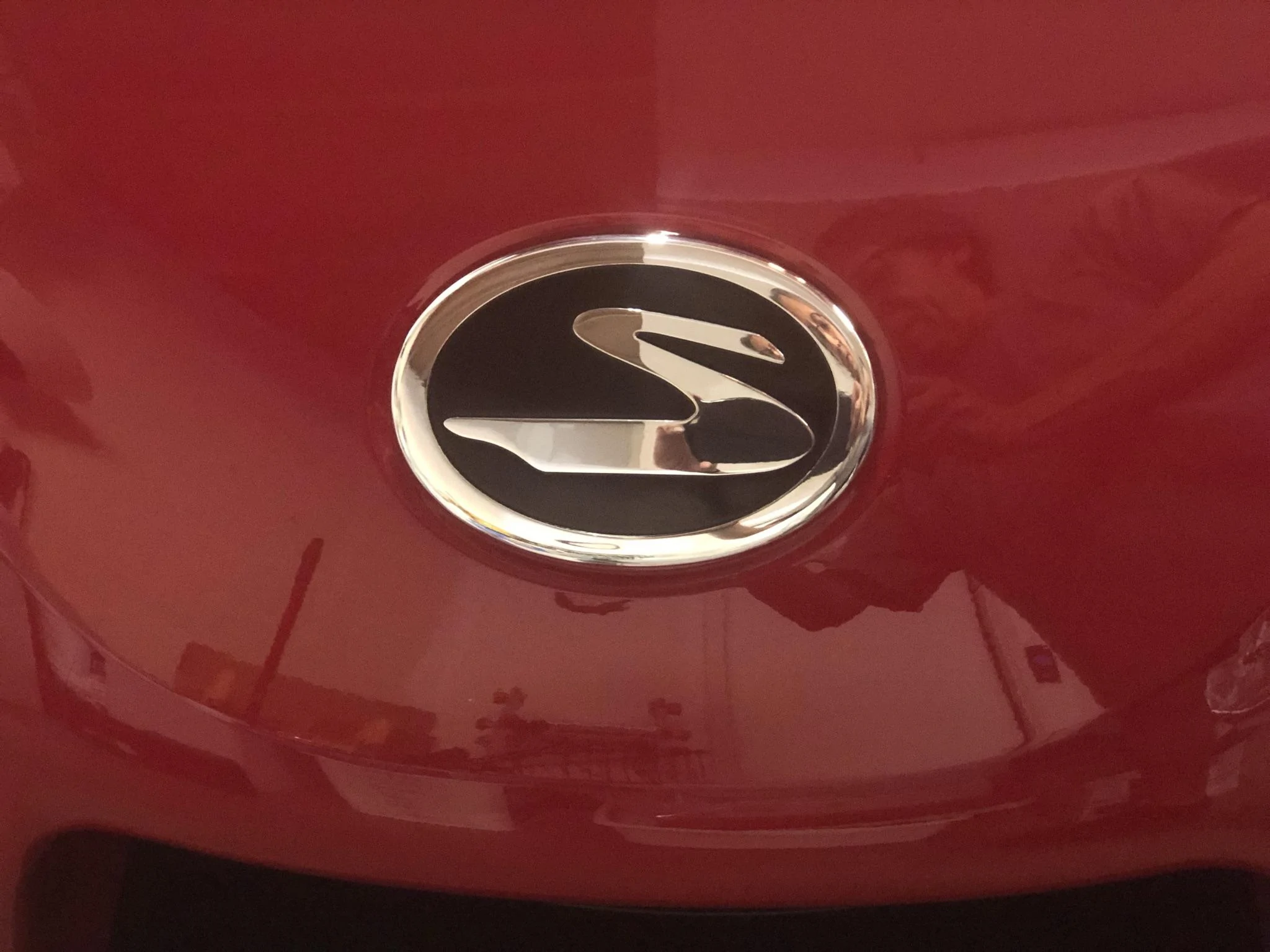

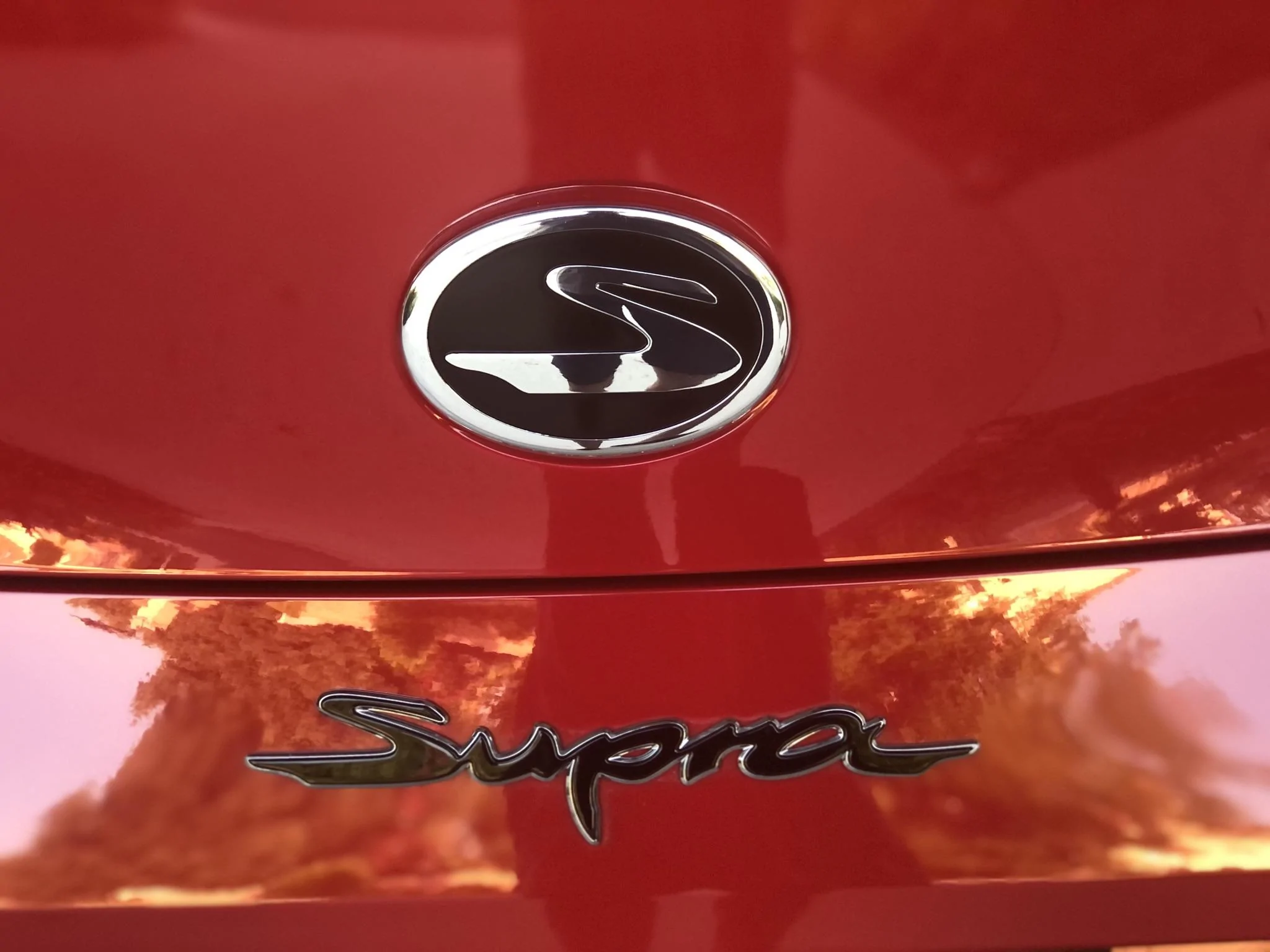

The middle hole on the front is toward the bumper. OEM badges have a depression in the center, which doesn’t have any adhesive. Keep that in mind when removing them. I used thin nylon wire and a hair dryer to separate the adhesive, and a trim tool to pry out the pegs on the front (rear popped out easily). I used a piece of cardboard, with an oval cut out, to protect the paint on front and rear. I used a bit of the adhesive from one of the badges to roll away whatever adhesive stuck to the car (a trick I learned when I was a kid). It takes some time but it cleans up completely without chemicals. The black dots in the photos are bits of adhesive that I used to temporarily plug the holes.

I had these custom aluminum badges made:
They were pricey and took about three months to get them. For anyone interested, go to
billetbadges.com, fill out the form on their site and attach these photos so they know what design you’re inquiring about.

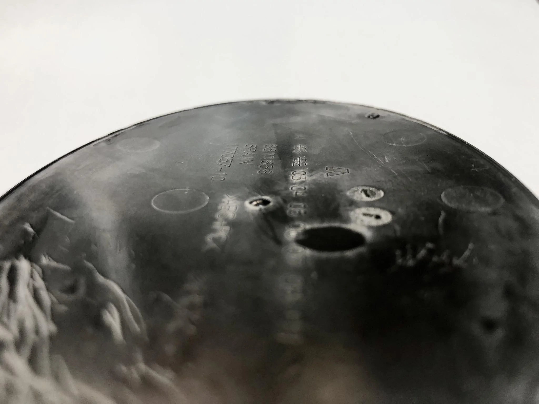

Hi guys I have a question for those of you who have take the trunk badge off, I was wondering if someone could measure the depth of the curvature on the underside of the badge.
I've tried to illustrate what I'm after in the attached drawing
MyCorolla
Jun 4, 2020
273
270
Southern California
ICE
Best I can measure, it’s 2mm to the top of the round knob in the center, which seems to be 0.5 mm in height. There’s also a less-than-half mm lip all around. The factory adhesive would cover that lip but leave the knob exposed since it has an oval cut-out in the center.
