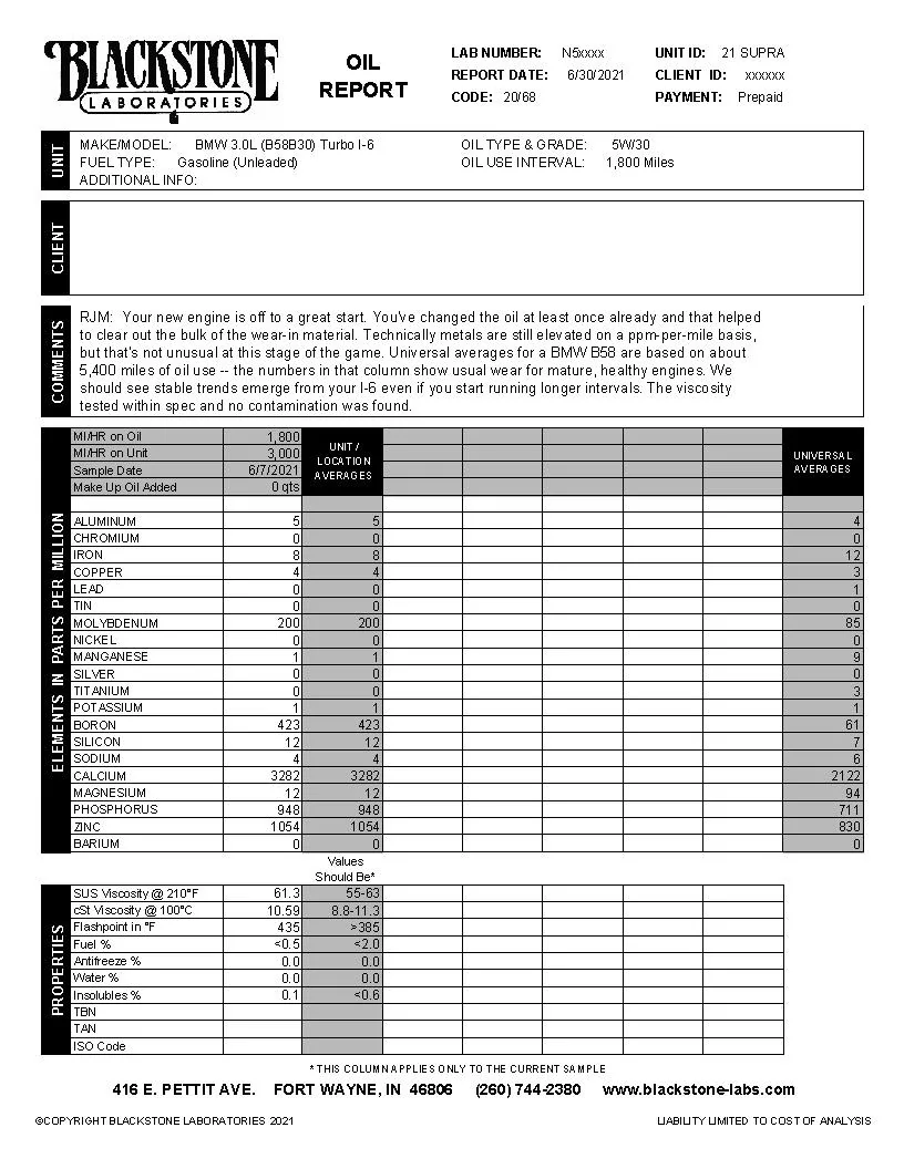

My Blackstone report just came in. Looks like I’m off to a good start with this B58TU engine. I’m going to run another report at 5,000 miles to see if anything changed.
Stats:
- 2021 with June 2020 build date
- Hard engine break-in
- Dumped factory oil at 1200 miles and switched to Liqui Molly 5w-30
- 1800 miles on lab sample oil
- iDrive showing max oil level at all readings
-RJM

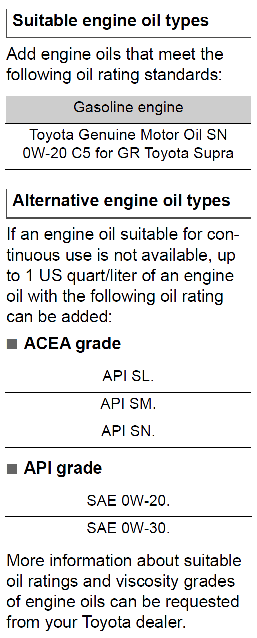

You do realize that the manual says you can run 5W30 or 5W40, right? It's just for "temporary use" and isn't officially recommended. I'd be surprised if Toyota was able to deny a warranty claim on that basis, but you're right, it is a risk.
No, the manual does not say that. The manual says you should use 0W20 C5 but can add up to a maximum of 1 quart of 0W30 API SL/SM/SN.
Like any manufacturer, Toyota will obviously deny an engine warranty claim if they learn you used an out-of-spec oil.
Yes, sorry I realized that after I posted and removed it
