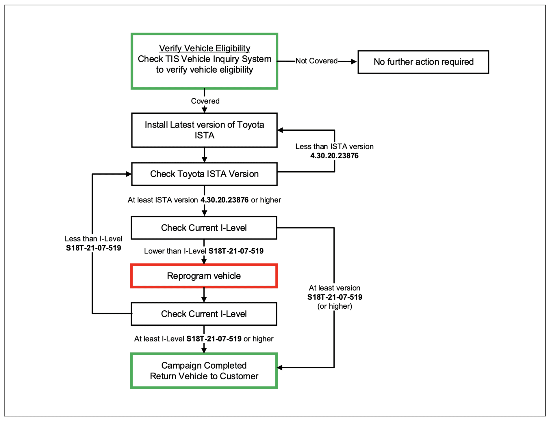

They're probably not just updating the ECU, but doing a full I-Level update across all the control modules. As I understand BMW, when a production code level is released it's a consolidated revision across all the modules. Even if the base code for a particular module hasn't actually changed, it's still versioned and flashed to match the I-Level release. More advanced/experienced technicians can update individual modules like the head unit only (RE: FS Apple CarPlay of late) or just the ECU, TCU or BCM but I suspect that people will find their BimmerCode changes, etc all wiped after getting this update indicating that more than just the ECU was flashed. But that's just speculation.
EDIT:
Based on the remedy notification, it appears that they are updating the entire I-Level to S18T-21-07-519

They're probably not just updating the ECU, but doing a full I-Level update across all the control modules. As I understand BMW, when a production code level is released it's a consolidated revision across all the modules. Even if the base code for a particular module hasn't actually changed, it's still versioned and flashed to match the I-Level release. More advanced/experienced technicians can update individual modules like the headhunt only (RE: FS Apple CarPlay of late) or just the ECU, TCU or BCM but I suspect that people will find their BimmerCode changes, etc all wiped after getting this update indicating that more than just the ECU was flashed. But that's just speculation.
EDIT:
Does this include fullscreen carplay?
