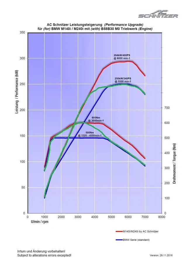

Even if the ZF8 shifts as quick as a DCT it would require a little more than 350hp at the flywheel. With a regular Auto transmission, it is almost impossible to get a 4.1s 0 - 60 with less than 400hp.
According to online calculators (which are unreliable at best) assuming the MKV weighs 3,397lbs it needs somewhere between 440-470hp at the flywheel to run a 4.1s 0-60 with an auto transmission. A DCT would require 370hp. We're missing 35-135hp somewhere to make this 0-60 time logical.
There is also launch control which would help significantly but not by that much IMO. It's either underrated power wise or using "overboost" to gain mid range power.
Here is a dyno chart by AC Schnitzer showing the stock B58 vs their tune:
https://preisliste.ac-schnitzer.de/...l=1er-F20/F21&Teile_Nr=1100230350&ID_NR=24318
My assumption is the supra applies more power in the mid range but keeps the top end the same (335hp) making the power curve something like this (green curves):
IMO this along with lunch control and decent tires/traction are enough to get a 4.1s 0-60 times in a 335/3,397 power to weight ratio chassis.
This is of course all my speculations, non of it has any true bases other than the disbelief that the specs we were given are somewhat illogical to produce these times. Not to mention why don't we always get this "overboost" in all RPM ranges. Maybe it's for reliability, better traction/handling in corners to prevent loss of control, or maybe just politics to keep the MKV from undermining the Z4 :dunno:

Power, horse power in this case, is a measurement of work being done. Your torque curve, is your vehicles acceleration curve (till higher speeds where drag becomes a bigger factor). Ignore the HP figures and look at the torque curves to get an idea of how a car will accelerate. And that stock torque curve in that dyno chart above can't be trusted. That's impossibly flat.

A 3 second 0 - 60 is actually very possibly with the Alfa's power to weight numbers. Using the same websites I did earlier you get 3.9-4.0 with a "regular" auto and 3.7s with a DCT.

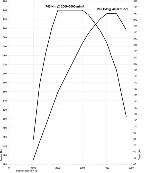

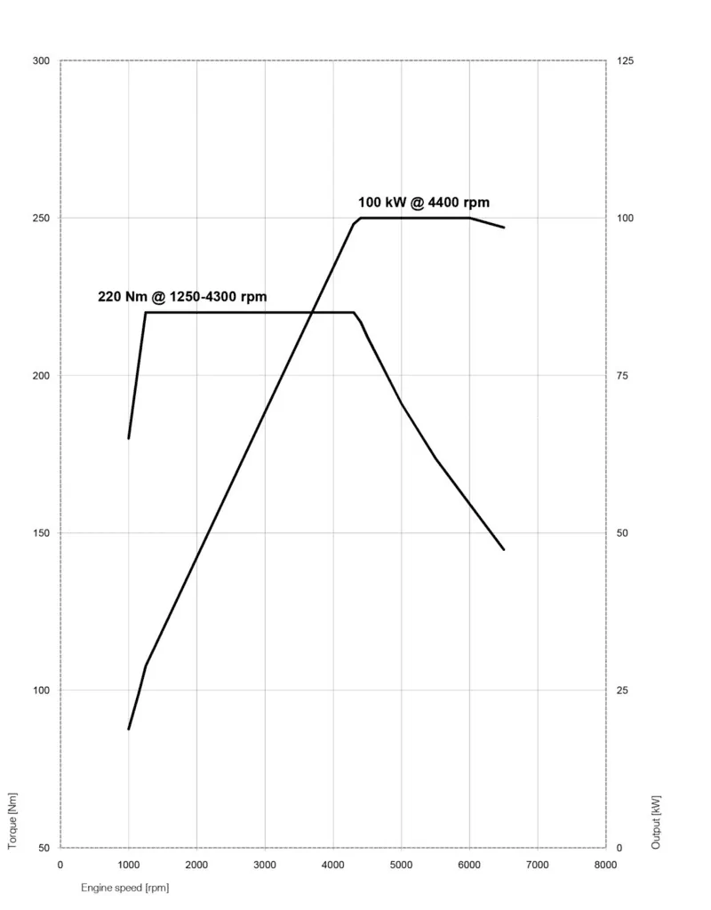

That flat plateau is exactly my point. I have noticed it in multiple BMW sourced engine dynos and they're definitely showing the engine being restricted to produce the numbers they claim even though once the same car is on an actual chassis dyno, this flat area is gone and the car is actually making more power than advertised.
Here are a few other examples:
https://www.greencarcongress.com/2014/02/20140214-bmw.html
https://f10.5post.com/forums/showthread.php?t=640422
The base numbers on the dyno chart I got from AC Schnitzer are most likely BMW sourced as they show identical numbers to what BMW claims. It is almost impossible to produce such exact numbers on the same dyno twice let alone on a different one.
