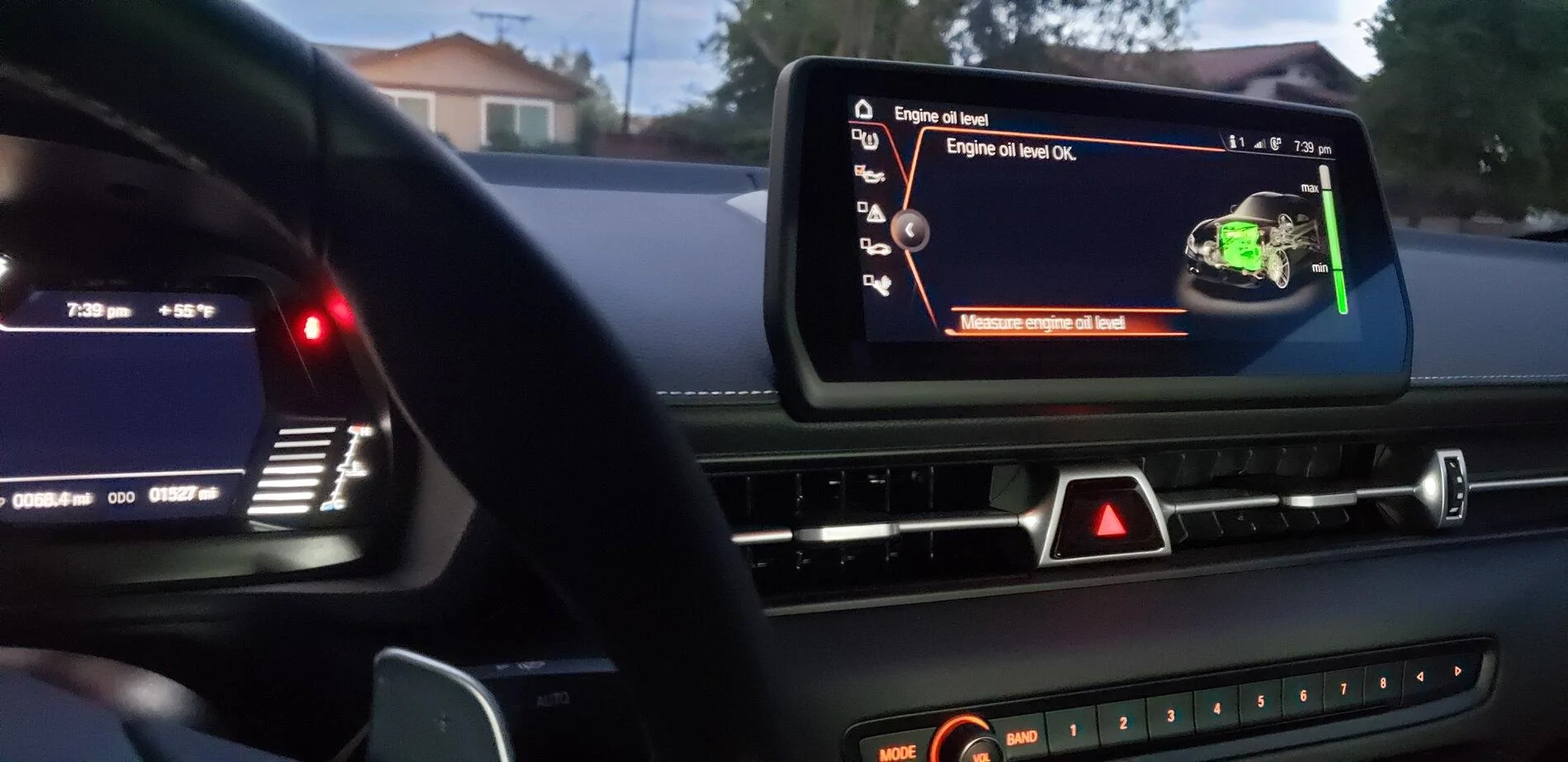

I check mine today it showed at the mid point between min and max with 1,535 miles. I found other past post showing this

Officially got my second low oil warning tonight...
Less than 700 miles between quarts...
Anyone saying this is normal don't know what they're talking about...
Really gotta find time to get to the dealer?
Steve
So I drove my car today about 20 mins...when I got home i check the oil level...
Now it says I'm 3/4 to the full mark...
I have not added any oil since i got the low oil warning roughly 25 miles ago....
WTH...faulty sender?
Really strange...

I think there is a little error margin on that oil level sensor. Also do you check the oil in the same parking spot every time?
-RJM
freeform911
Steve
Nov 21, 2020
906
872
Beaufort South Carolina
Yes checked at the foot of my driveway.. level ground each time...
I'm sure there's a margin but 3/4 of a qt seems like a big margin?
I'll see what Toyota has to say on Thursday...

I checked my oil at around 3,800kms -Full, then at 4,300kms -down 1/4 quart, 4,850kms-down 1/2 quart. The oil indicator bounced between around a few times. Sometimes it would show 1/4 low, and the next day 1/2 low. I found that the oil level would be higher if I left the car idling for about 5-10 minutes. (After I got back from a 30+ minute drive) If I was driving it, and immediately checked the oil without letting it idle for 5-10 minutes, the oil level was always lower. Seems weird. Maybe some of the oil settles down in the bottom of the pan when the car is resting for a few minutes. Any input from you owners? Thanks.
