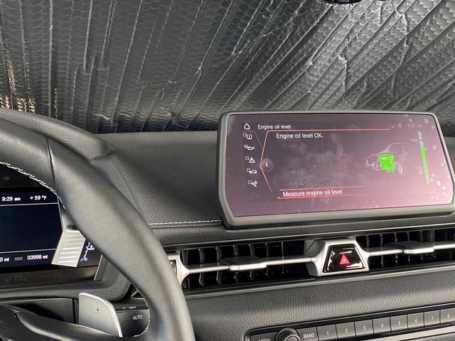

FYI - Thought I was in the clear. I check my oil levels 1-2 times a week. Sunday I was at the full oil indicator. Checked the oil today and was about a .25 liters low. Changed the oil at 1200 miles and am now at 3998. So in 2798 miles I burned about .25 liters. I'm a little worried but my oil consumption doesn't seem too bad. I'll keep monitoring the levels.

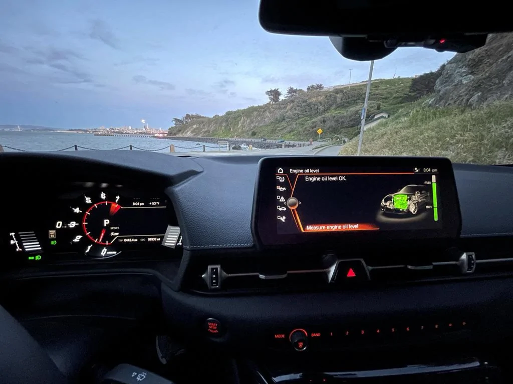

Just about 2,000 miles.
About 6 launches, lots of high revving for the pops n bangs, 42 complete laps of Laguna Seca (top speed of 125mph), and oil has been reading full (been checking every couple hundred miles).
Date on the door sill says 12/20.
2021 GR 3.0 Premium
You got a late model 2021 so your engine probably got good piston rings and rod bearings. Your probably good to go! Congrats!
