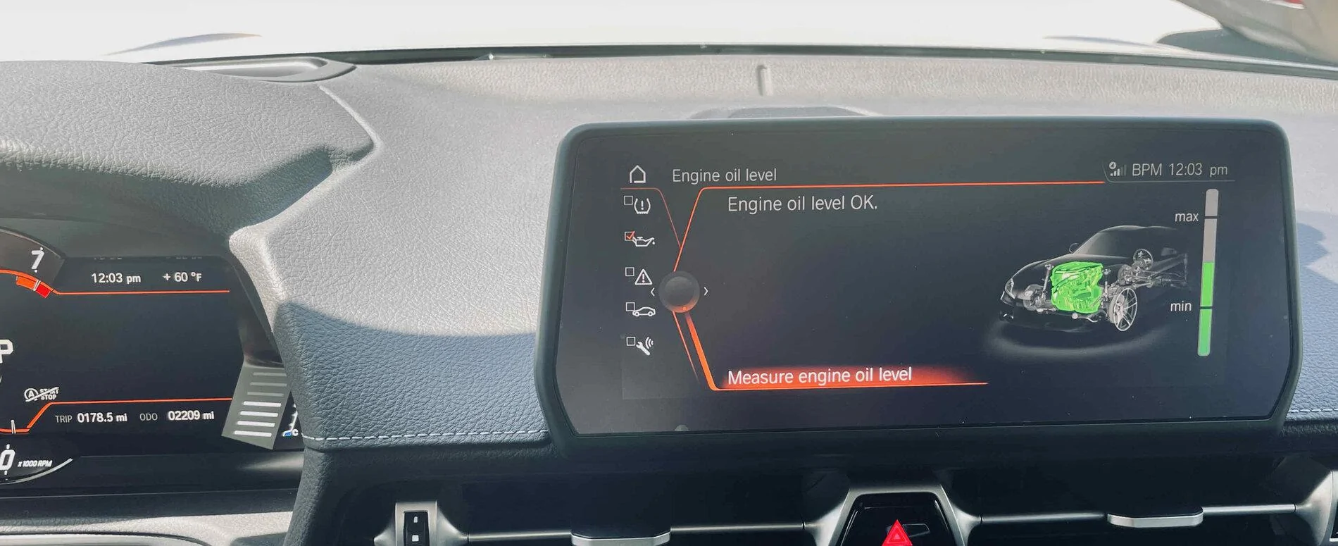

Just about 2,000 miles.
About 6 launches, lots of high revving for the pops n bangs, 42 complete laps of Laguna Seca (top speed of 125mph), and oil has been reading full (been checking every couple hundred miles).
Date on the door sill says 12/20.
2021 GR 3.0 Premium
Replying to my own post as a follow up.
2,200 miles now, ran the test a few times, different areas, inclines, etc.
Half-way mark from Max after 250 miles.
