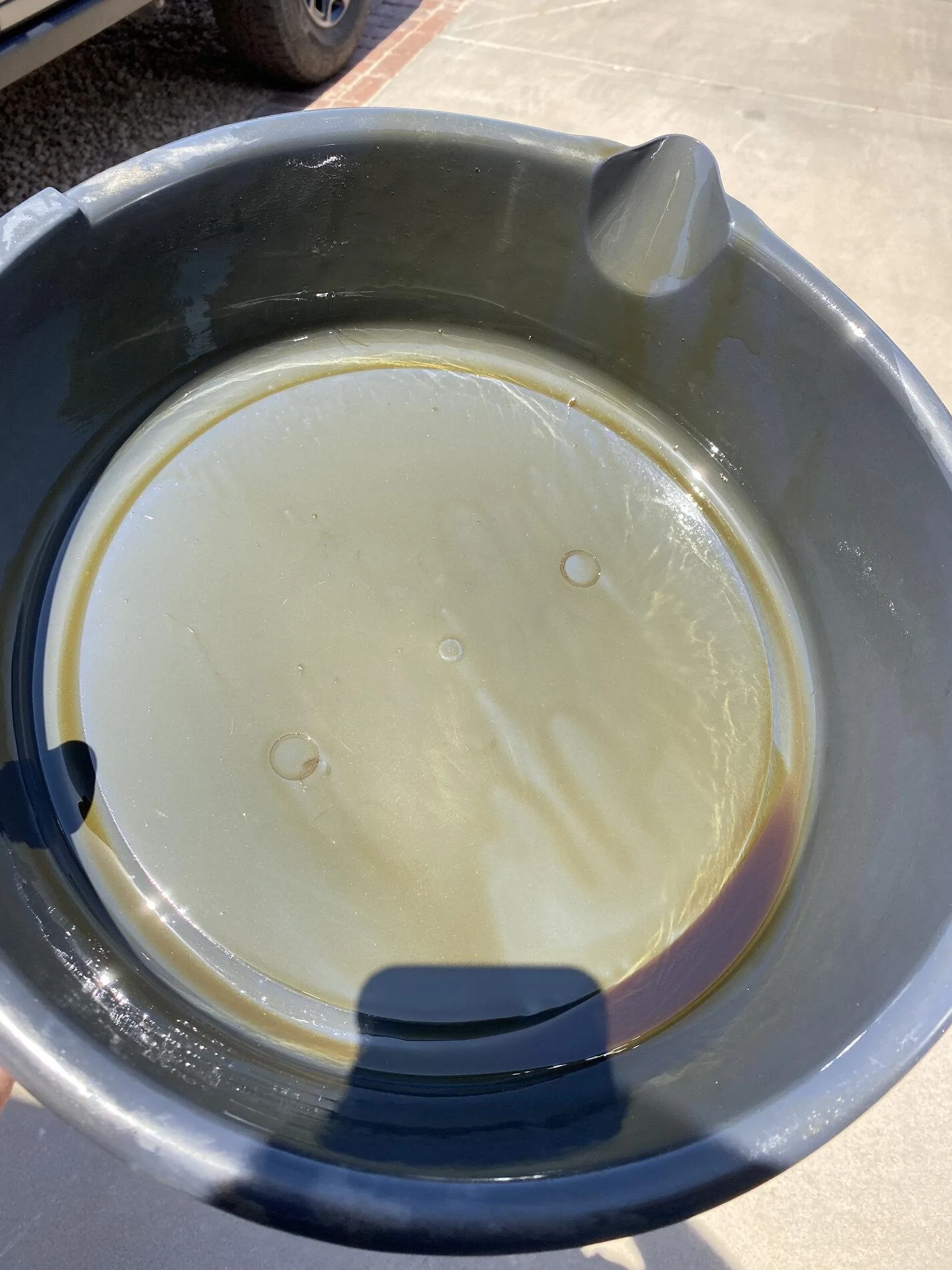

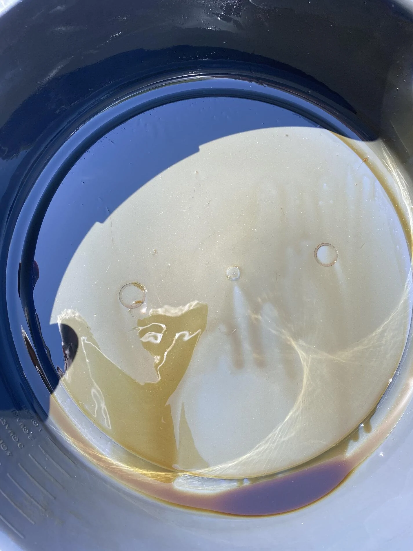

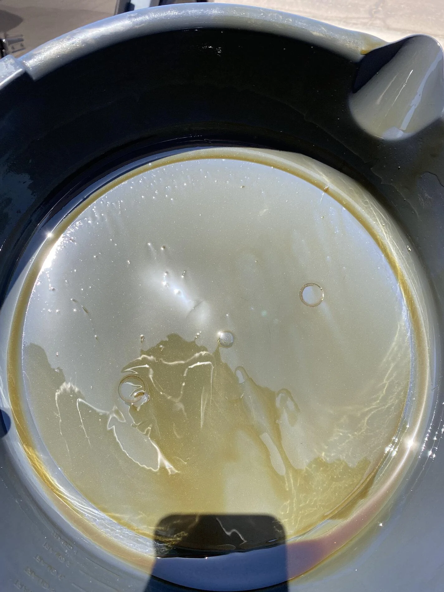

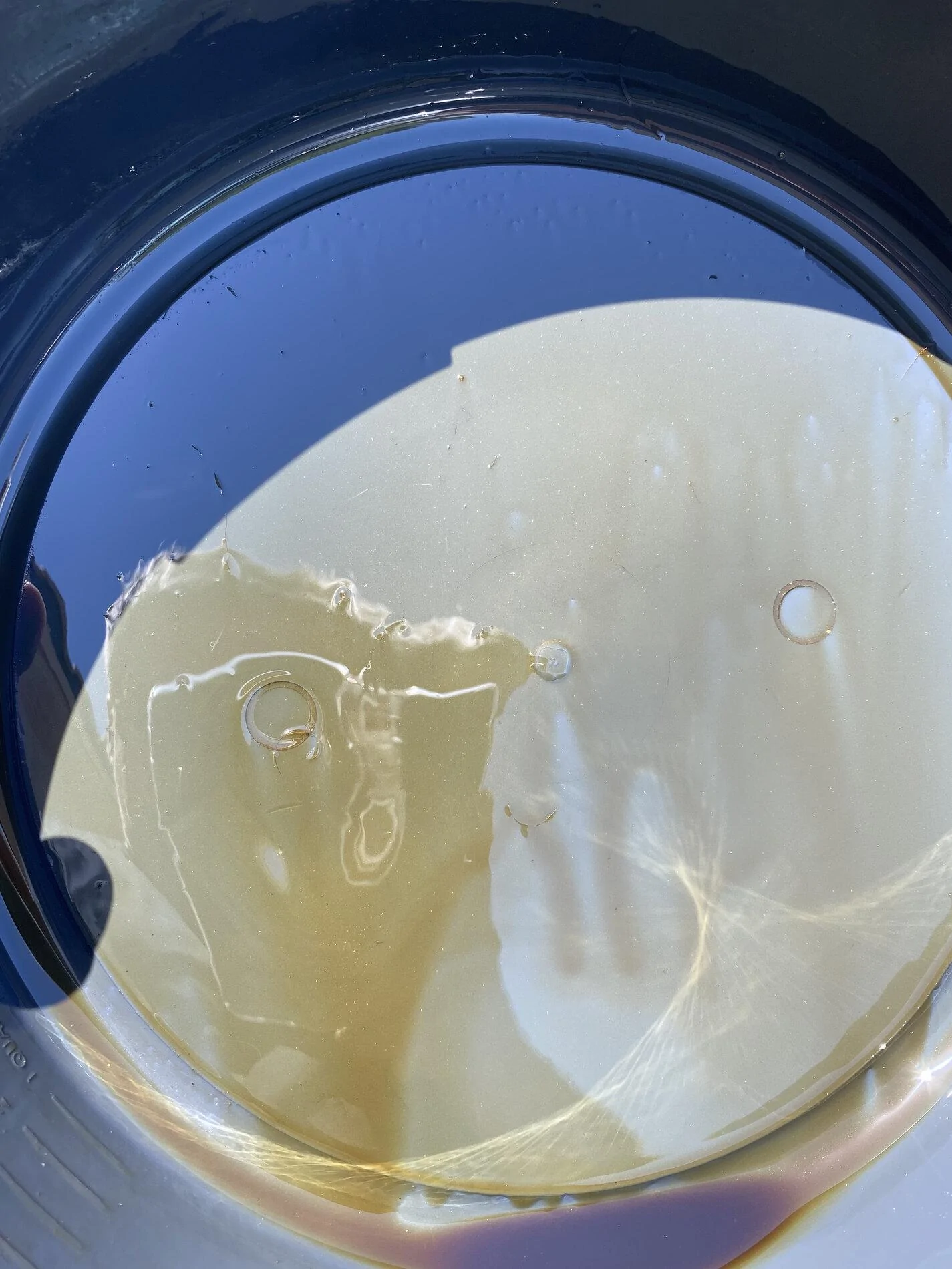

Break in oil change. Checked full the entire time - no issues. Replaced delivery oil with Liquid Moly. At the advice of my car guy neighbor - let the oil drained in pan sit overnight to settle and then carefully drained it to check the metal remaining in bottom. Also sending in a sample to Blackstone. No overt chunks seen. Definitely some small sparkles. Car was not tracked but alternated between sport and normal mode and run a bit from time to time.

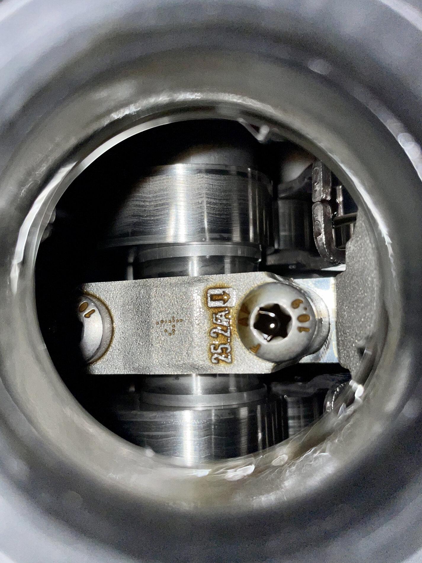

Since there seems to be a good number of you who have had to add your own oil or have done your own oil changes, have you looked down the oil filler opening? I decided to look at mine and I'm used to cars where there's really nothing to see. Do all of yours look like this too?

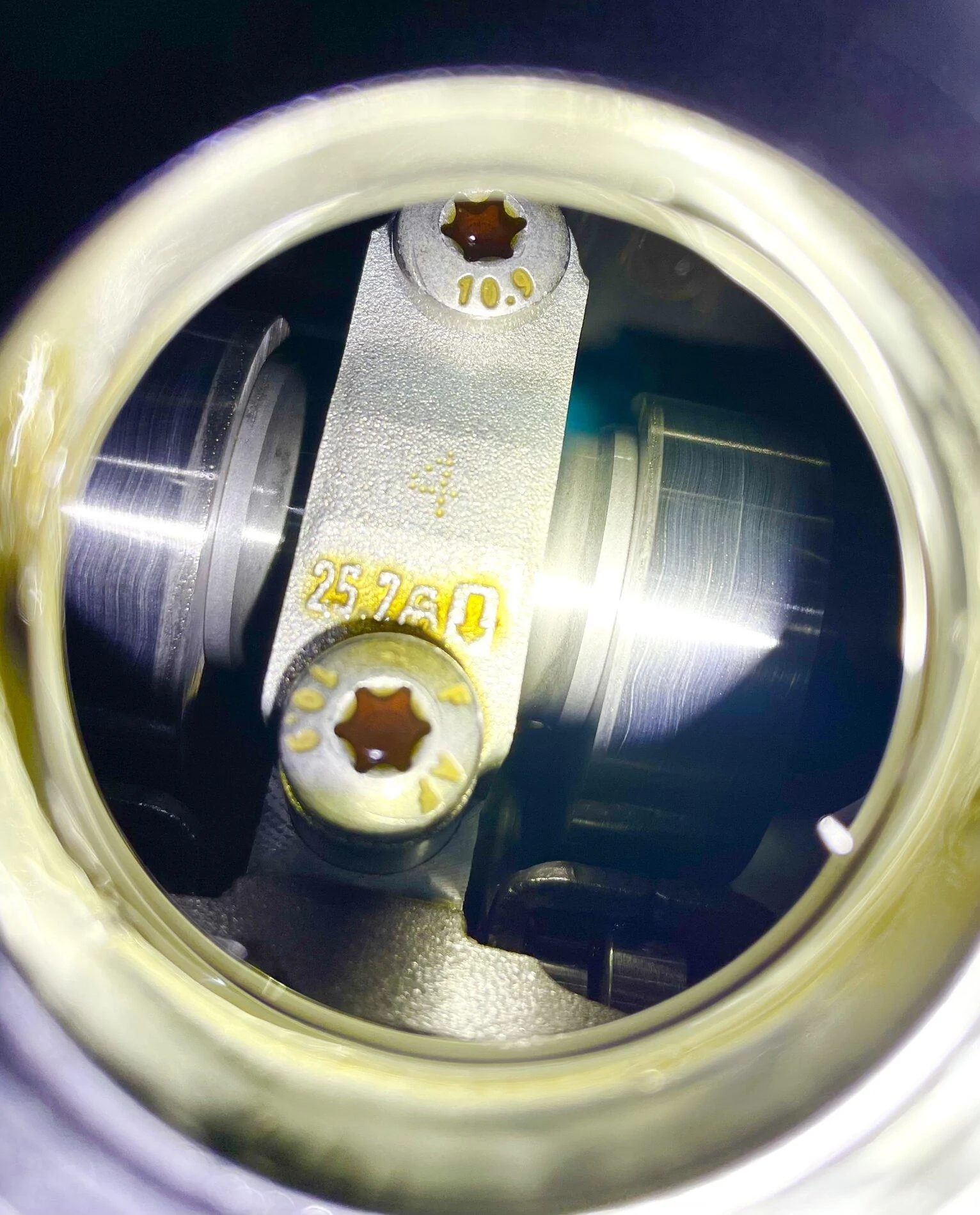

I think I see some marring on one of your piston cylinders. You most own a 2021 right? ?
All jokes aside, curiosity got the best of me. I went and snapped a pic of mine, for the sake of science of course. ?
