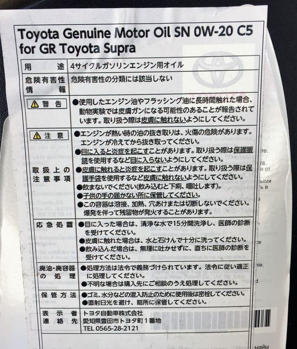

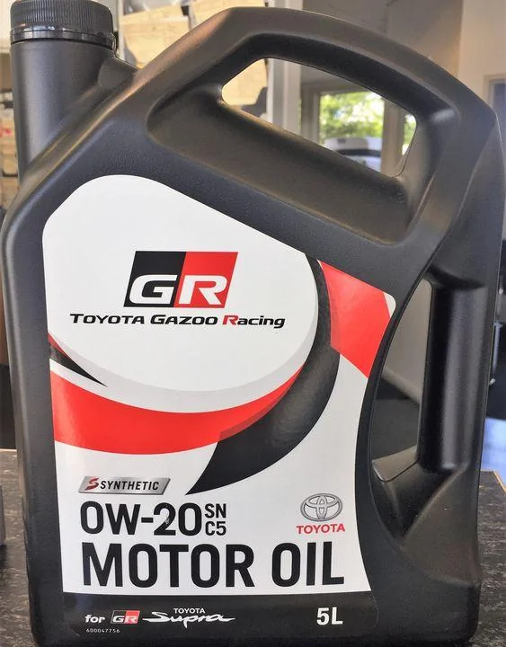

I organised some oil with my local dealership for my first oil & filter change, at my cost
I have 3000kms on it now & going to do another 10-1200 this weekend going to a benchrest competition.
After checking the details with them (thanks to this thread) I figured I might as well go with the oil they will use with my scheduled services
It turned up today, here it is :)
Obliviously someone had their stuff together & got the 5 litre packs in direct from Japan
Goodness knows what its going to cost me :rolleyes:
does it indicate who makes the oil for them?

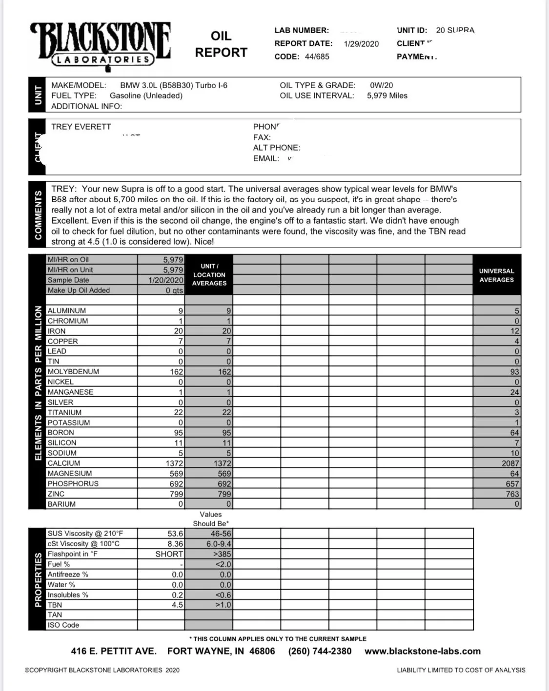

First black stone report on Supra. Switched to Amsoil Signature 0w-20 for second oil change will see if anything changes. Mods for most of its life are catless DP, Stg 2 tune.
