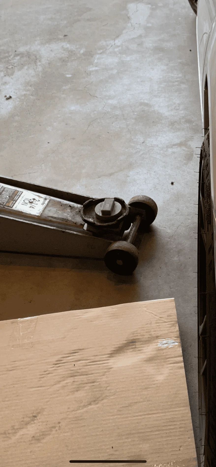

Silly question, for those who have changed their oil, what jack points did you use? Did you need a special puck for the jack?
If you aren’t using ramps, than yes I would use the pucks. Should be able to get them from any aftermarket bmw shop (pelican parts, ECS Tuning, heck maybe even Amazon.
If you are really ambitious and have and old hockey puck, you can make one.
I added wheel spacers this weekend, you can see my puck...

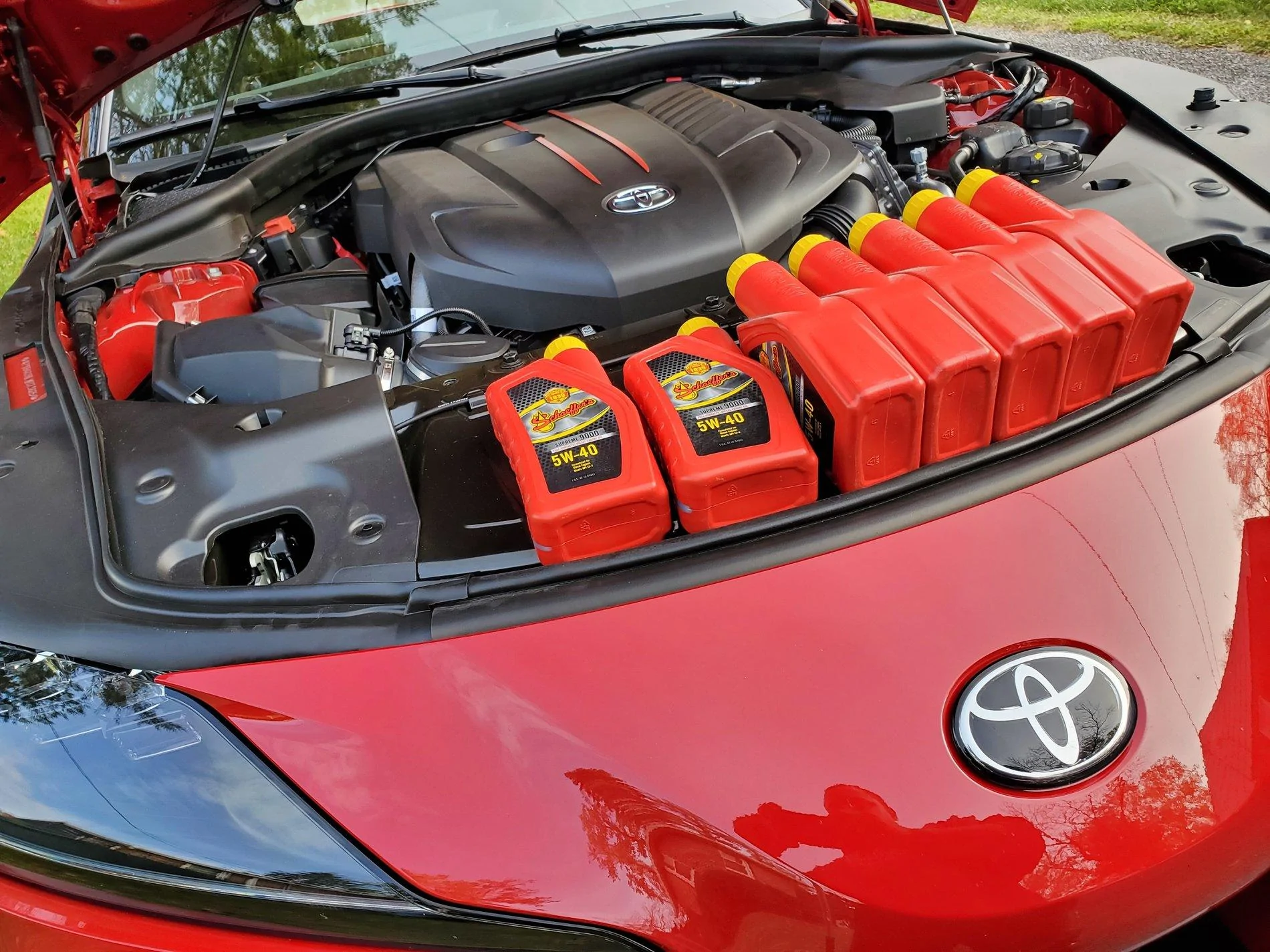

Did ours at 1500 miles. And used Schaeffer's Supreme 9000 5w40 as with all our vehicles.
