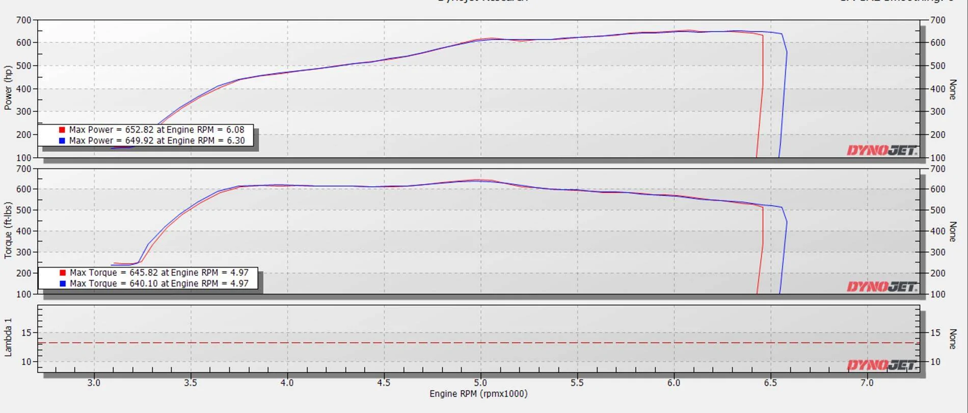

Here is a Supra I just tuned at a mile high, this would probably be around 590-600whp at sea level.
100% OEM fuel system with E35, intake, pure800, catted DP.

As reliable as you make it. If you beat on your car every single day you have more chances to break something.
I ran my Supra at approx 600whp for 20 events last season with no issues.
That car I showed the dyno above is making 550whp uncorrected but a reminder it is at mile high altitude. Which is why I stated it would probably make around 590-600whp at sea level.
