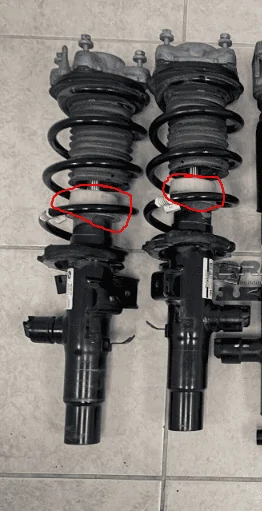

I picked up a set of MCS 2WR suspension from a someone local to me and was hoping someone here could send me a picture of a fully built front shock. Ideally both uninstalled and installed. Or if I can get some guidance on what all from the OEM shock I need to move over such as this white plastic piece, the dust boots, and bump stop.
Somewhat related, I'm also changing the steering knuckle so if anyone has torque specs for all of the bolts in the related area, and the top hats for the suspension I'd be grateful.

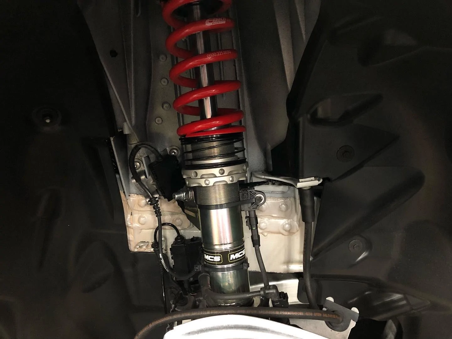

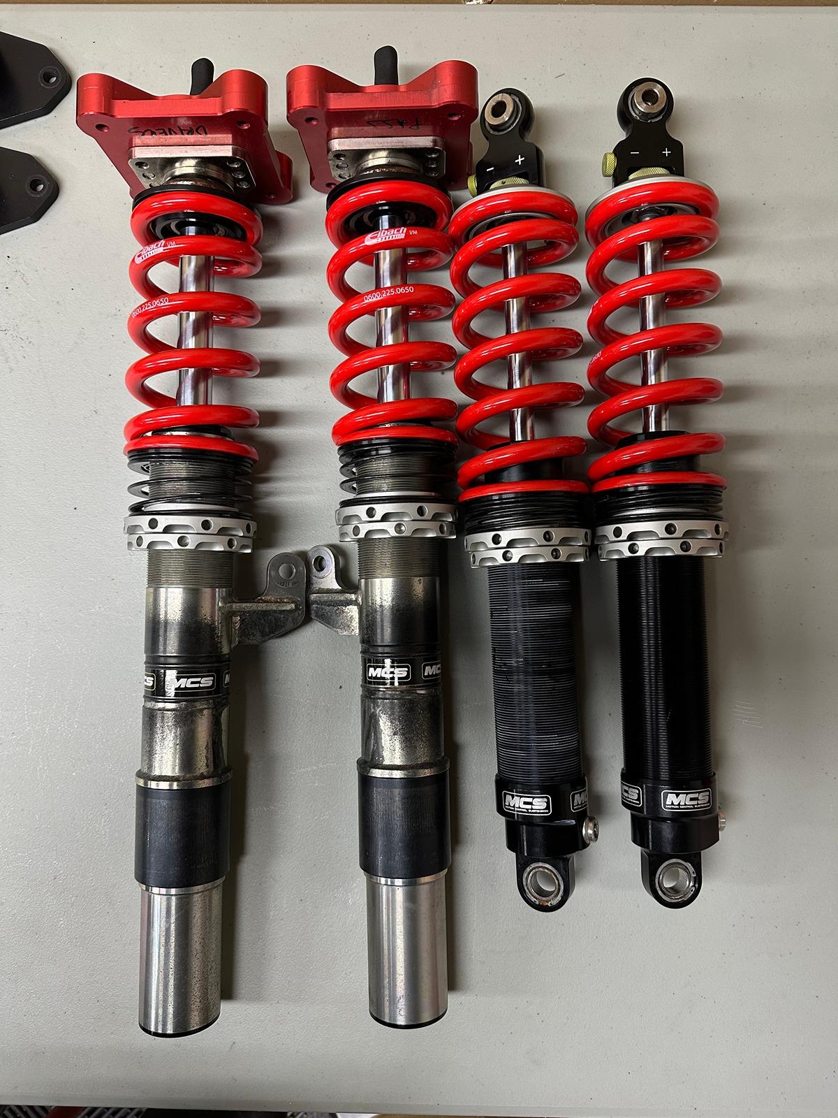

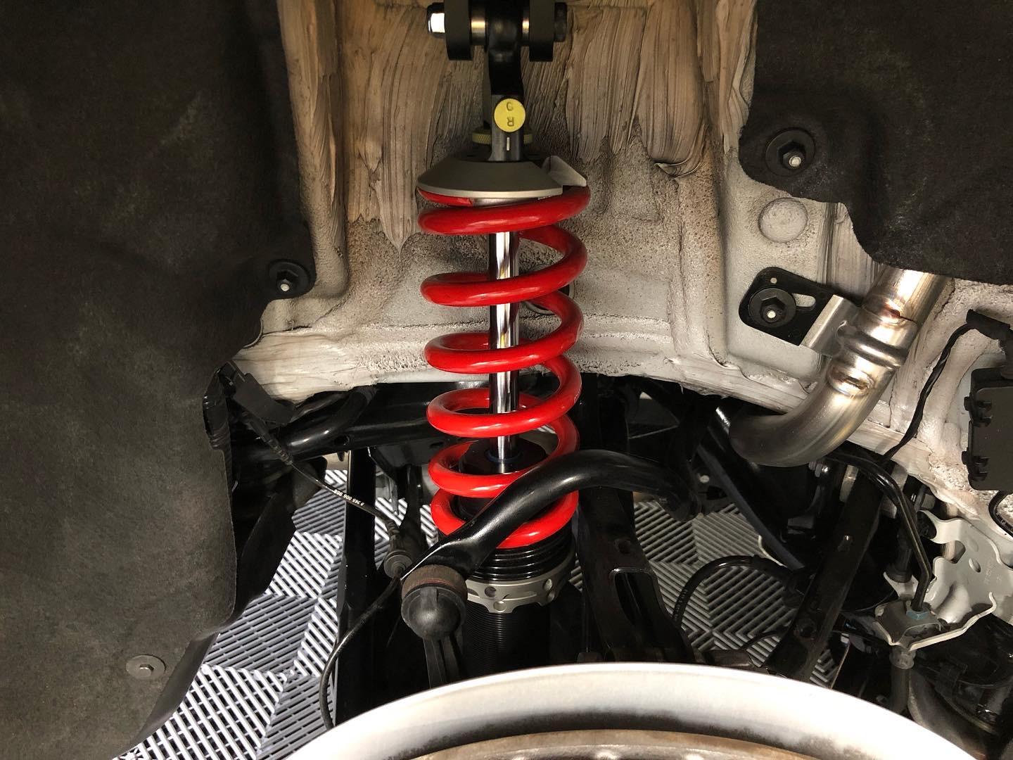

You don't use anything from the OEM shocks.
Here are my MCS 2WNR:

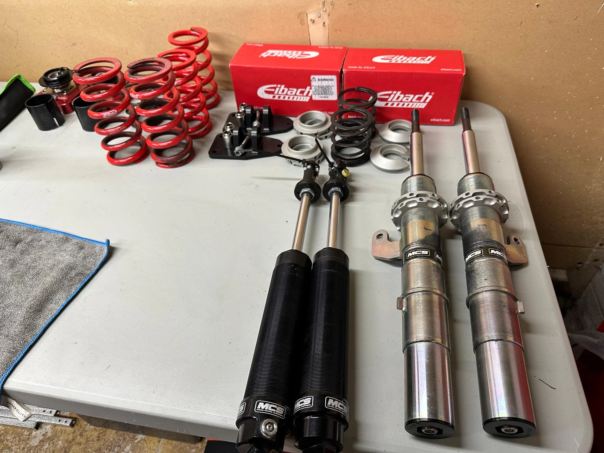

are you trying to build a B Street legal shock? pictures of the MCS would help.
Traxion
Oct 6, 2021
498
821
Southeast, USA
2022 Toyota Supra 3.0 Premium
I'll upload some pics when I get home. Yes they're Tolleson's MCS he was selling so I should be able to get them fully legal but I don't care too much about being nationally legal, just close enough that my local competitors won't care but I reap the benefit of better suspension for the track.
