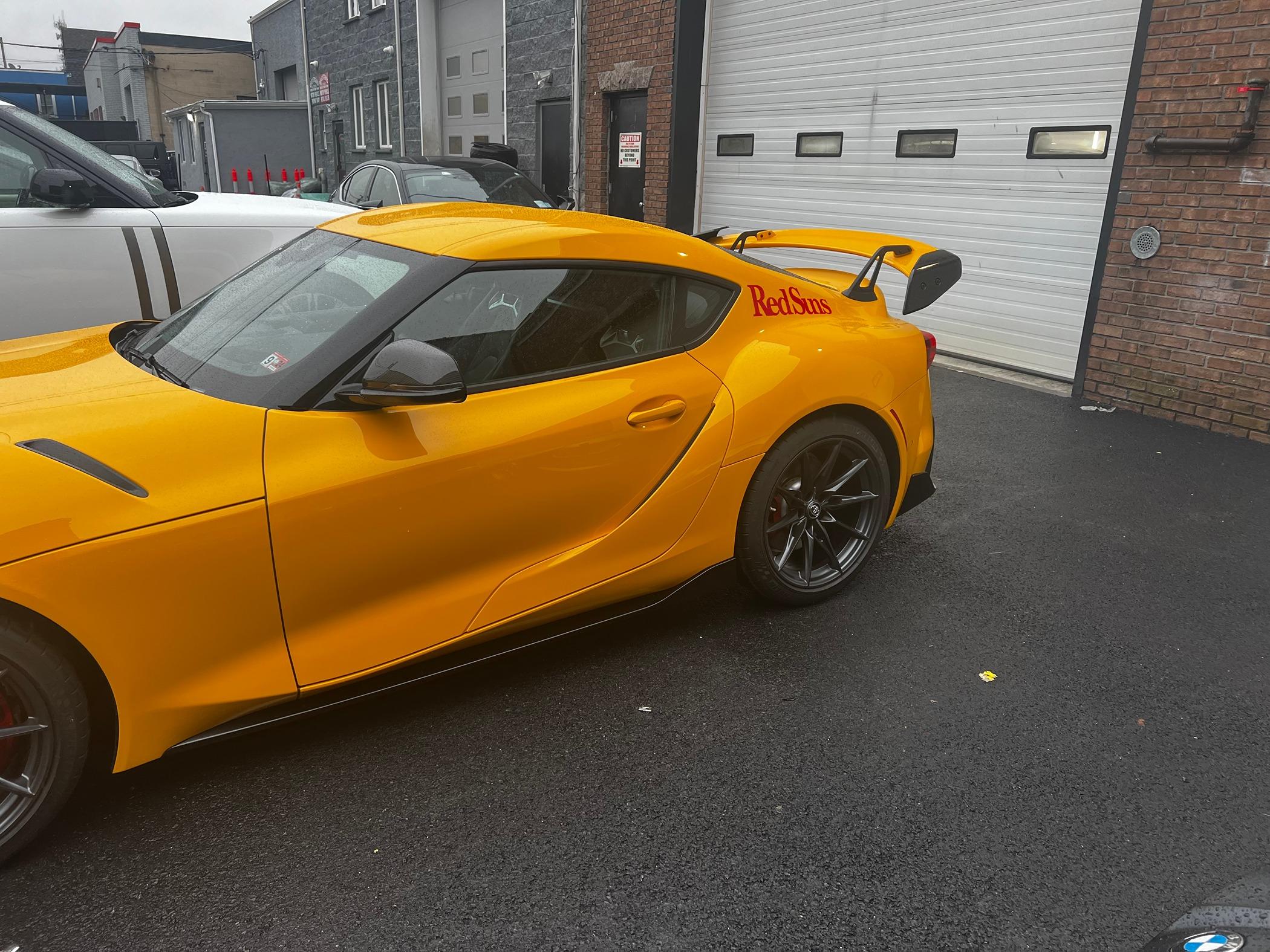

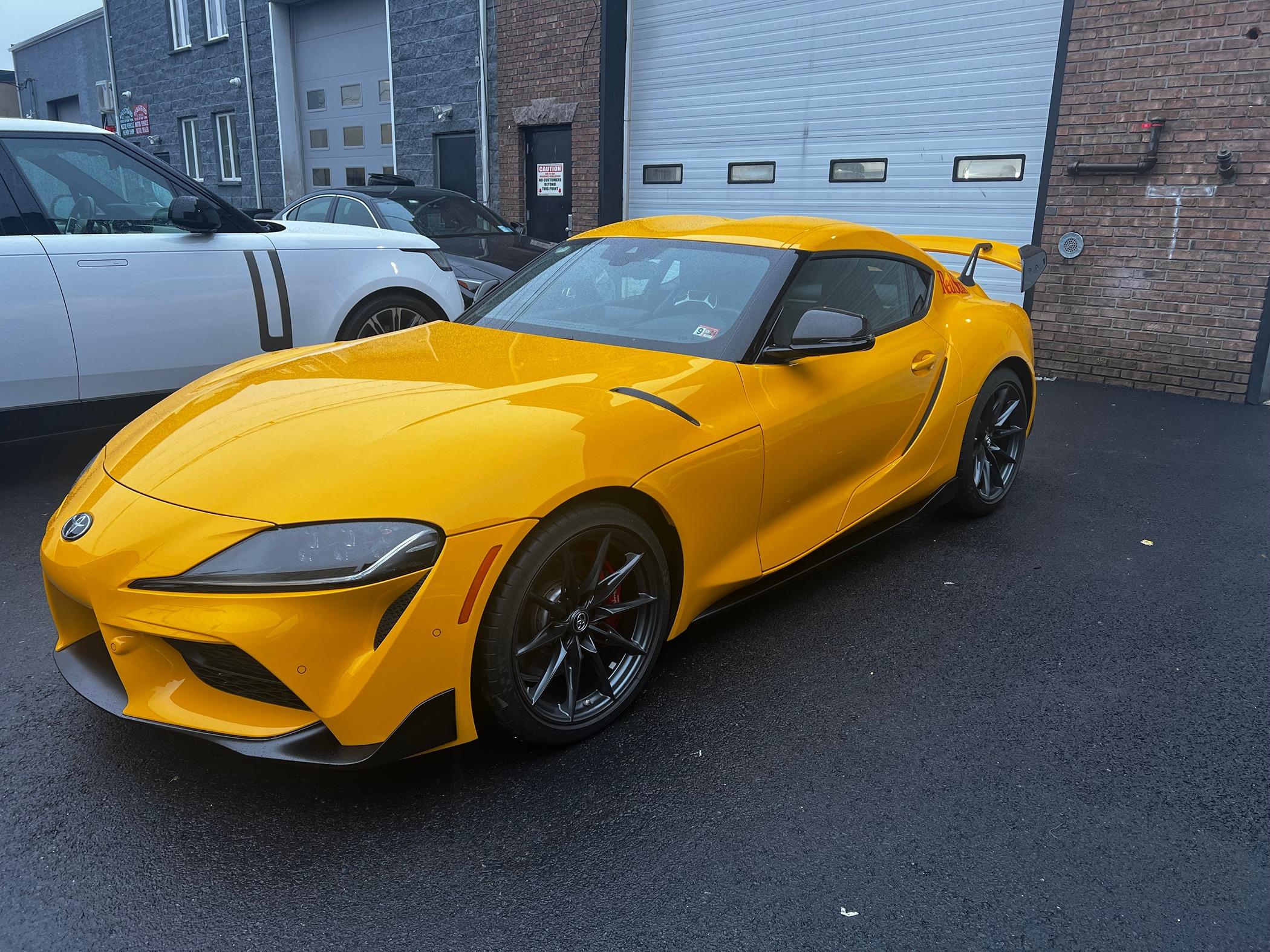

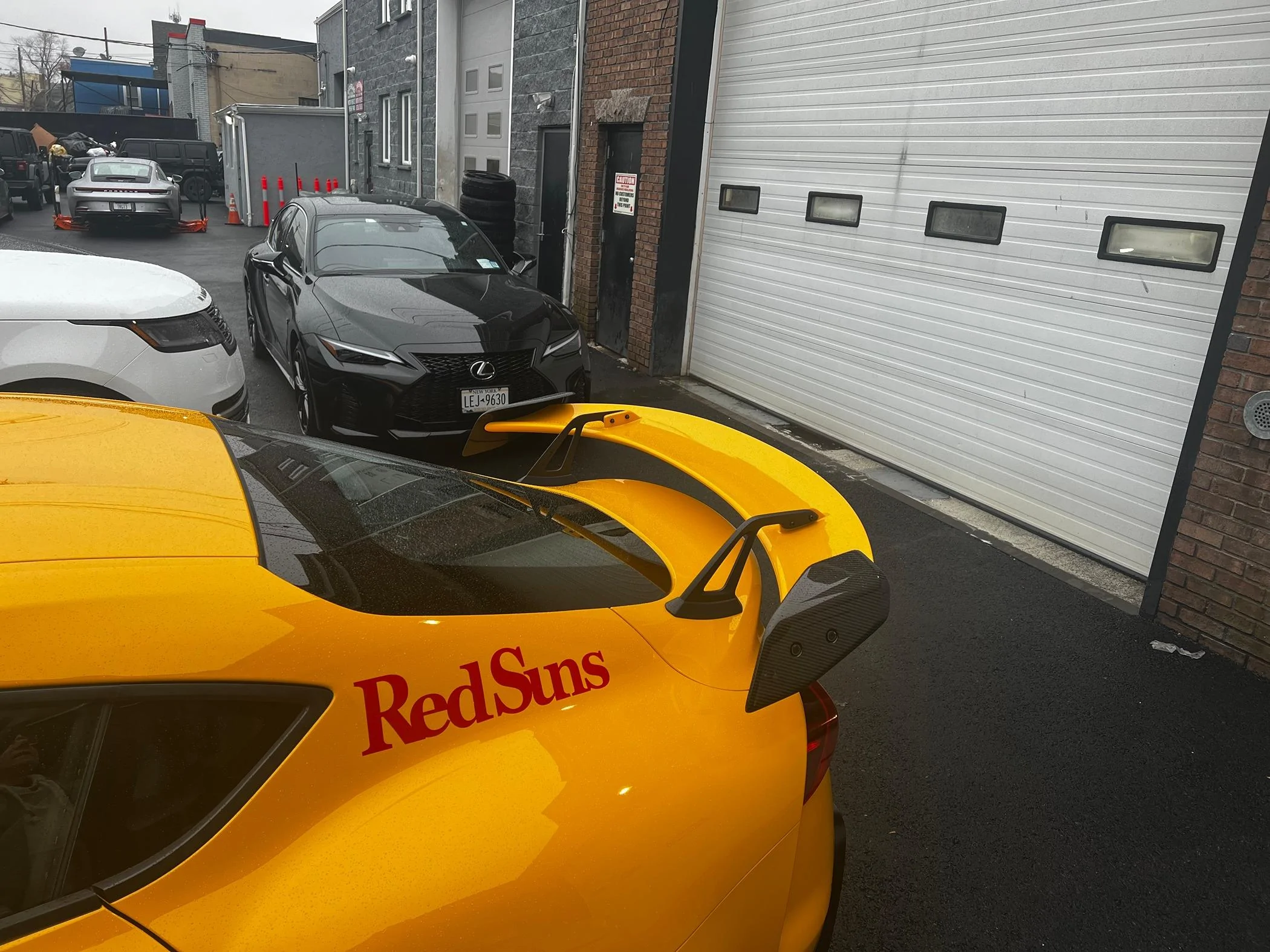

So, I added an Adro wing to my A90 and got it colour matched except the winglets.
Next step, take it to a cars and coffee, as I leave turn off traction control and make sure tires are nice and cold and floor it on a curved entrance to a freeway and see if this baby can fly!!!!
Seriously, I pray that I do not become "that guy" on TikTok...

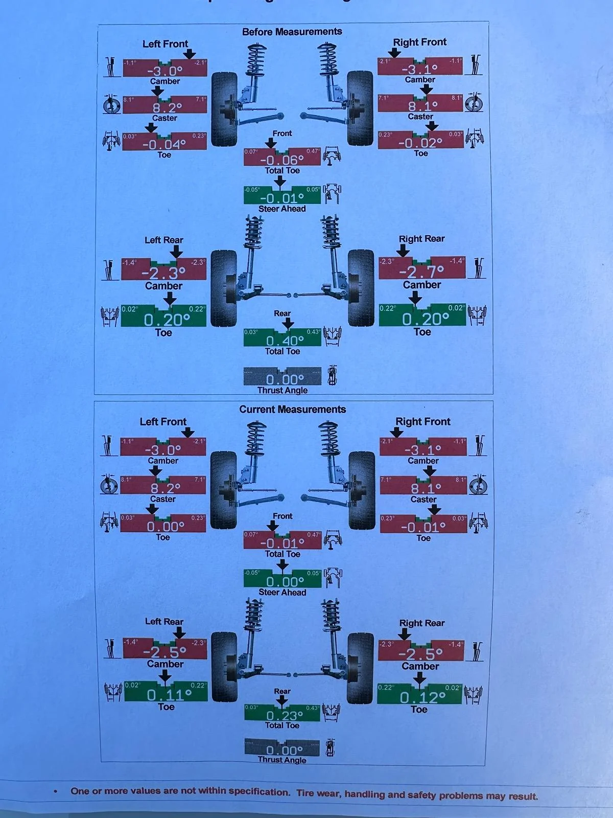

Hey guys, yes I flipped thru the 200 alignment specs sheets posted on here, but it’s so far in the weeds I can’t keep it straight. Gearing up for my first HPDE and need to get a rough alignment done. Sitting on HKS hipermax R coilovers (with camber plates), 12/15mm spacers, stock everywhere else. Any down and dirty recommendations on a good “beginner” spec to use as a base to build upon? Heading into alignment shop tomorrow. Thank you in advance.

Front
Camber: -3.0 to -3.5
Toe: 0
Rear
Camber: -2.0 to -2.4
.2 to .4 total rear toe-in
The rear toe in being the most important as it will keep the car stable and not snappy over steery.

They called me in early due to a cancellation. Here is where I ended up. Appreciate the info and any feedback you may have Razor.

I would have done more negative camber in front but you can grow into that. I would have also put more toe-in in the rear but again, if this is your first HPDE, that alignment will be just fine.
Do you daily the car? What tire?
Stock tire and wheel setup. Car is just a weekend toy at most. Spirited drive out to the hill country if time allows.
Hoping to get some seat time on some tracks around Texas, then hit COTA.

Should be a good alignment as you learn the car on track!

Front
Toe: 0
Rear
100% agree
Im running 1.5mm toe in on rear and am happy with the rear end performance but i can see how 2mm would be better ill try it next time i get an alignment.
i will say going from 1mm to 1.5mm made a massive difference so much so my alignment bloke didn't believe me until until i threw him teh keys and got him to try out both settings.
