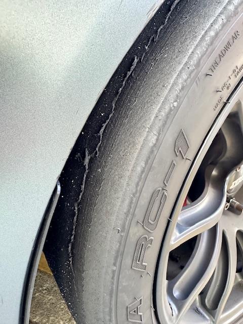

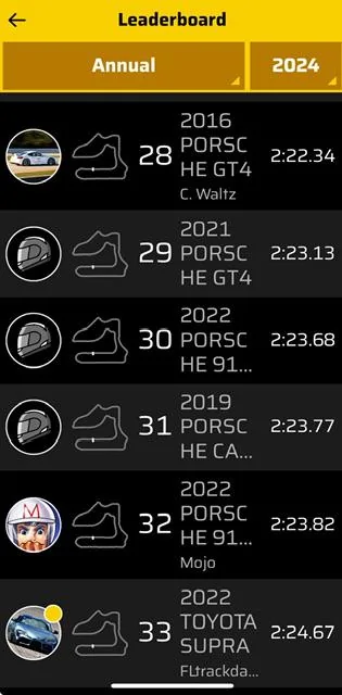

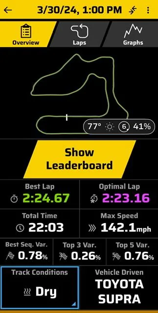

Another PB at Sebring. No new mods. 2:23s next target time ? - proper seats soon - mega sore bracing myself all weekend ?
Changed the pads out day 2. Had to scrub off too much speed on the front tires. Poor girl. It was my last track weekend for a while. So I pushed the ? out of her

As far as the brakes, one of the ducts came off. Braking wasn’t as strong as usual. Hence my tires paid the price, scrubbing off more speed when missing the apex’s. Will have to get that fixed and try those magical CSG pads someday. That could make a big difference in times ?

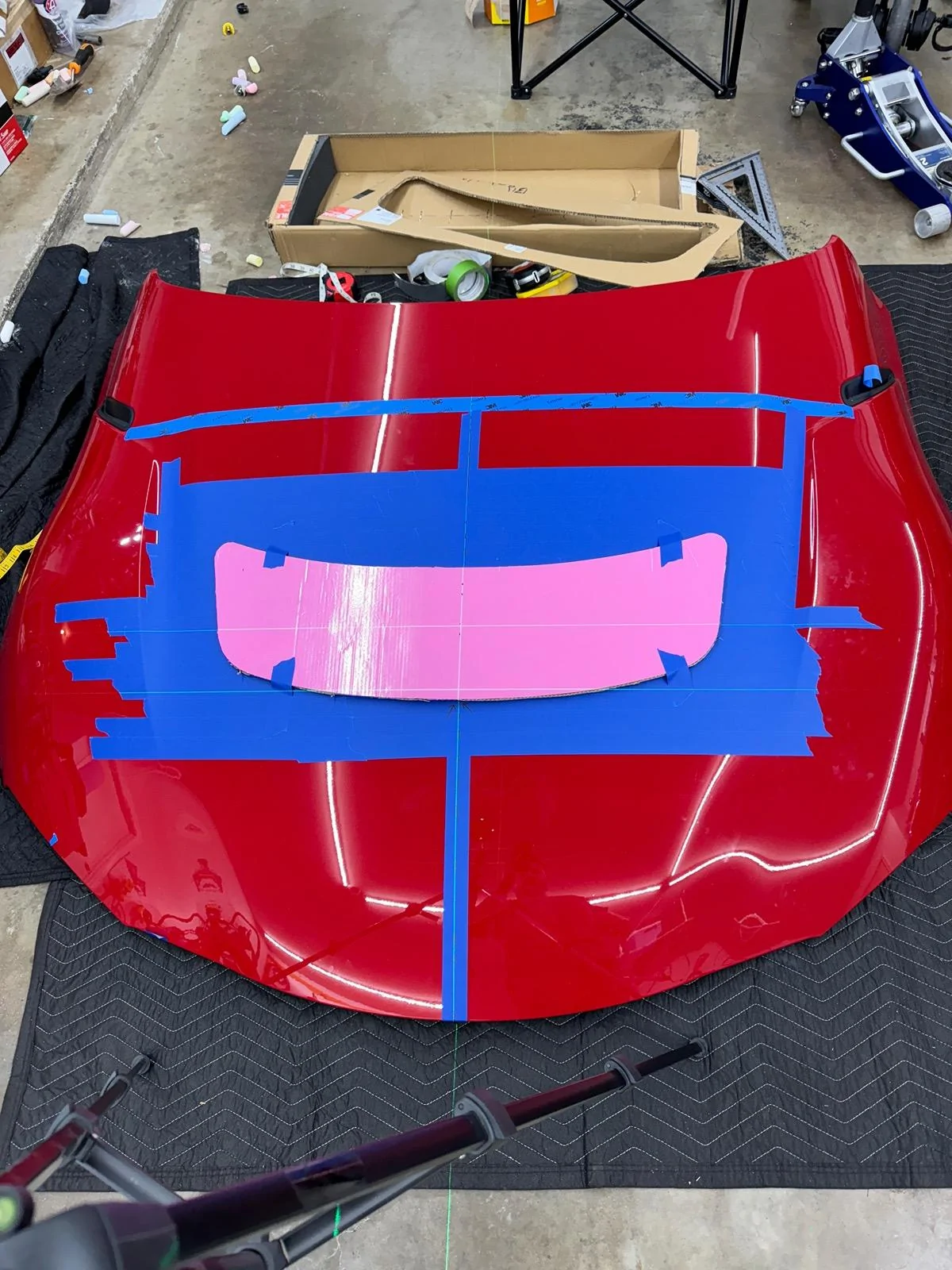

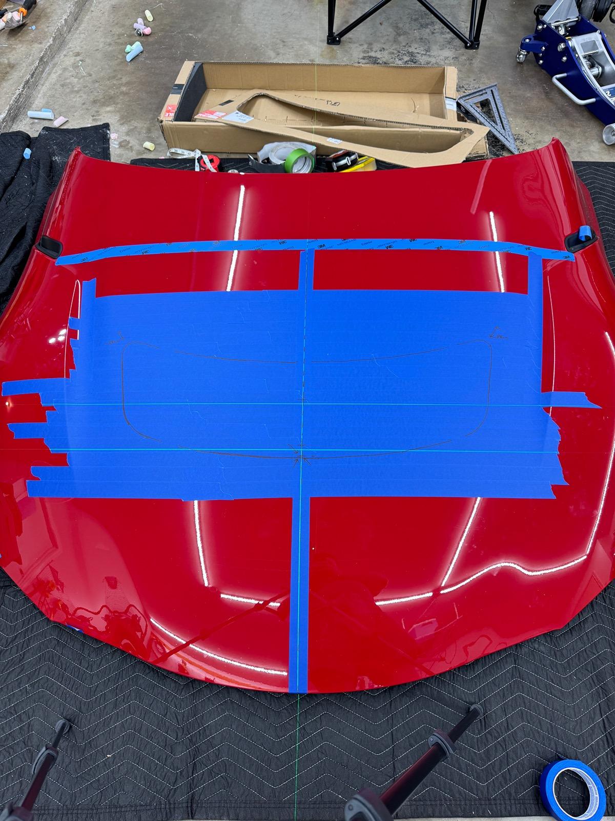

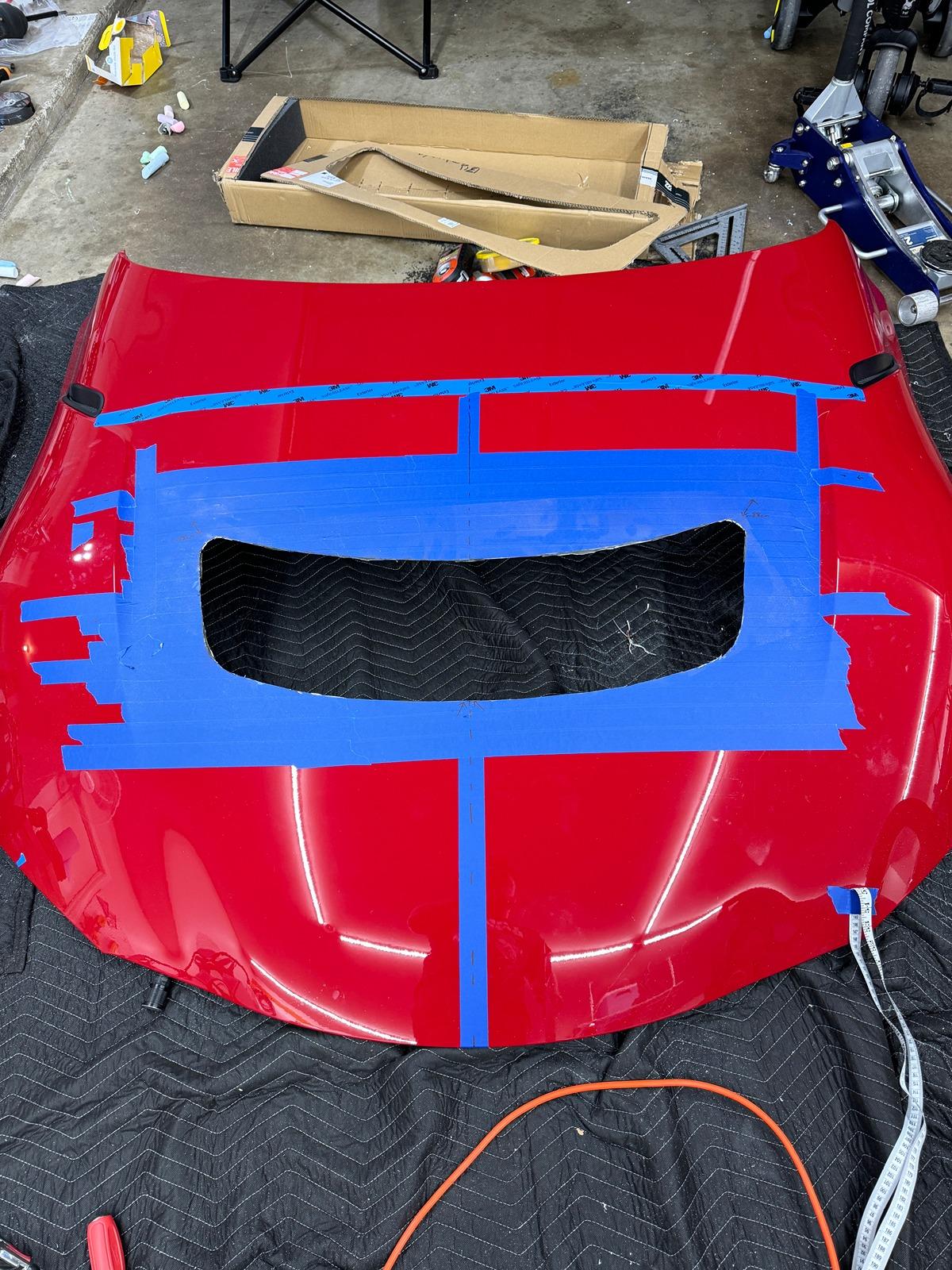

Been doing lots of measuring! Ripped off first sketch and this one is much better. 18.5” from the tip of the hood is the bottom cut line based on the GT4, so I’m told. All measurements are checking out but I’m going to sleep on it and measure again before cutting. I feel a lot better about it than the first sketch ?

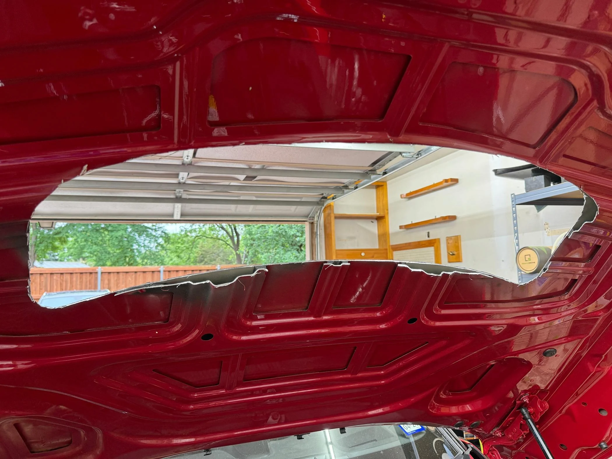

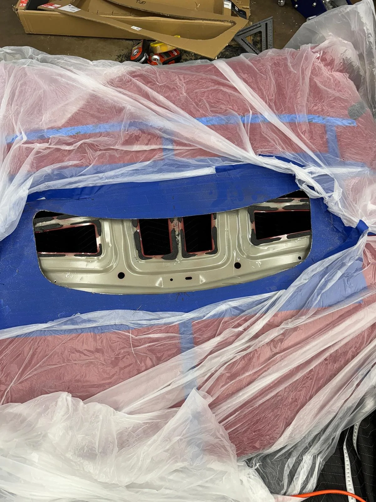

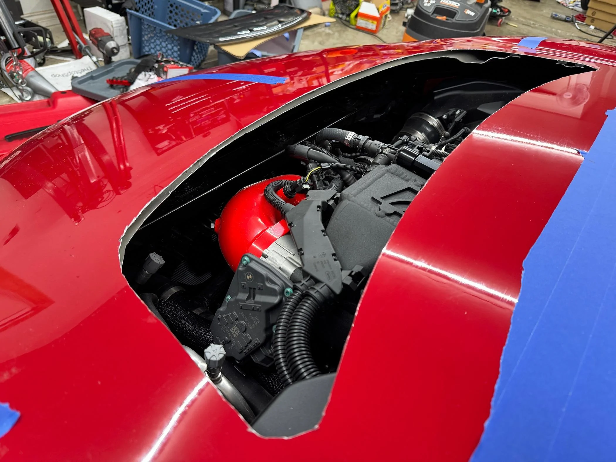

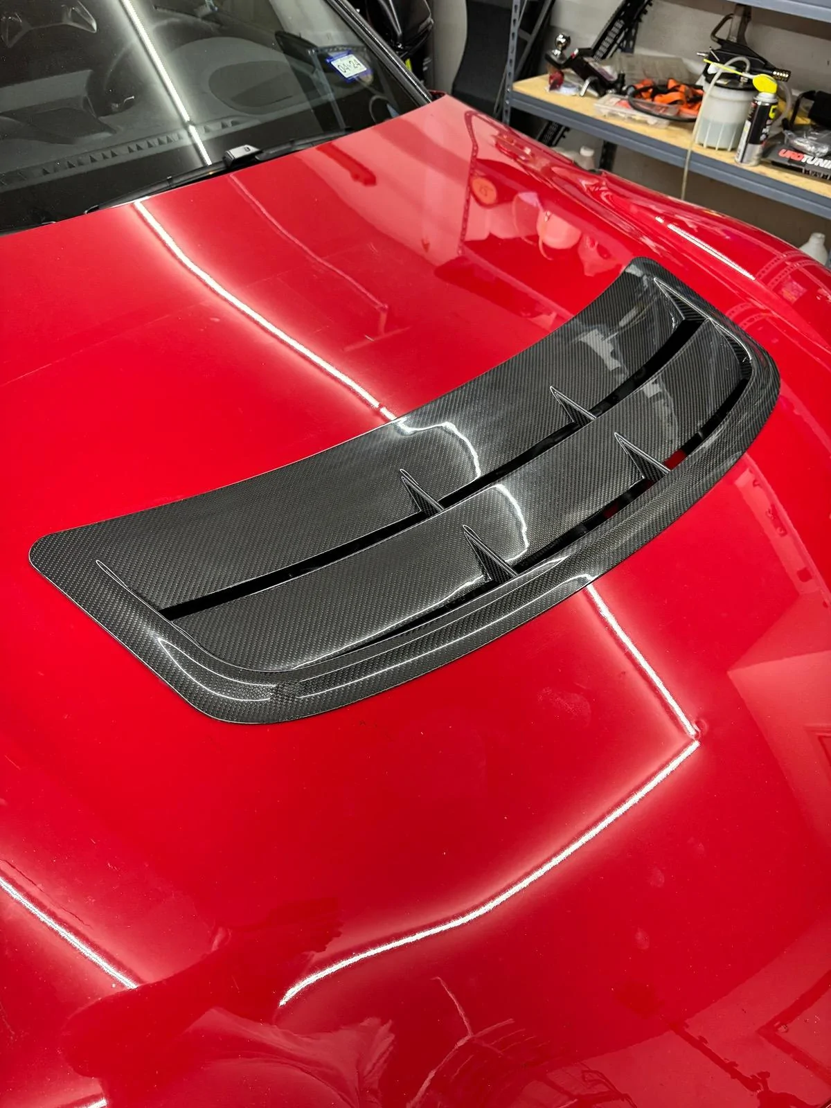

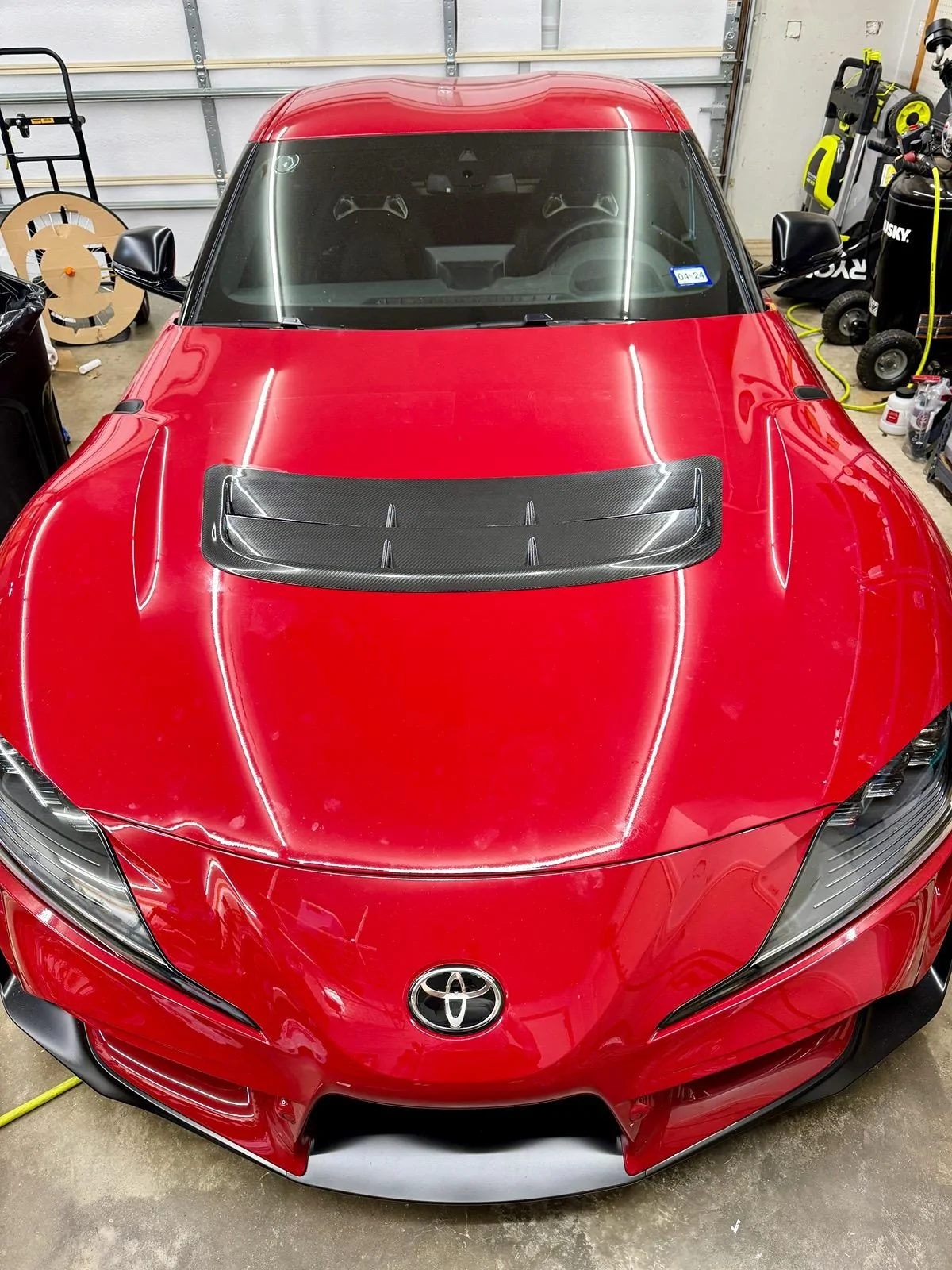

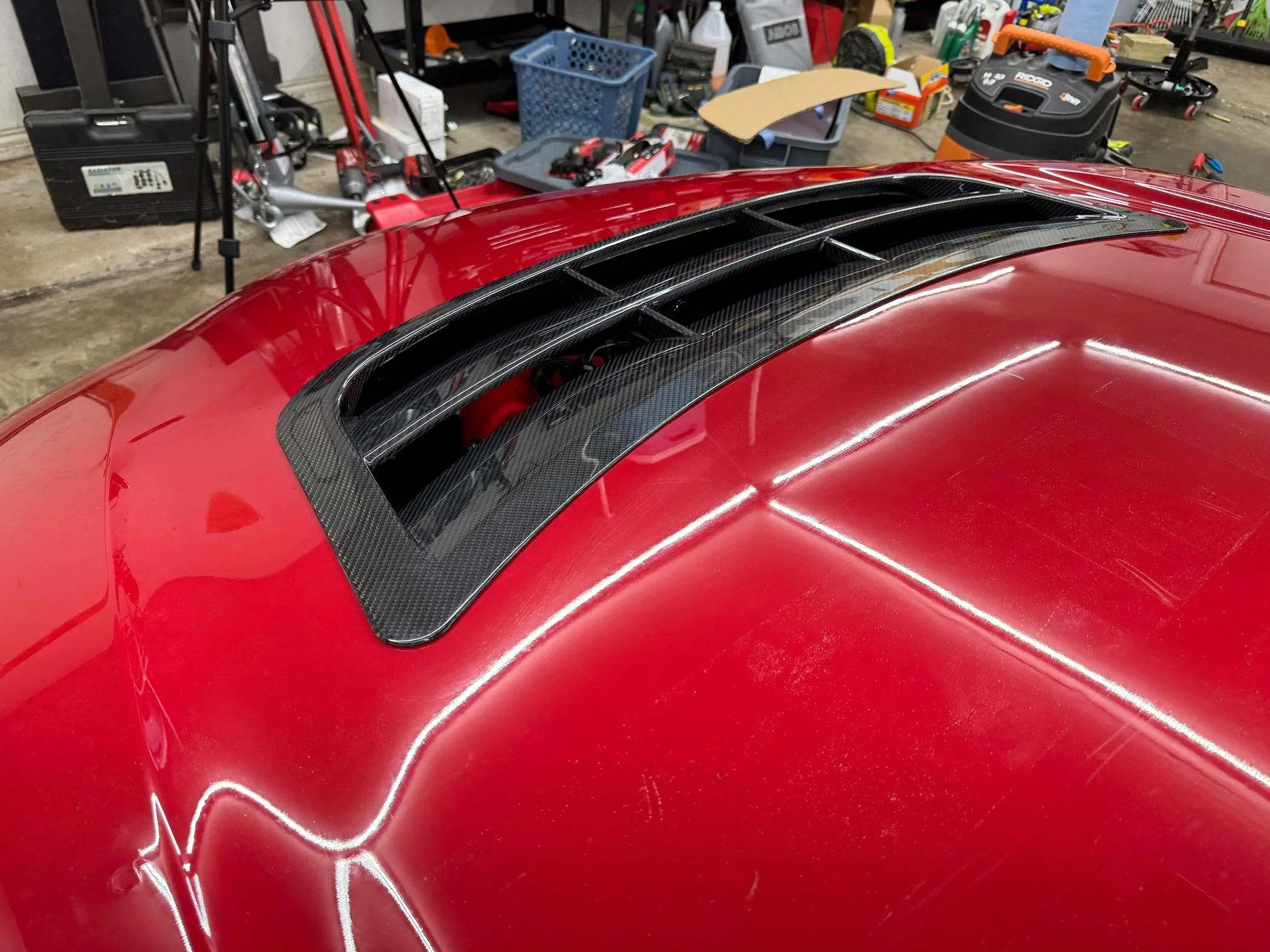

Issa hole. Going to take a sander/grinder to the exposed edges to clean them up a bit, then planning to get the vent set on tomorrow night so that I can try and get some track time in on Saturday. It won't be hot hot out, but it'll be over 80*, and that's plenty hot to get some data on this thing.
