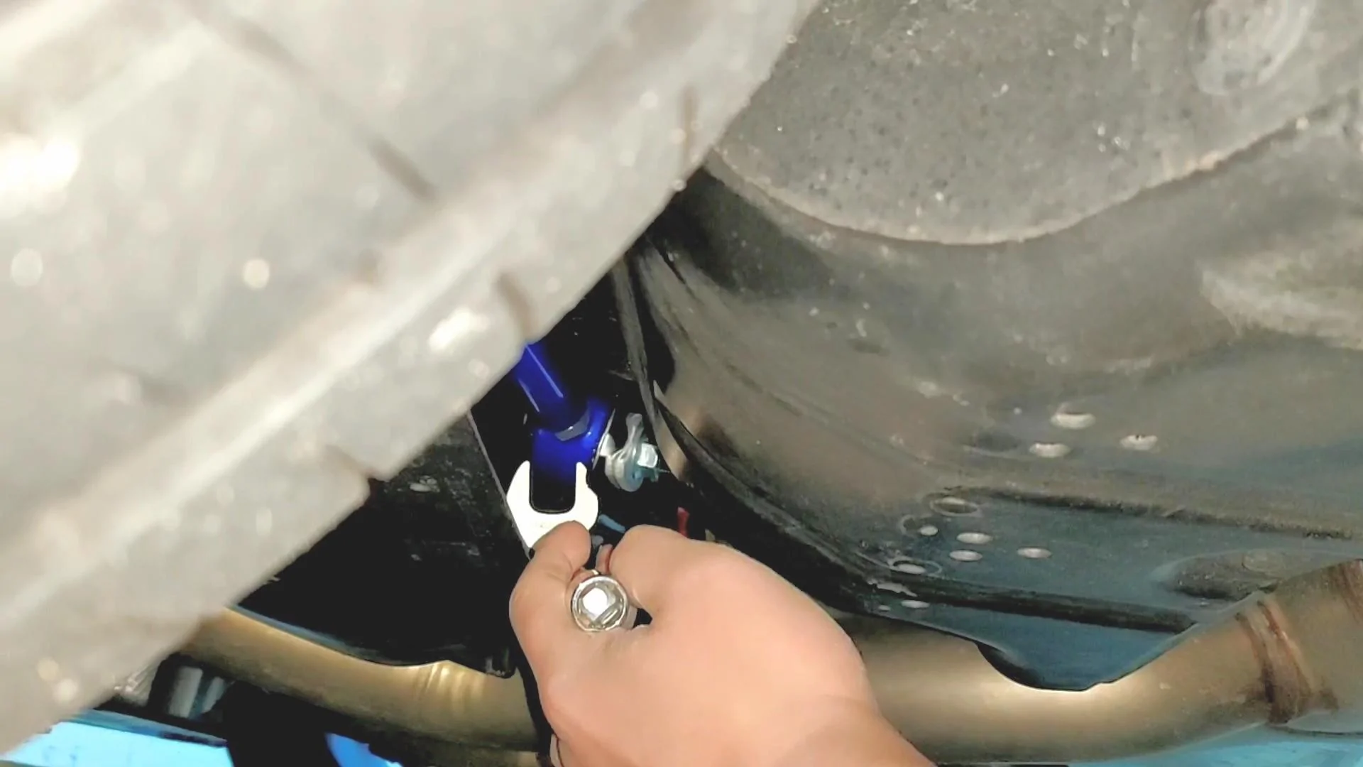

Regarding jam-nut style rear toe arms. How are you actually adjusting the arms while installed on the supra?
The location is incredibly tight and the shop was unable to get in there while the car was on the alignment rack. we tried the usual adjustable wrench, 45-offset spanner, and even a crowfoot wrench on an extension and nothing would fit in that space.
I specifically avoided the SPL's because of the issues mentioned in this thread, but now i'm finding this dead end...

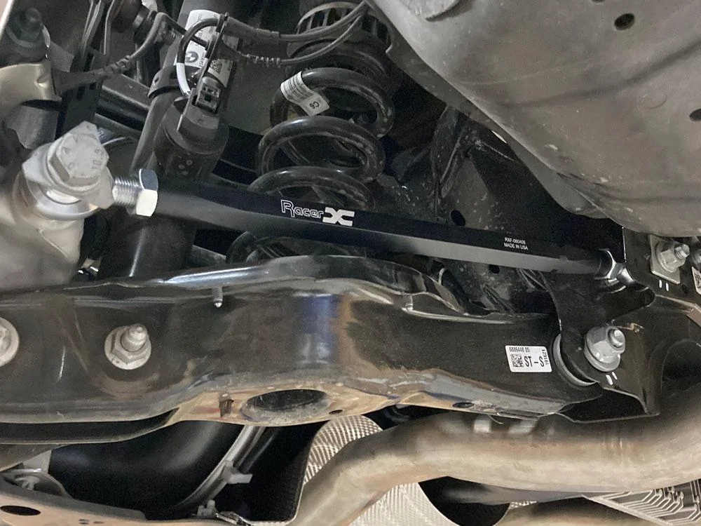

some stock reference photos (different brand, same idea).
For the wheel side, take the two plastic aero bits off on each side and you can probably get to them. For the top side, perhaps one of those floppy wrenches? This was my concern with these types as well. Which arms are those black ones?
Those were a brand called racer x fabrication. I forgot to take photos at the alignment shop and they were the only stock photos I could find online that showed how shitty the placement of the jamnut was.

Here is a good photo from that link that shows the plastic aero bits off. Gets you way more access to the wheel side nut.

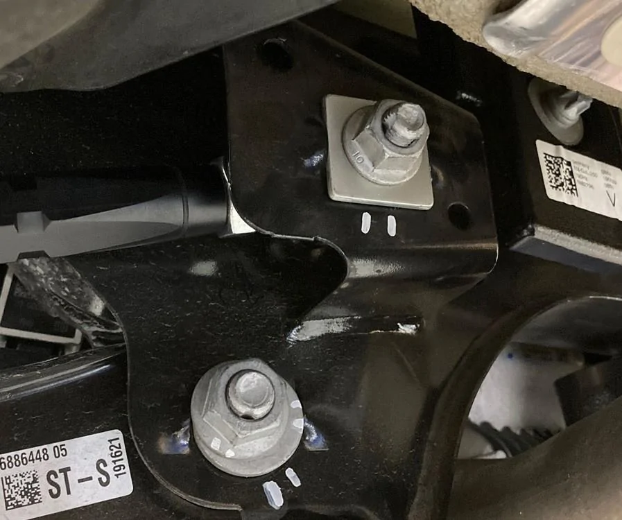

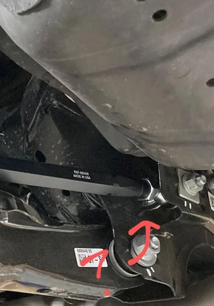

Yeah the outers i'm not concerned about, it's the inner that we couldn't get from any angle. With the cover off you can KIND OF get the inner jamnut with some angled long-nose needlenose pliers, but you certainly can't get any kind of real torque on it. Unless you freeball it and leave the inner loose and only jam the outer nut.

Just disconnect it every time you do an alignment. Alignments shouldn't take more than.... six hours then. ;)

Manufacturer of the arm didn’t design with having ease of adjustment in mind. I would extend the inner joint so the jam nut sits right on the edge the pocket of the subframe. You have to double check shank length to see if you can run one side extended and still have enough thread engagement. From the photos posted, it looks like they have the outer joint extended further so there is some wiggle room. If not measure out the heim and order the correct length heim.
