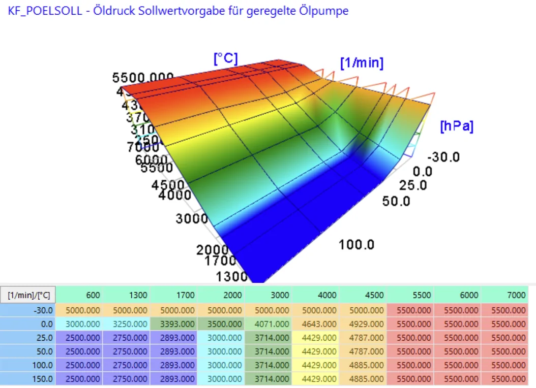

The oil pump is electronically tied into the DME. It has pressure set point tables and full PID control.
Z4m40i
Justin
Nov 30, 2023
161
180
Salt Lake City
2020 BMW z4 m40i, 2020 BMW X7 40i

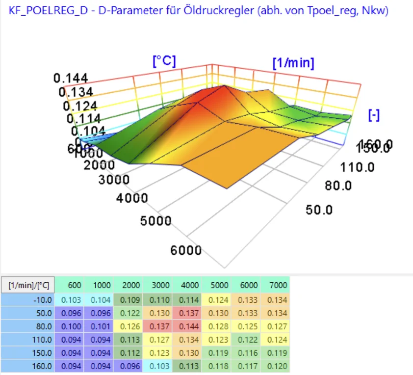

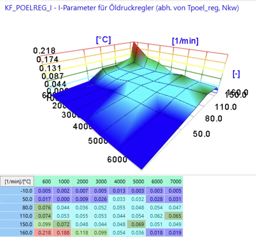

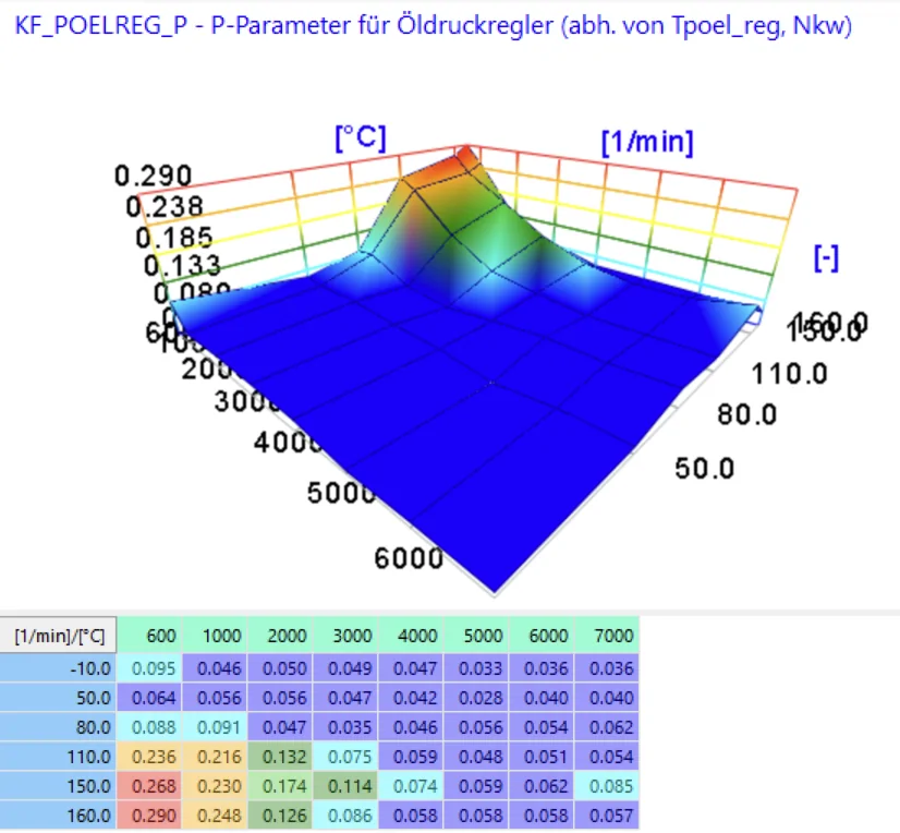

are there any corrective tables that influence oil pressure? I’ve always had oil pressure issues both with/without the Verus oil cooler and just never manage to hit oil pressure targets once oil temperature hits 260F. Currently experimenting with 5w50 to see if this helps.
8,778
17,220
Yes, the PID tables. I haven't defined them yet but they are there. I can put some hours in this week.
Oil pressure setpoint: (5500hpa = 79psi absolute)
Oil Pressure PID tables:
