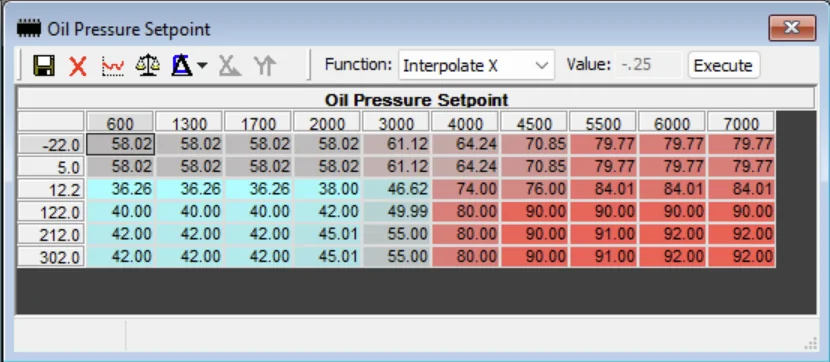

When I defined the Oil Pressure Setpoint I converted HPA to PSI as it's way easier for me to quickly parse that.

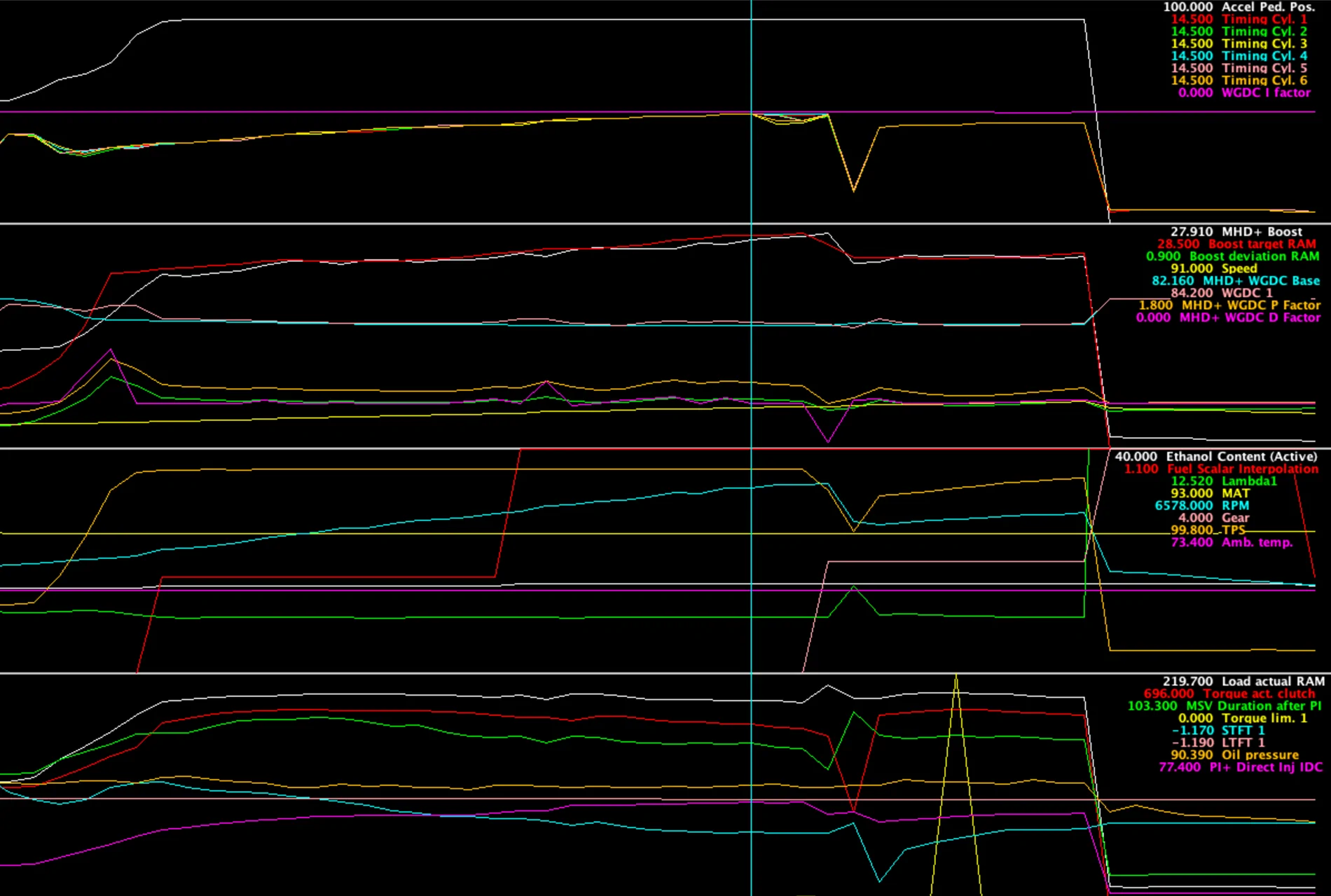

Here is my current Oil Pressure Setpoint table, followed by a log from today.
just to clarify, is this still PSIA?

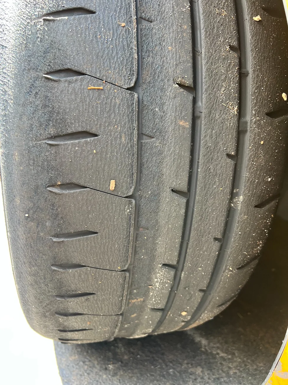

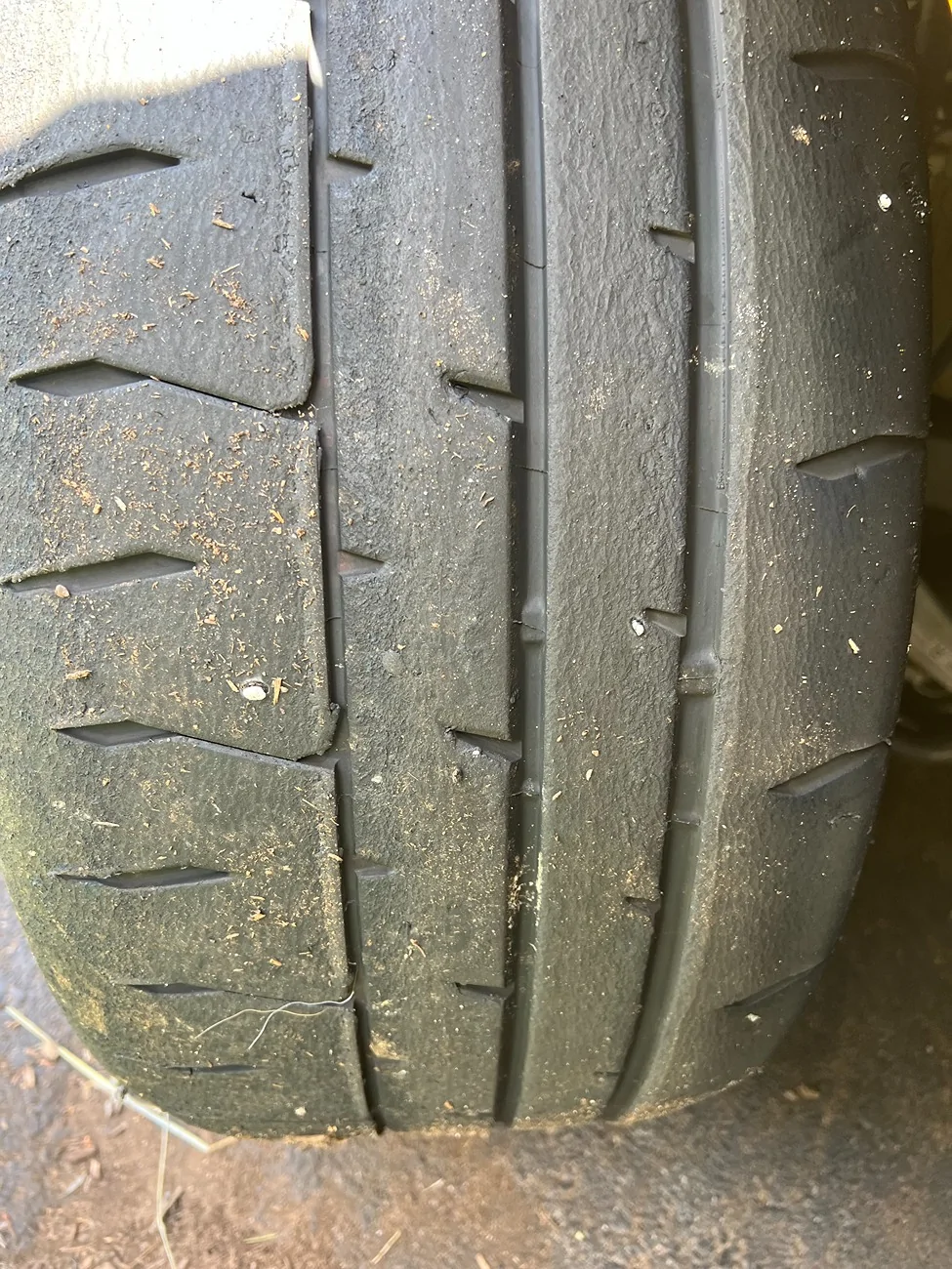

I keep going through my front tires way too quickly. Here are a picture of a set on RE71RS fronts that were brand new before my last track weekend (3 days at Watkins Glen 11 heat cycles 20/25 min per sessions). I think they are already shot because of the sidewalls.
Set up:
- I ran 265 on oem wheels.
- They were heat cycled by TireRack when I got them fitted.
- I would take about 2 laps to warm them up each outing
- I have -3.0' camber and total toe in of 0.19
-I used to run 32psi hot, but went to 35 psi this time (as I thought my issues may be under inflation related.
What can be causing this?
- not enough camber?
- Too much Toe in? Is this scrubbing tires and I should change to 0 toe?
- wrong pressure
- Driving too hard? I drive hard, but try to be smooth -instructors have never called me out on being a hooligan
- Not taking enough time to warm up tires (hence cracks)?
-Driver needs to shed a few pounds?
Subydude
Tim
Jun 25, 2025
162
115
Cayce, SC
Too many
That looks like a combo of not enough camber and turning the wheel too far. Likely more turning the wheel too far since that's what produces that type of shoulder wear at that camber level.
Mid turn, if the car is pushing, you want to unwind instead of adding more steering as that additional angle tends to just grind the tire away.
A 265 on a 9" wheel is a bit of a stuff as well, so you would want the higher pressure to prevent roll over. The 71RS, like most 200tw tires, likes a bit of a stretch. If you go back to it, I might go to the oem size of 255 and then play with pressure. As the tire is better supported you can go down a bit on pressure, but if it's pinched you want to go up to keep it stable.
Over all, you likely want to get rid of the front toe in and run around zero toe (toe isn't what's killing this though). A quick reset via toe plates should help that. Then I'd see about running 35-37 hot on that set until cords are showing. Try to focus on not turning the wheel more after the car stops turning more. The trick is getting the tires squealing, not squalling. Then see how the wear looks and if you need more front camber.
