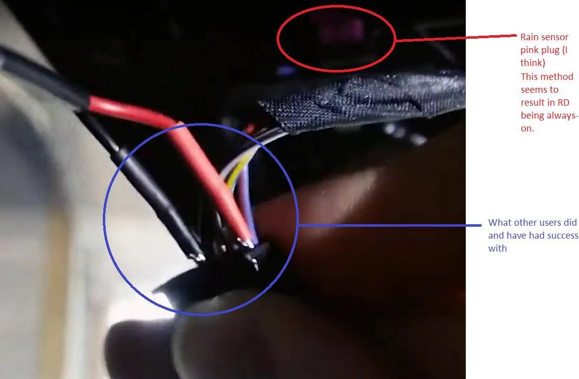

1) Yes- I also have a Uniden R8 (nice). I just tested again. Powered on the unit (plugged it in), got out of the car, locked the doors, set a time for 20 minutes and set my keys across the house -- it's still powered on. When taking this photo, I did not have the keys in my pocket or unlock the door.
2) Yes - there are 3 pins in the pink connector inside the mirror shroud. I installed as such:
a) red wire (DC+) goes in far-right pin
b)black wire (DC-) goes in far-left pin.
c) The middle pin remains untouched

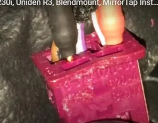

Yeah in this thread that I referenced before my install, [here], the video shows the same rain sensing tap install in the pink connector as I have shown above (what I did).
What's funny is that further down in the same thread another user recommends a different install video, but concludes, " the wiring was the same as Christians video above." (my screenshot above). This is not accurate. They use two different plugs for the tap. This method looks more similar to what you've just shared.
So I think I've figured out a possible differentiating factor: there are different videos circulating around that recommend either the rain sensing plug (pink) or the mirror plug (black) to tap into....I think the pink-connector plug folks ended up with something that's always on. Maybe that's why there are mixed results.
I'm going to reconfigure the wires into the black-plug as shown in the 2nd image above and hope that fixes it.

Switched to the black connector and all is working as expected. Thanks everyone for helping to narrow this down.
For anyone searching for this in the future:
For a mirrortap installation, do not use the pink connector. Use the black connector as shown in this video:
