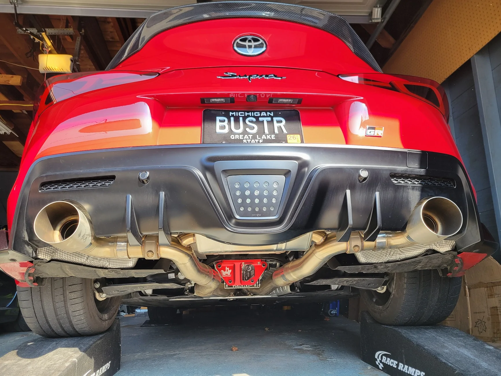

I just got mine installed. The red on red looks as good as I had hoped!
I actually found it easier to insert the diff bracket through the openings on either side of the subframe. This way you could insert it flat in the correct orientation and not have to worry about rotating it correctly through the square hole.

Oh huh, I didnt even realize you could do that lol! Ill have to add that to the install guide.
Thanks for the feedback! Glad you like it!

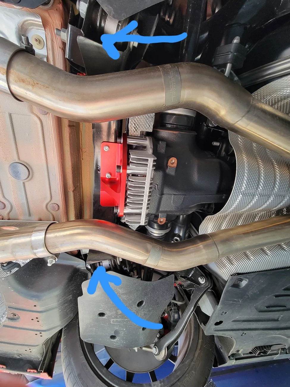

I dont believe any Z4 owners have purchased my brace, albeit im fairly certain you wont have any issues. I wont say for certain however unless yourself or someone else can get me better pictures and preferably measurements.
Pictures aren't as good as measurements, but it's not looking good. Thanks for the reply though.
Once it's warmer and I'm swapping the wheels over to the summer setup I'll get under there with a ruler and make a more official confirmation. Maybe there will be a 3rd group buy some day given how well these have sold (congrats, BTW).

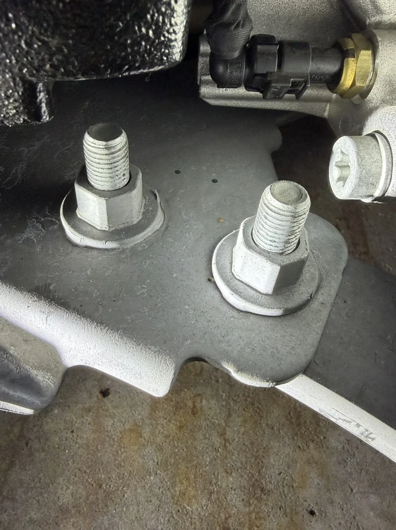

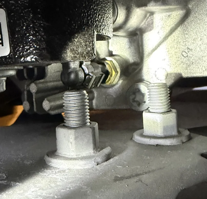

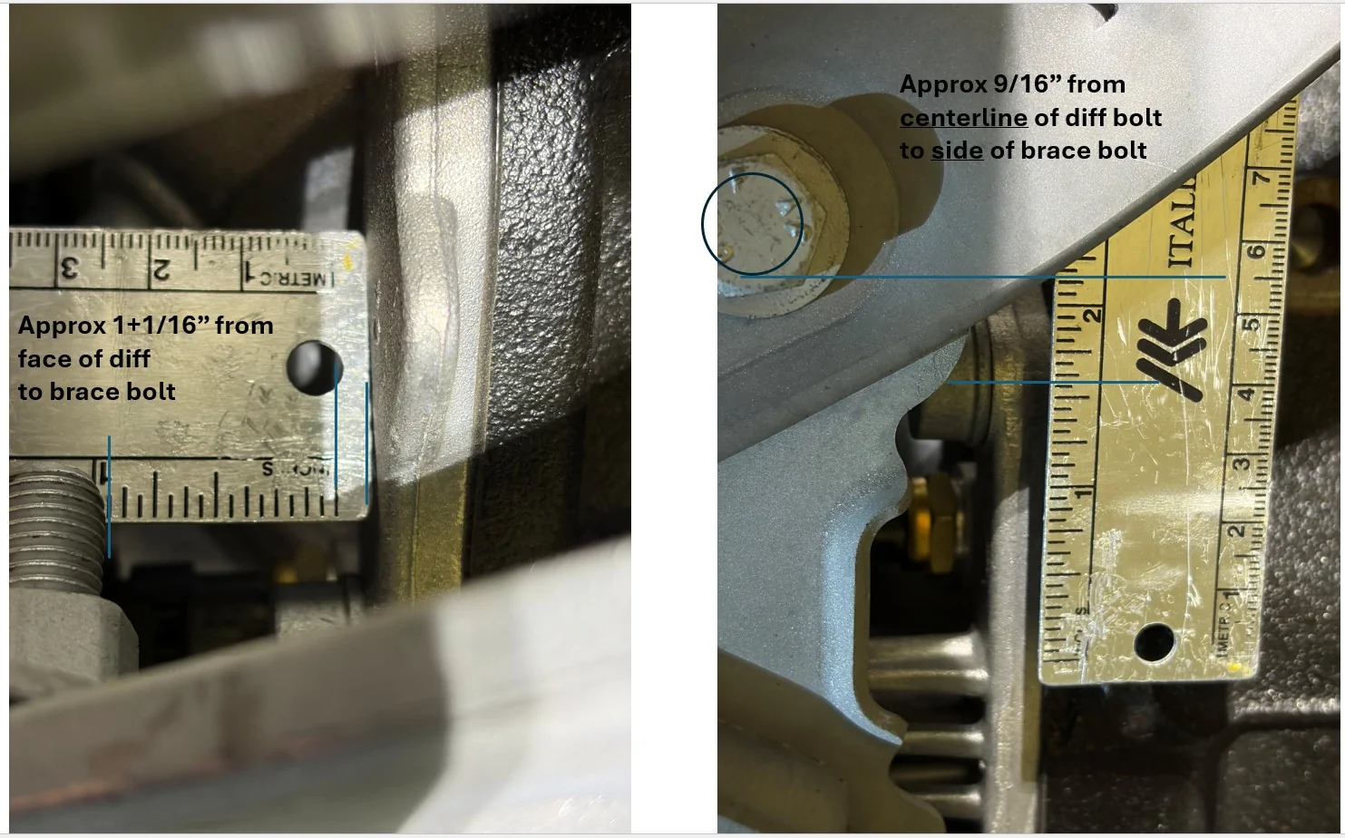

I pretended I had to work from home for a while this morning, and got the back of the car up and took some pictures from underneath.
If I was smarter I'd have grabbed the height of that bolt while I was in the garage, instead of thinking about it afterwards like right now, or at least the height of the nut (since I'm sure I can get a shorter bolt). Sorry.

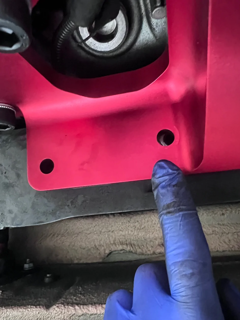

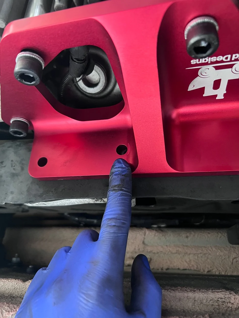

anyone have an insert inside their subframe when putting in the new insert specifically for the most inner hole? the other didn’t have one but the inner one did that i could feel with my finger. I have a 2021 if that means anything. I threaded it in on the innermost to feel if it would even touch the new insert and it doesn’t. i also fingered it around to see if i can remove it and it seems not to be removed. I didn’t see it listed on the instructions so thought i’d bring it up here for support.
Appreciate any guidance
