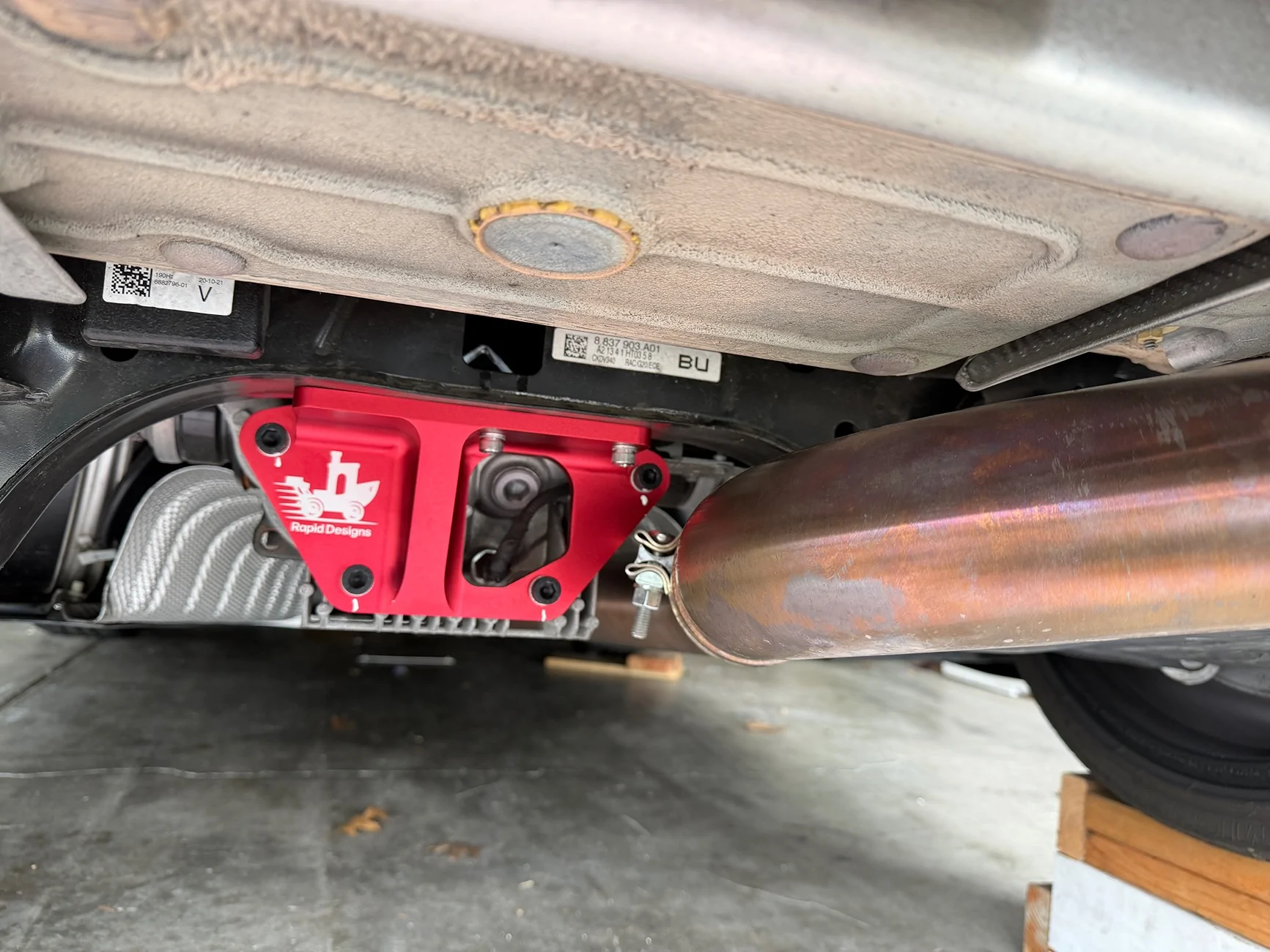

Had it for over a week but finally got it
installed. Pretty straightforward. Even a caveman can do it…. That clamp looks pretty close but there’s enough space. If I develop a weird clunky noise I’ll make sure to check the suspension first.

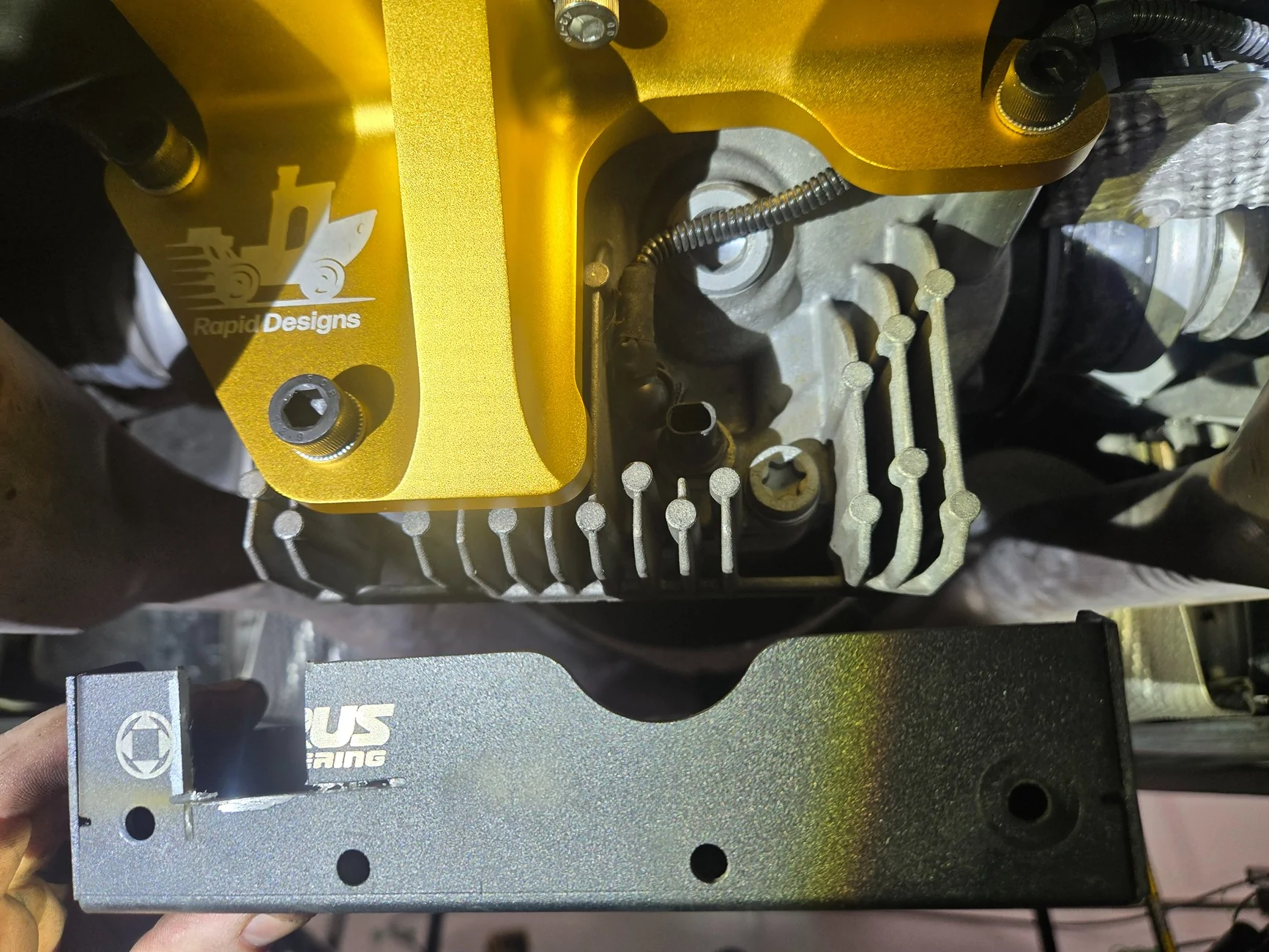

Pictures aren't as good as measurements, but it's not looking good. Thanks for the reply though.
Once it's warmer and I'm swapping the wheels over to the summer setup I'll get under there with a ruler and make a more official confirmation. Maybe there will be a 3rd group buy some day given how well these have sold (congrats, BTW).

Ok, sorry finally had a bit of time to look over these and refer back to my CAD. It looks reaaaaaally tight, enough so that I'm pretty sure there would be some interference. Without actually mounting one up with that chassis brace I'm going to err on the side of caution then. I do know someone from the Z4 Fb groups ordered one after we discussed whether or not it would fit and he decided to order one regardless. So we will get an update at some point then.

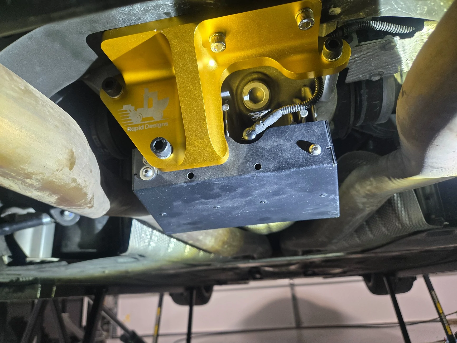

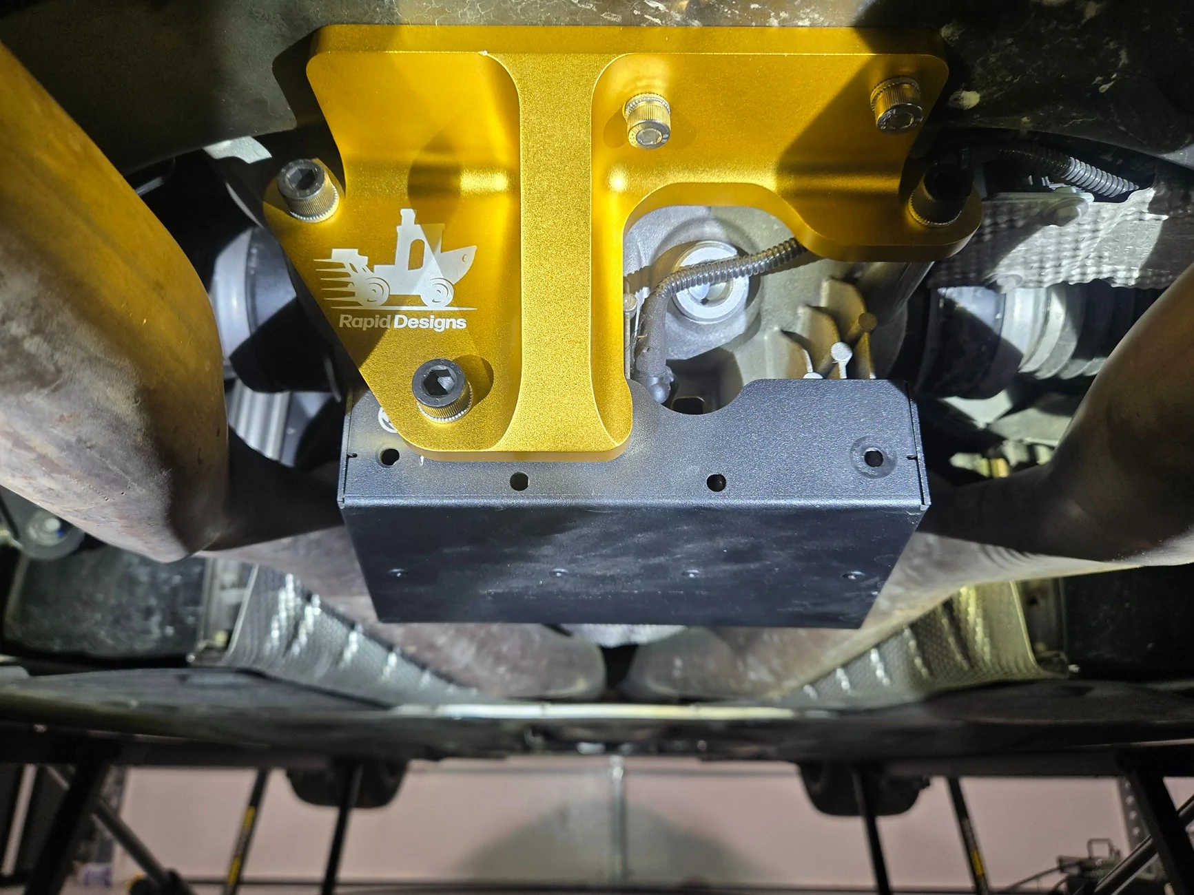

Also good news, I received these pics from a customer. He reported that the Verus scoop does work with the brace with just a bit of dremeling. Note that the cut on the left side will most likely need to be replicated for the right side when using the 4-bolt brace. I'll also update the initial post.
