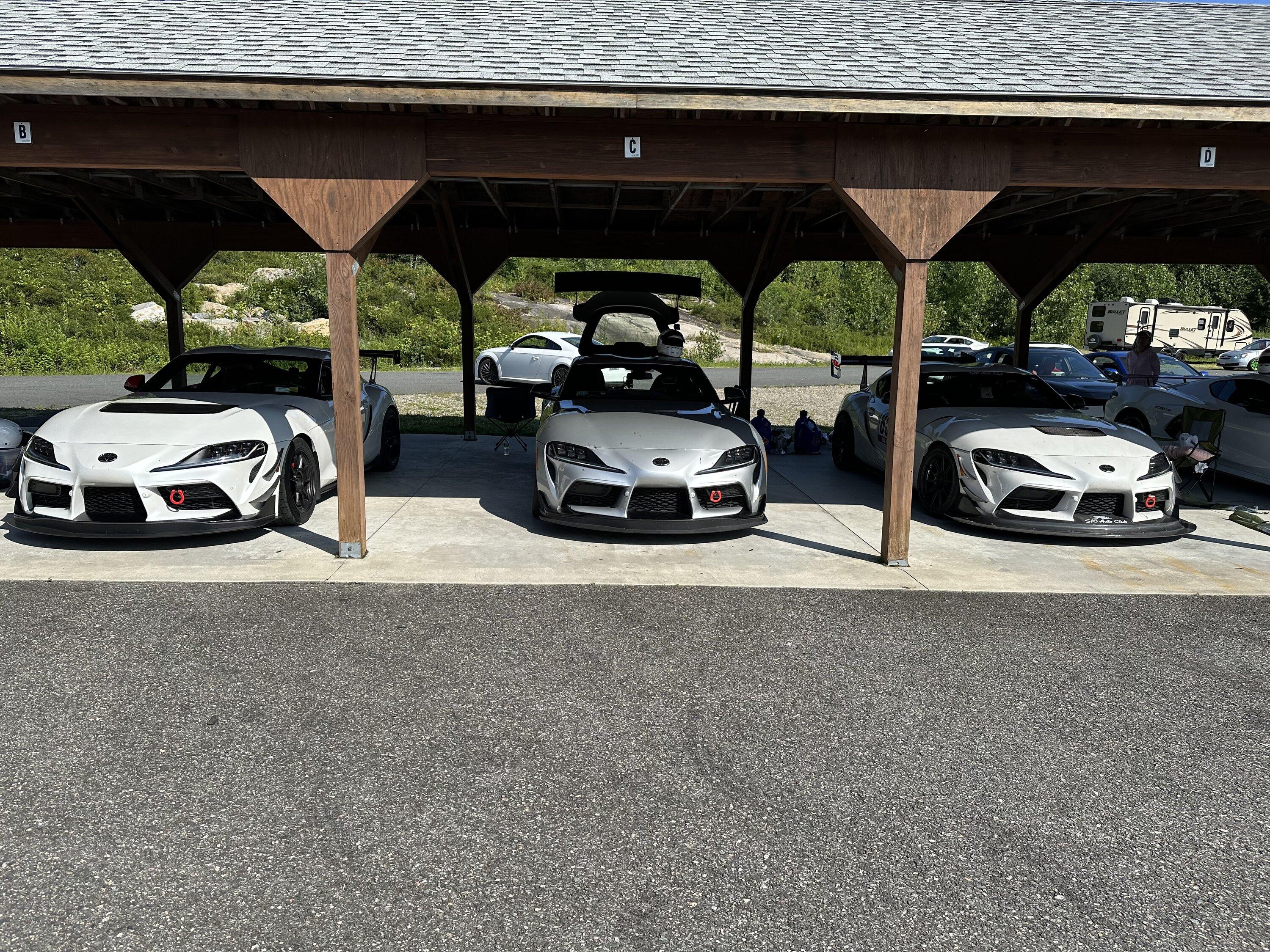

Supra gang. The Massachusetts afternoon sun making it look like all our bumpers are horribly paint matched. We all set PB's yesterday. All three of us did the same 1:45.XX lap times and all within 1/10ths of a second.

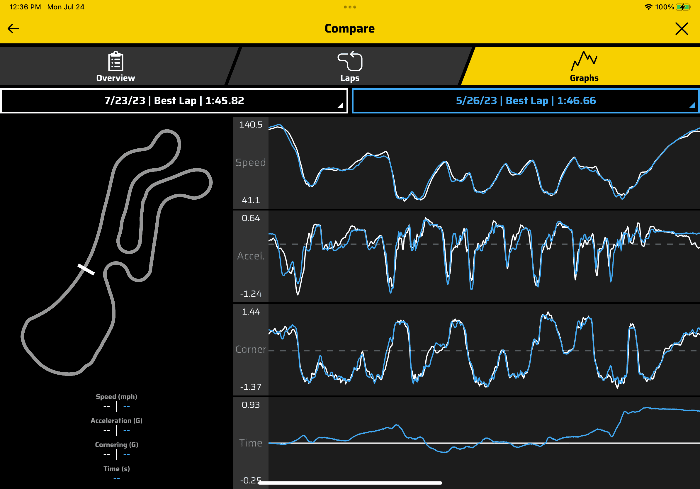

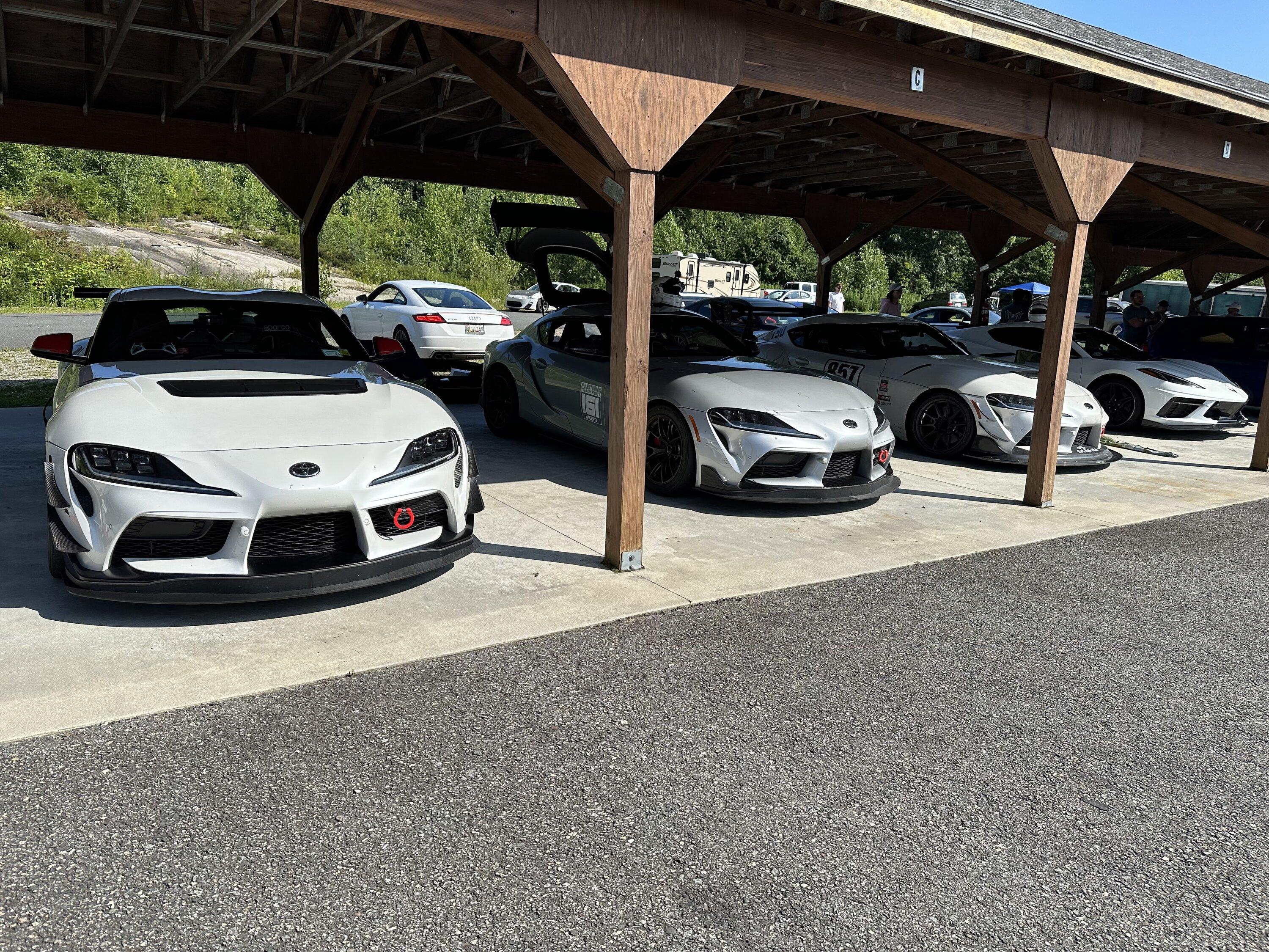

Forgot to add the data plots, you can see were the V2's are giving me more confidence and higher grip in some key sections on track.
