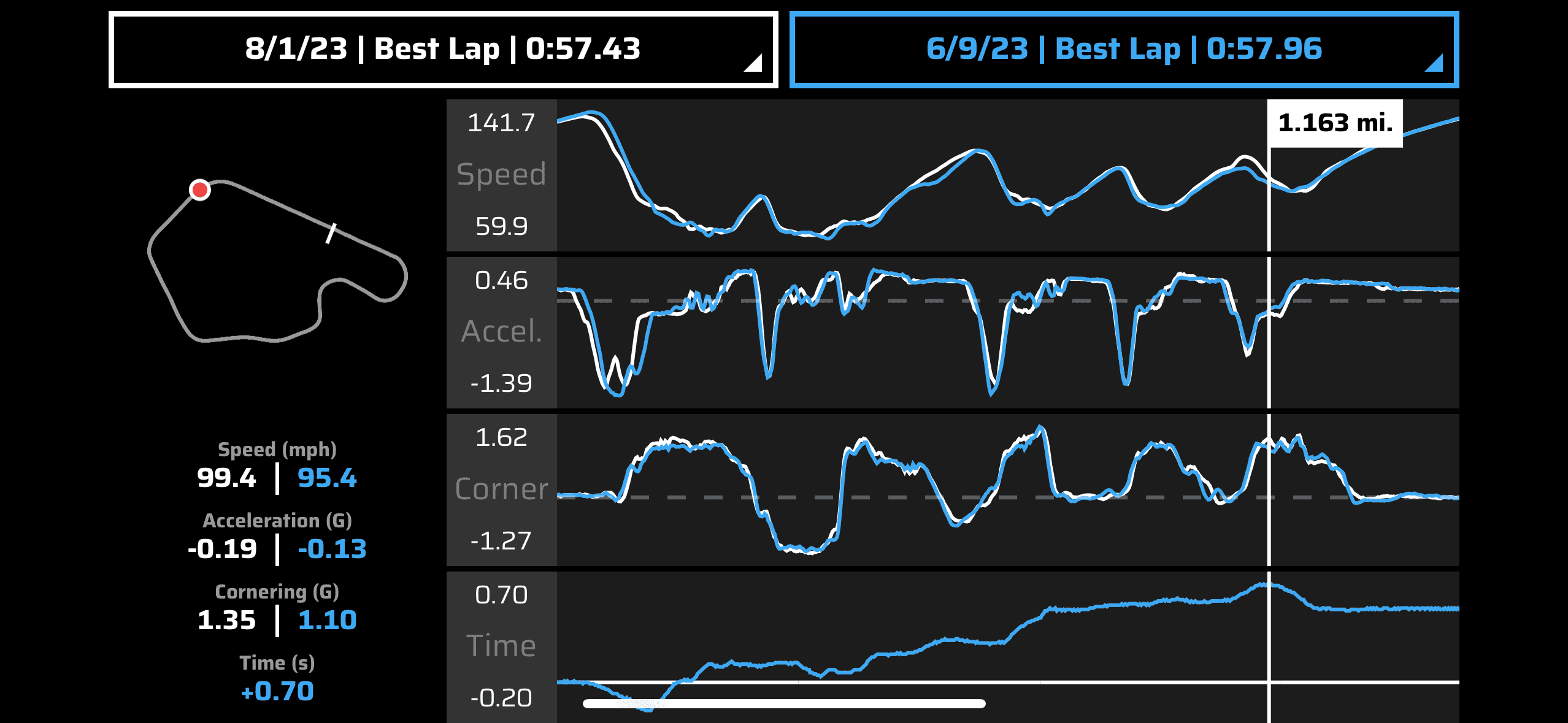

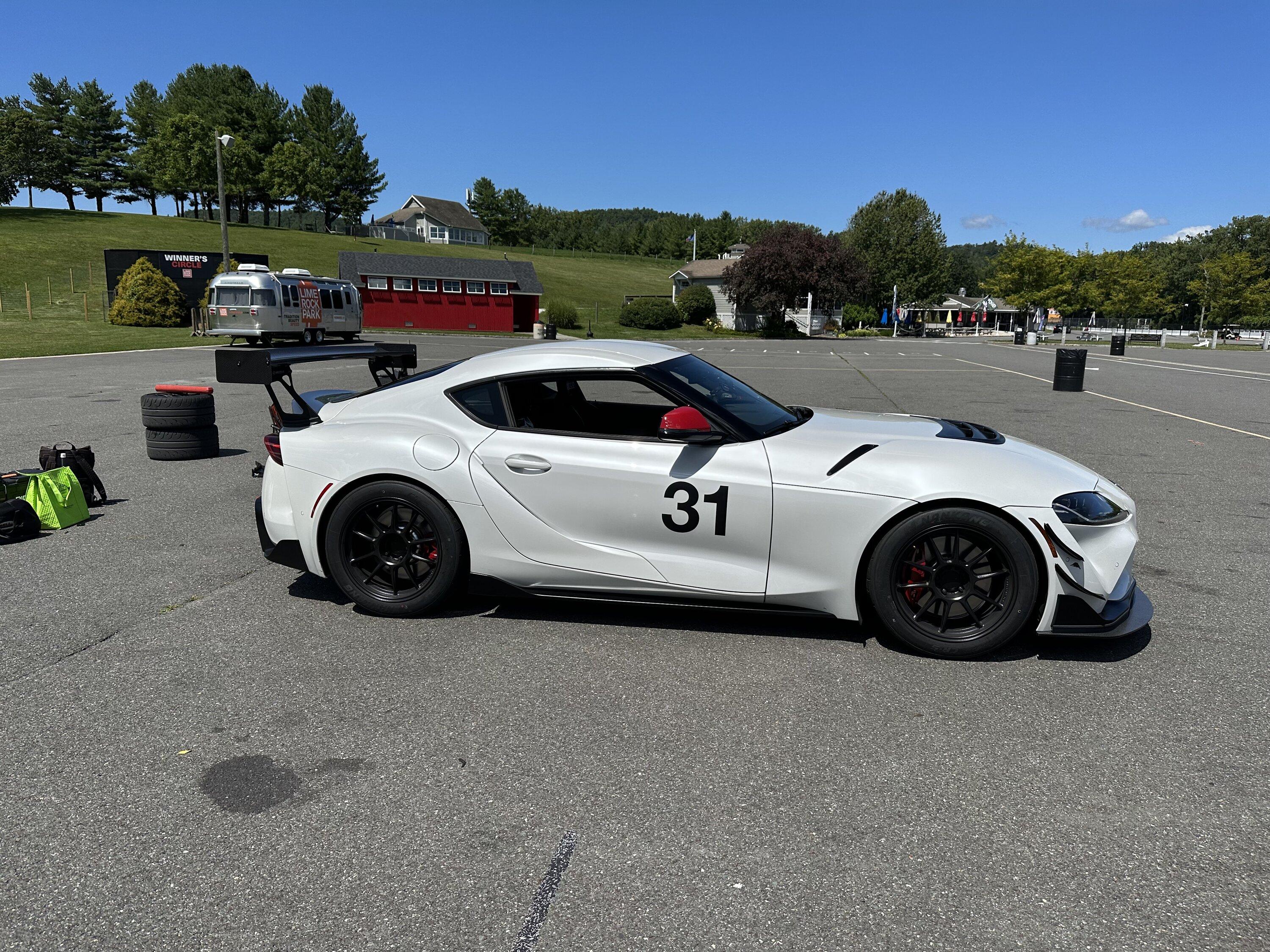

Amazing event at Lime Rock Park today. Private event by Metro Track Addicts. 4 hours of hot open track. No run groups. 30 cars. 75* with 21% humidity on August 1st in the NorthEast. Amazing.
CRS V2 tires continue to delight me. I dropped half a second today (On a 1.5 mile course) and still dealing with some heavy understeer in some corners at Lime Rock. I have higher rate springs I am going to install in the rear but I wanted to do a Lime Rock day with the CRS V2 and no other changes to see what they could do compared to the V1. I'm pretty confident once I dial out the understeer in the car I will hit my 0:56 lap time goal this year.

High speed or low speed under steer? I would do damper adjustments before a rate change.

How the hell does your track car look brand new and photo shoot ready at the track?!?! I‘m in on CRS V2 tires if I can find them in my size and not terribly pricier than the Victra RC1. Those temp and track conditions ? That’s our “winters” down here. Keep it up, Great feedback Bryan!

Mid speed. 70-90mph. I have played with damper adjustments for a couple events now. Have only made very small improvements to the issue.
Lol, I do take pride in keeping my cars clean. I usually wash them before events but this time I just did a quick wipe down. For all the beating my cars get from track events, I feel the least I can do is keep them clean.

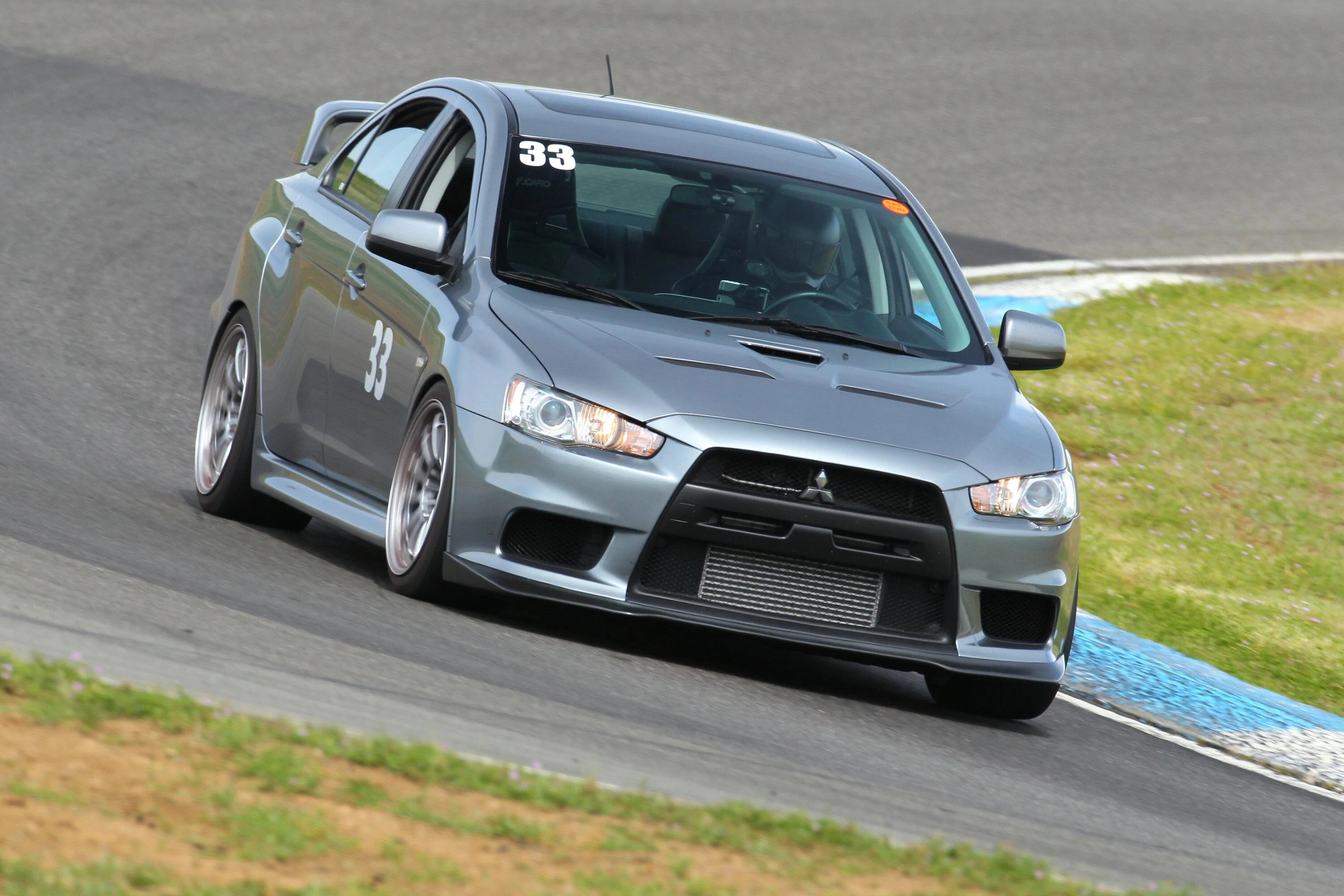

My last track car was kept very clean as well:
