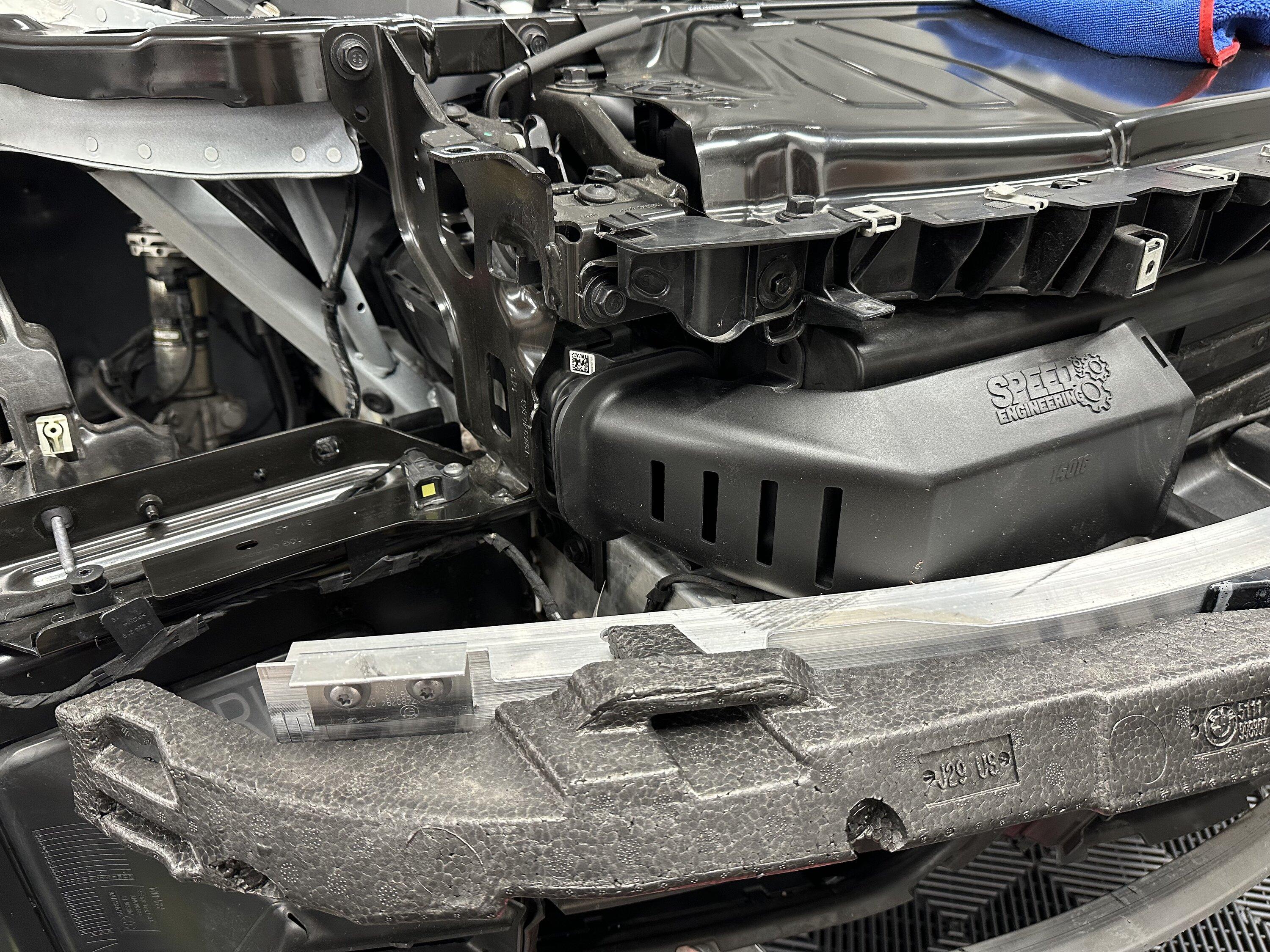

Bryan I like the theory of the speed engineering cold air intake. Honestly I was just think about making a cutout in the high pressure area without the snorkel. Are you tracking IATs? I would love to know if it is worth it
Islindur
Aug 25, 2018
741
696
Poland
Had:Yellow 2l Have: Red 3l
Supopsed to reduce temps by 5-10C, I have it too waiting for install.

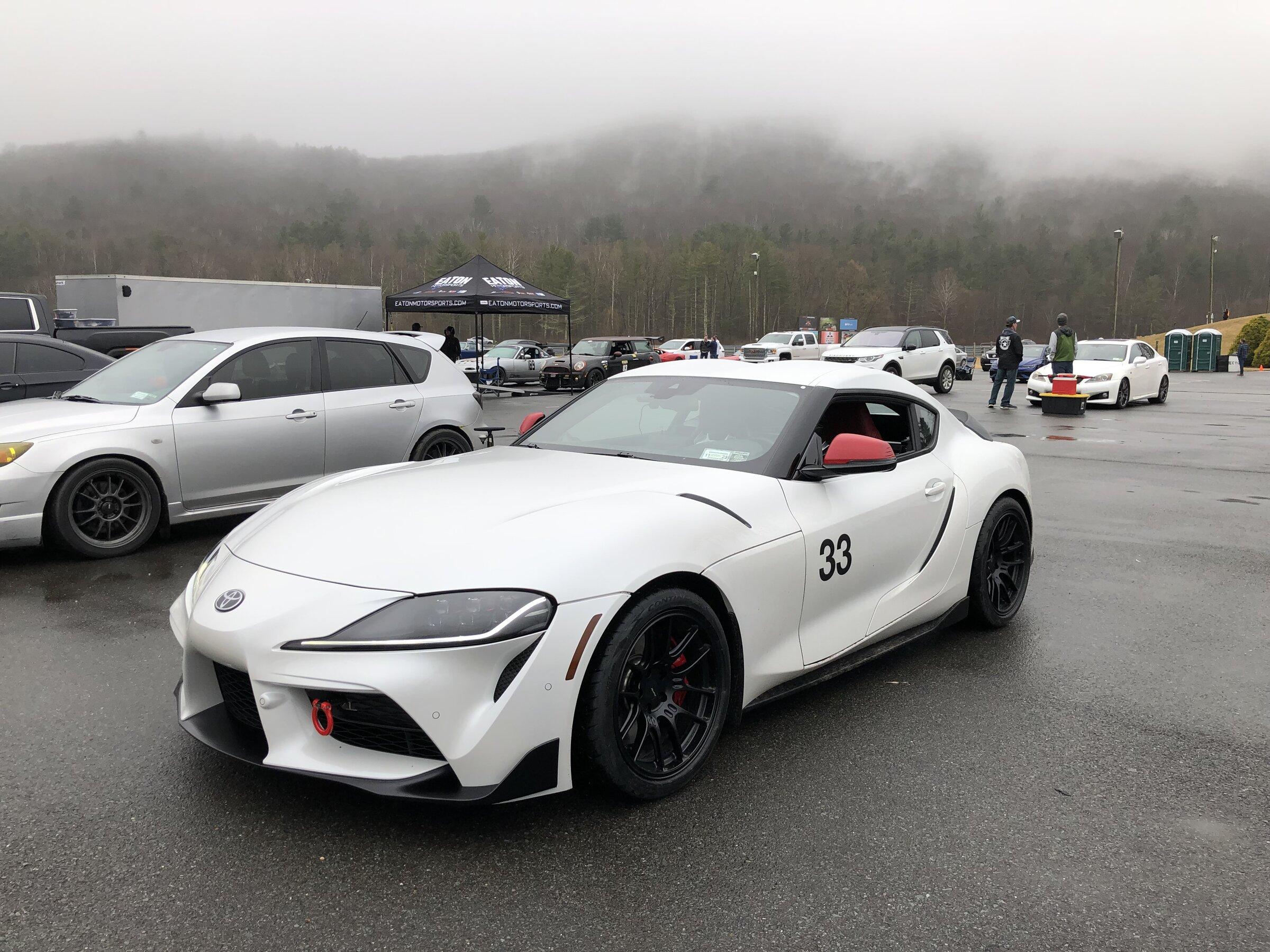

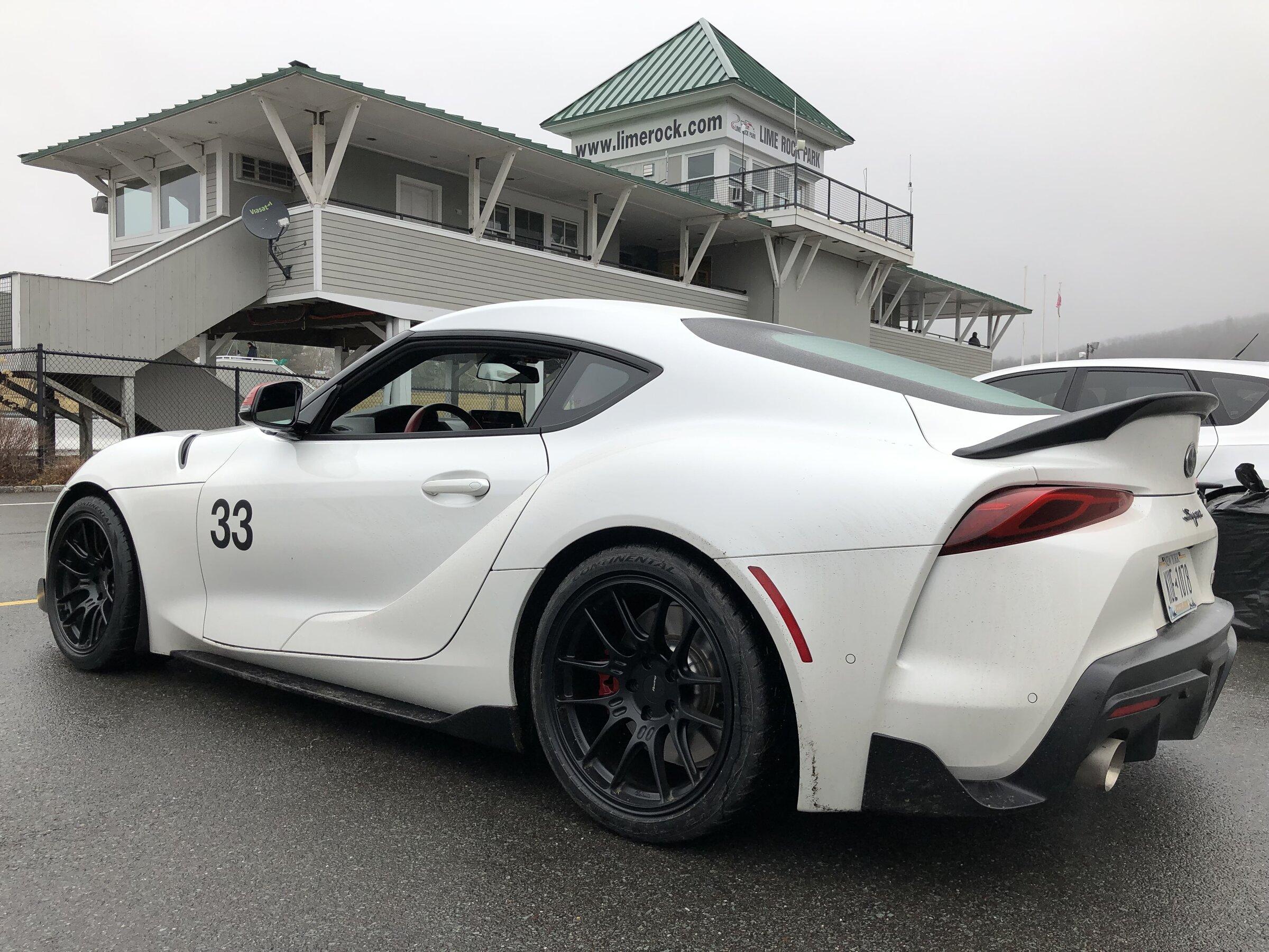

First track day with the Supra was this weekend at Lime Rock. First time to this track for me. Wet, rainy and cold all day. Couldn't get any heat in the tires so the car was all over the place. Lots of cars going off track, some hitting armcos and tire walls so I just stayed safe and worked on learning the track and feeling the car out.
Looking forward to a dryer and warmer track day to really see how the car feels. Soon!

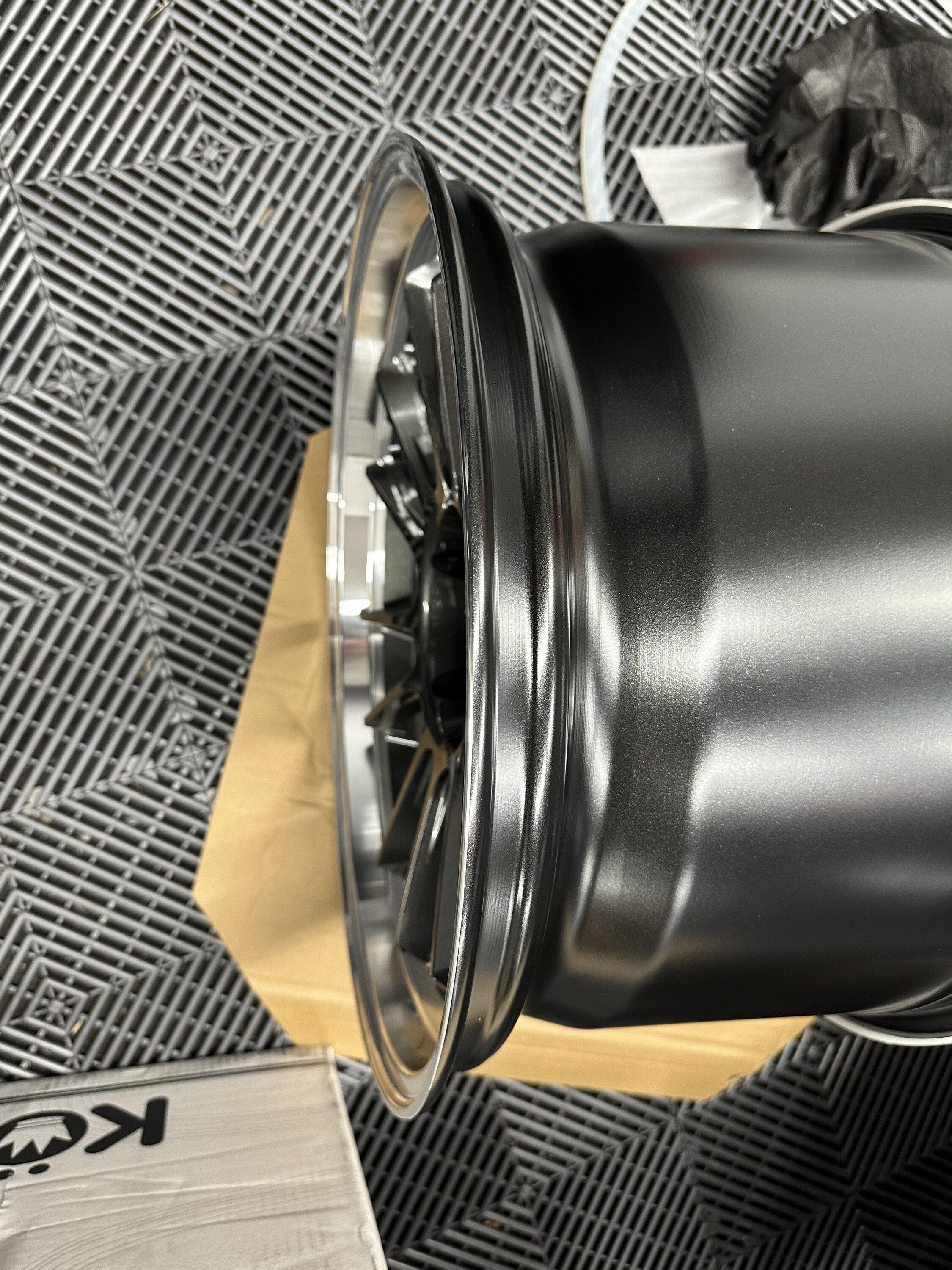

What are the specs on Enkei wheels??

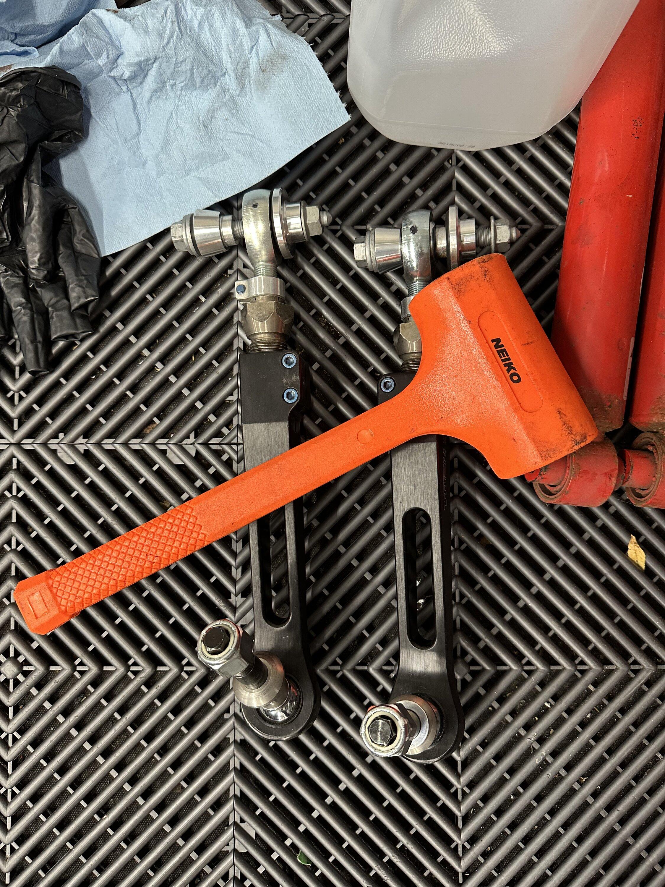

SPL delete. Swapped Cusco 28mm front sway bar out for Whiteline 24mm. Slightly tightened my rack.

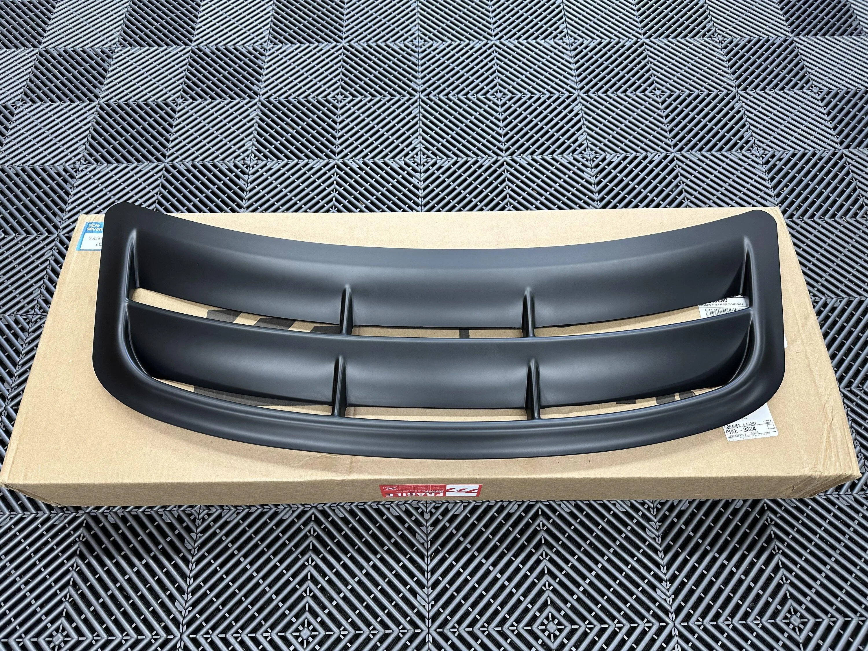

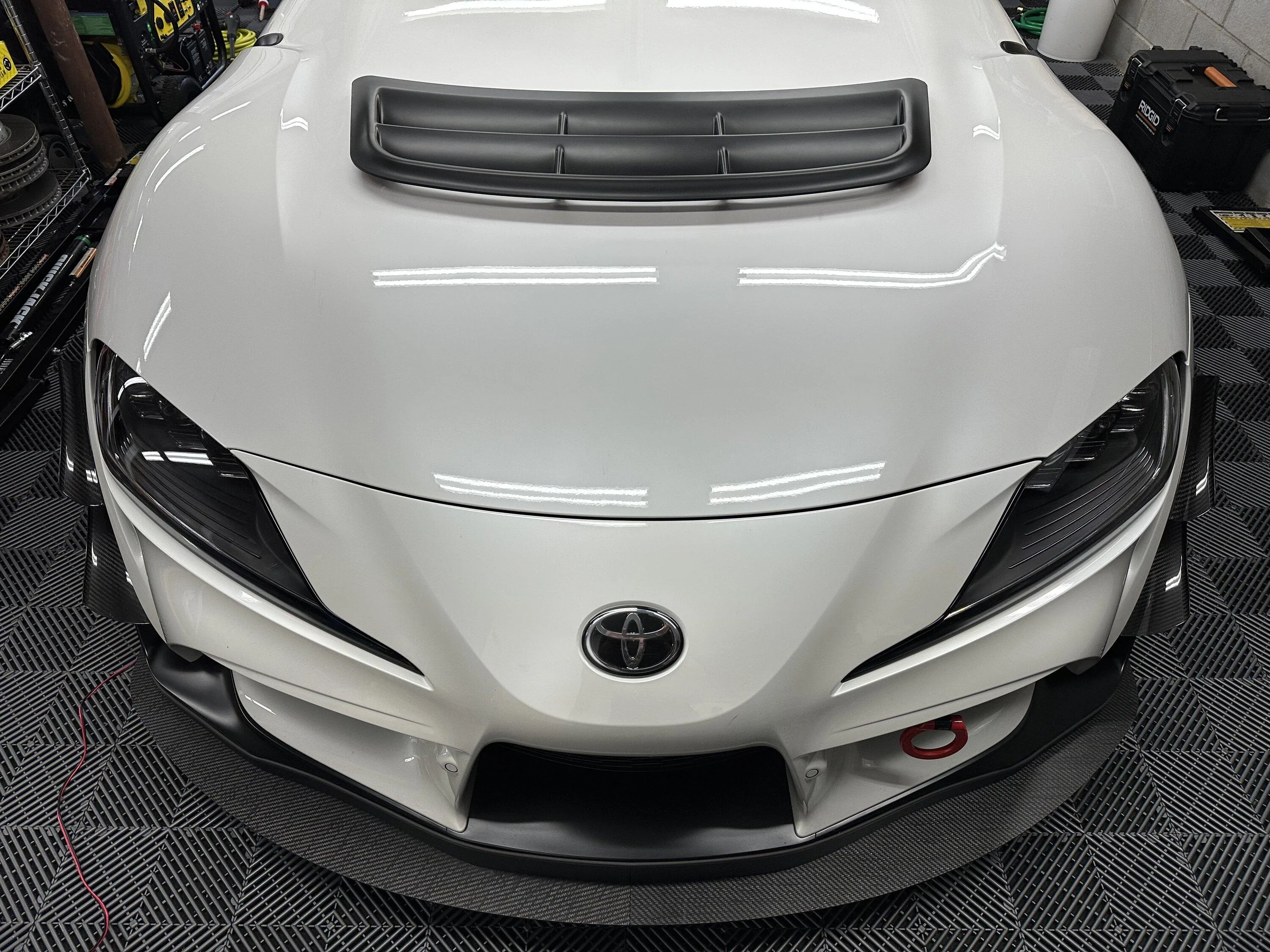

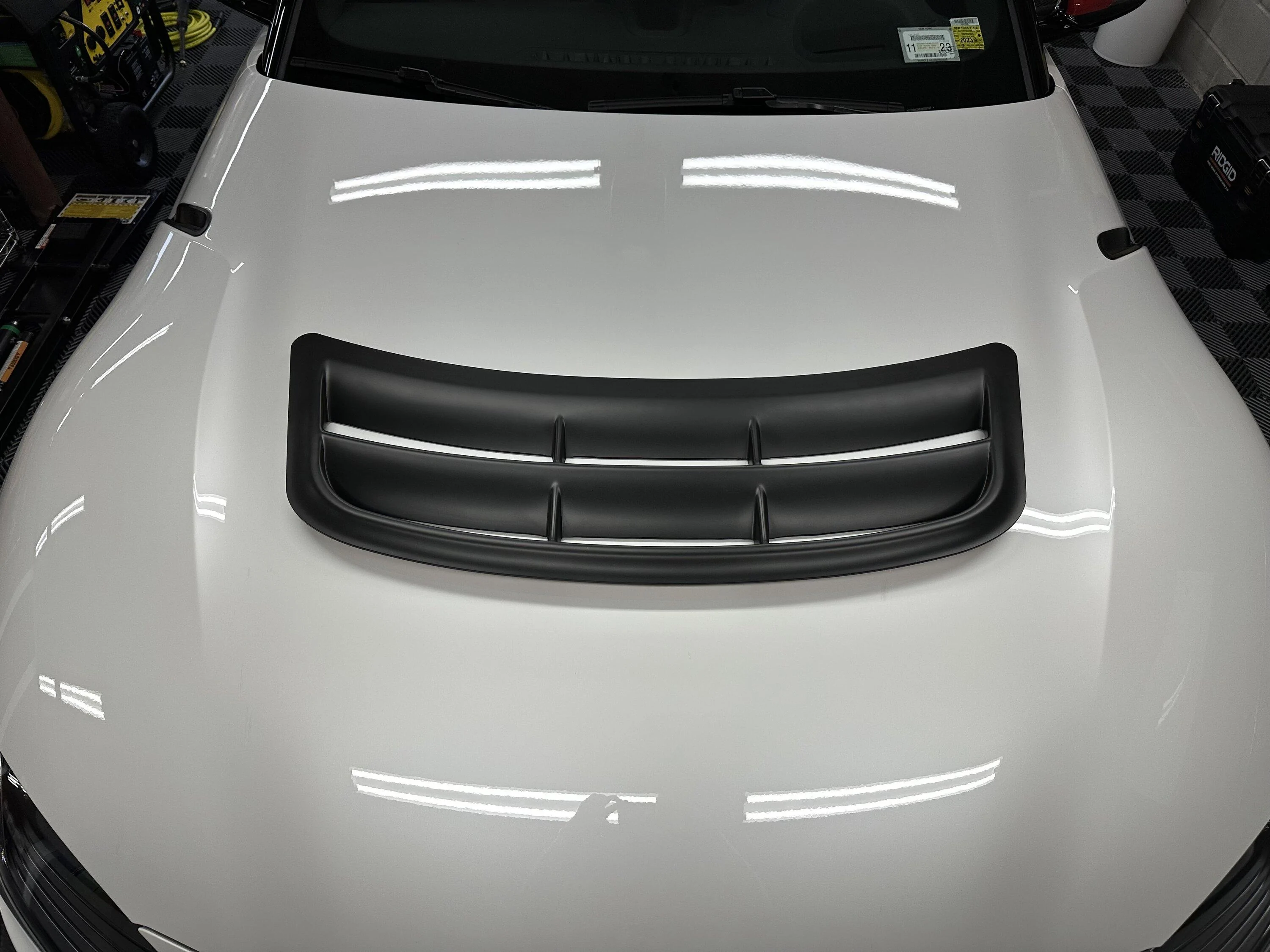

GT4 hood vent has arrived. Time to do some cuttin'!
I know it’s been a while, but did you choose your vent location or just go with the defaults they list on the website? I’m likely to go with this vent on my car and want to make sure I put it in an ideal/preferred location.
8,810
17,287
I put it in the basic same location as the GT4 race car. 18" from the front edge of the hood to the front edge of the vent piece.
