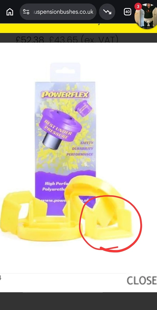

As title states, has anyone used these subframe bushing inserts from Hardrace? Anyone found polyurethane bushings?
Seeking feedback on how they work on the street/fast road. Solid aluminum bushings are too hardcore for my use
I had these inserts installed on my B8.5 S4 before and made a pleasant improvement to the tightness of the rear end without introducing noise and only a bit more vibrations/feel from small bumps. But they actually fits snugly into the void of the bushing. The Hardrace ones appear to only restrict one end of the bushing and doesn't go in very deep and only appears to support the outer bits of the rubber on the bottom side of the bushing, there's more void between the rubber on the top of the bushing. If anyone has other insert suggestions that is welcomed too.

Supposedly powerflex is working on the g29 platform again to add more bushing insert options, i've been waiting for the same (subframe and diff)
