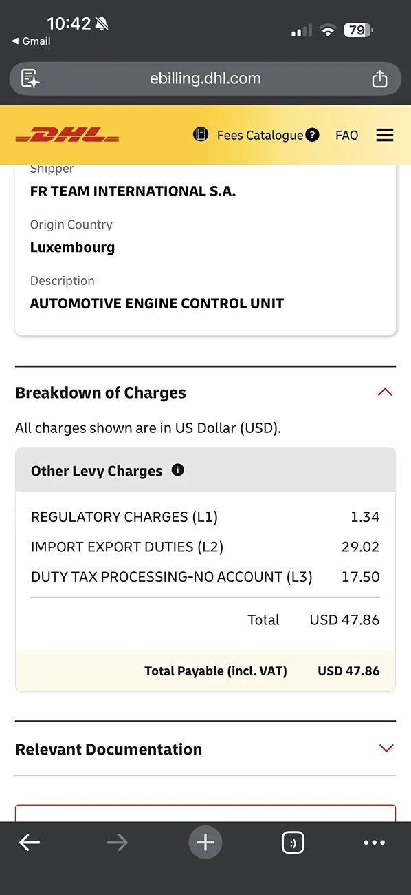

My autotuner import fees were 47.36 USD
my duty fee was $40 coming back from femto. Seems consistent.

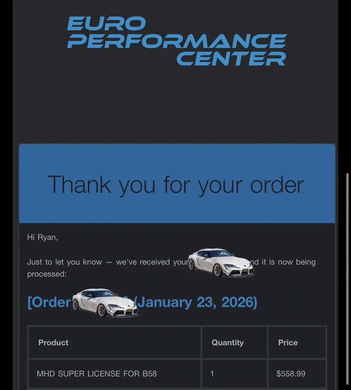

It’s official! I’m part of the MHD club. Just waiting for the 🔑 now!
Eastwood
Dec 20, 2022
749
1,025
SoCal
Try and look up your Calibration ID and CVN before loading MHD.
