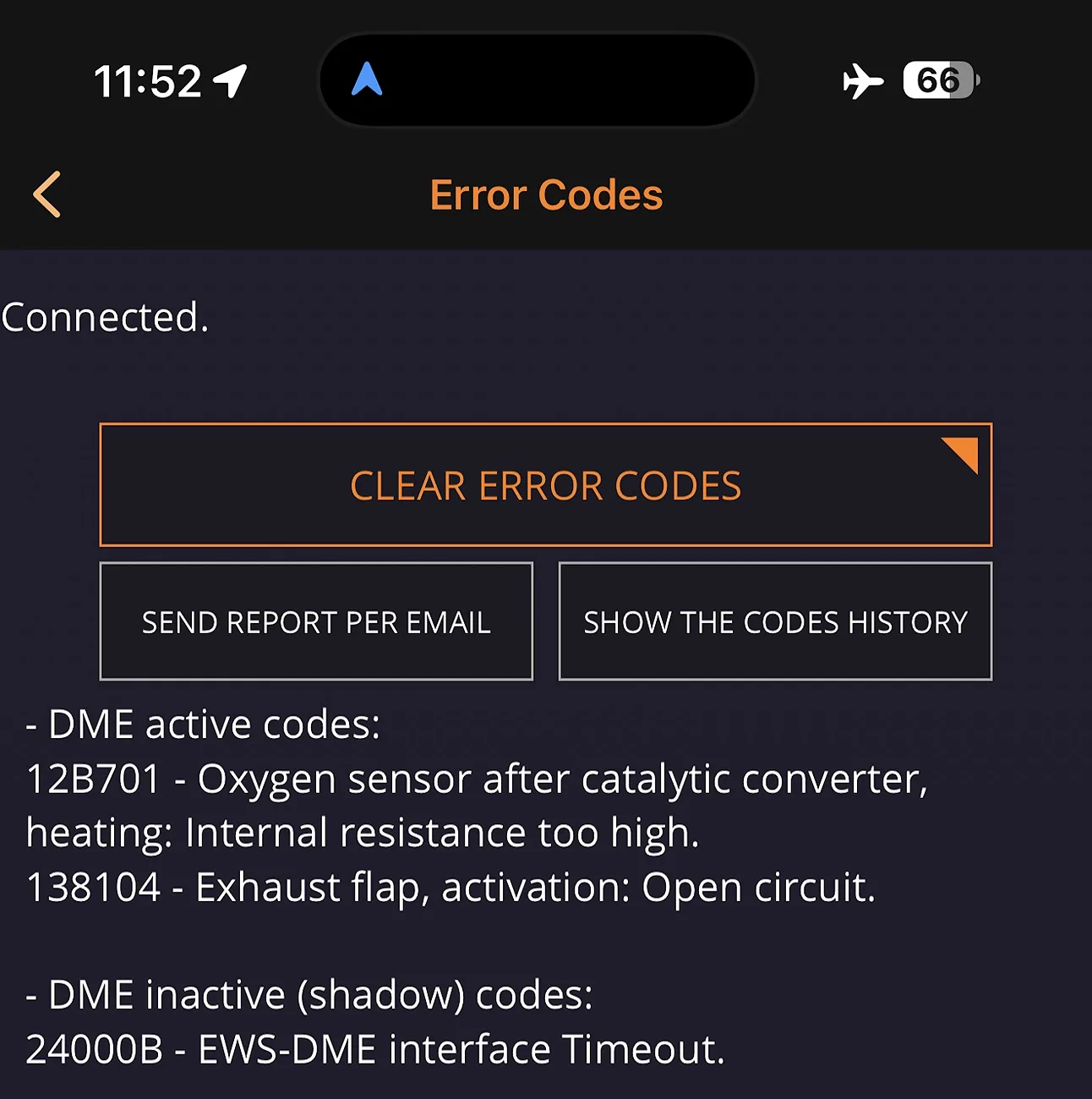

Oh I checked first post, you have the FI Downpipe? You sure it's not the downpipe causing the CEL?
Yeah. Its a catless with a built in defouler which shouldn't throw a code.
It shouldn’t, but sometimes it does lol. Ask a local buddy if you can swap O2 sensors real quick just to see.
Had that happen to me on a previous car, I was able to return the sensor at least.
i3igpete
May 16, 2022
46
1,310
1,584
Chicago
2023 3.0L 8AT
I think i have a theory that this is indirectly caused by cold start noise reduction on catless DPs. With oem cold start, the o2 sensor warmup is "close enough". With cold start noise reduction, the DME thinks "huh, it shouldnt be this hot already, i didnt send enough flow thru yet". The cat, while normally an exothermic reaction at operating temp, requires a lot of heat to kickstart the reactions and thus acts like a heat sink at first.
Can you try turning cold start noise reduction OFF but leave downpipe set to STOCK and see if the codes come back?
Ok I'll try this
8,717
17,087
I have cold start turned off and have yet to get any codes from it.

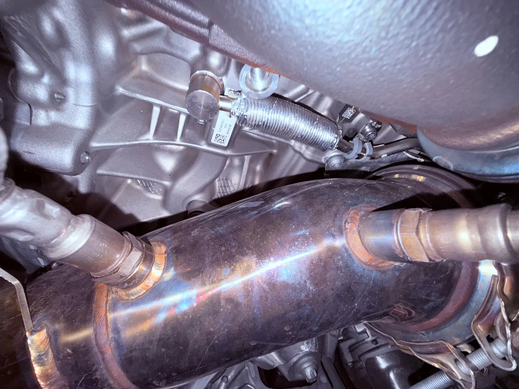

It might be the bung spacing in the DP. What does the rear 02 bung look like on this DP?
I also have cold start off and have gotten this code recently with my kenji catless that never gave me a CEL while locked. Probably same issue.

2023 3.0L 8AT
Yeah, same here. Never a problem with my armytrix for 25k miles while locked, got unlocked and within the first 500 miles it threw the code. I can't turn off catalyst monitoring since that is the one system that cant show as "not available" to pass emissions.
