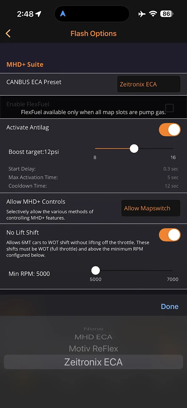

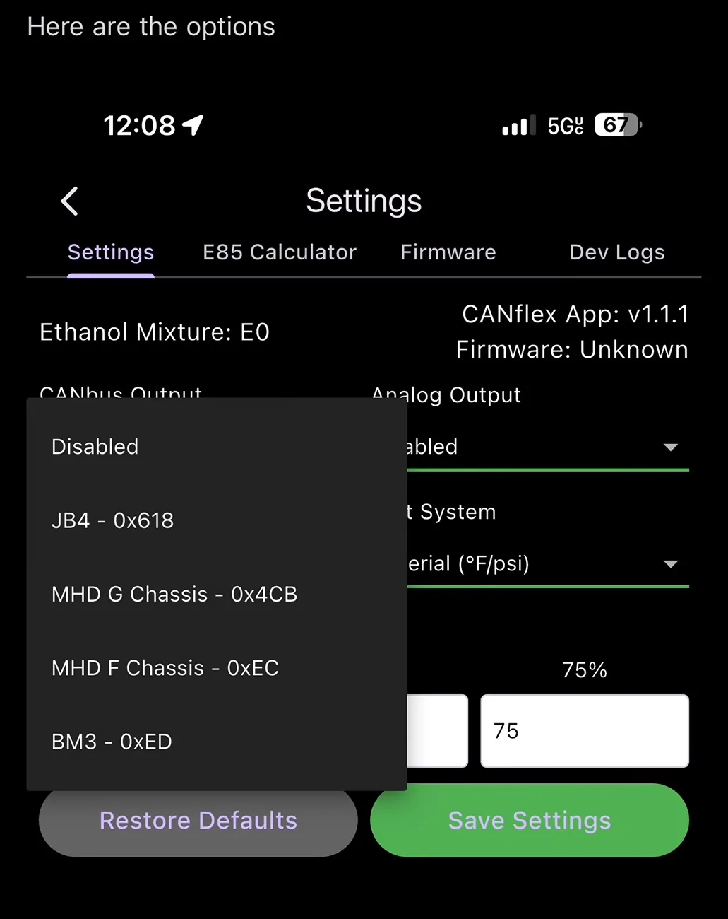

I just installed the Burger Tuning BMS Universal CANflex CANbus E85 Analyzer (ECA). It's not listed in the CANBUS ECA Preset. Which one do I choose?
RyanA90
RyanA90
Ryan
Aug 6, 2020
1,124
1,179
Fairfield, Ca
www.instagram.com
‘23 Supra A91-MT Burnout
The proper settings for the BMS Canflex/Canbus is MHD F (0xEC) and Zeitronix ECA in MHD.

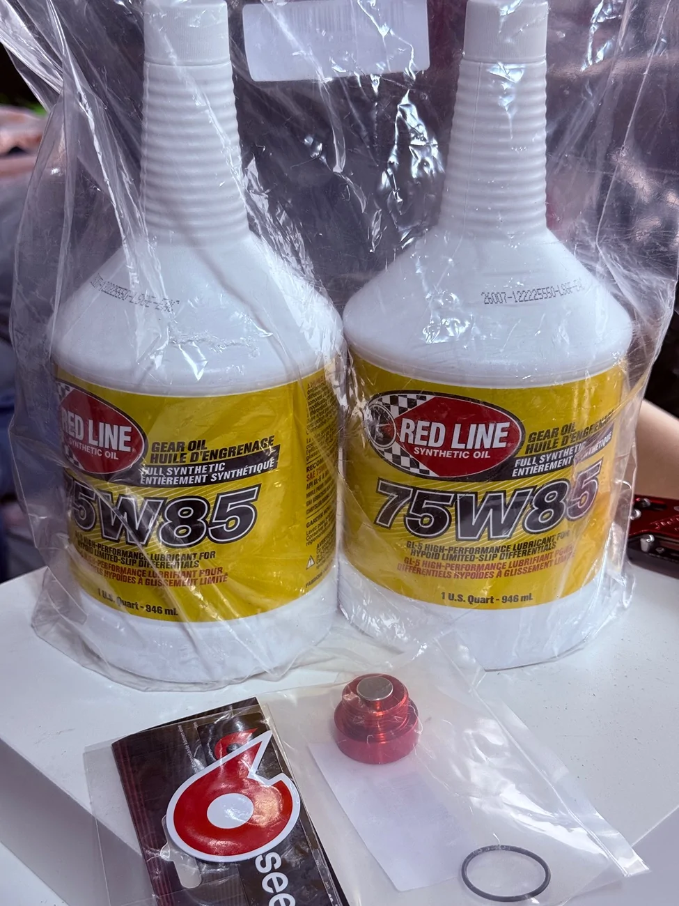

3.5 years and around 15k miles later I’m finally changing out the gear oil and plug.
