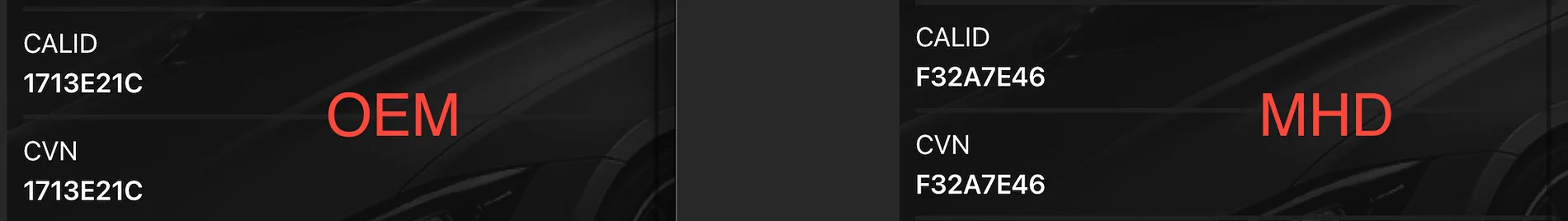

I think i have a theory that this is indirectly caused by cold start noise reduction on catless DPs.
Quick update, it's been 4-ish months since i turned cold start noise reduction OFF. I've done a combo of a short trips, a few cars and coffee, and a 6 hour road trip to mid-O. Catalyst monitoring remains STOCK/ON and haven't had a CEL since.
ColonelAdama
Adam
Jan 30, 2023
1,472
1,680
Greenville, SC
Same. Cold start off for 6 months, only had it happen the one time (within the first month). 0 times since on custom map if that makes a diff

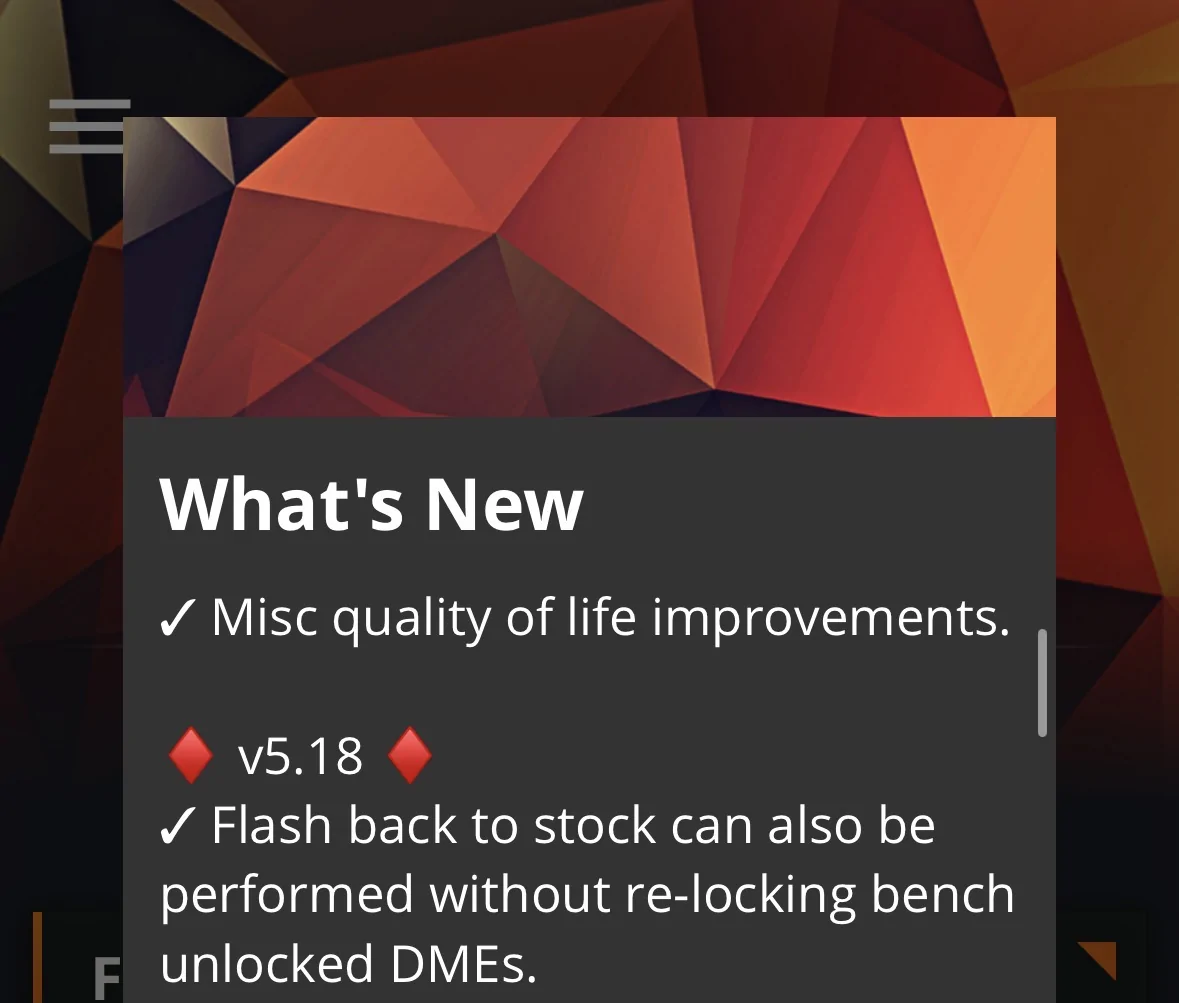

This means those of us in Commiefornia and similar shit hole cess pool political states are screwed, unless you want to dealer level flash (and pay probably a very large bill to do it) back to stock every 2 years.
Doesn’t MHD have a flash back to stock map? In their latest update v5.18 you can flash back to stock without re-locking.
well technically you could flash stage 0, stock map with MHD still installed (and its features). OR you could straight up uninstall MHD and lock the ecu.
Maybe this is a good update for those trying to pass emissions/inspection?

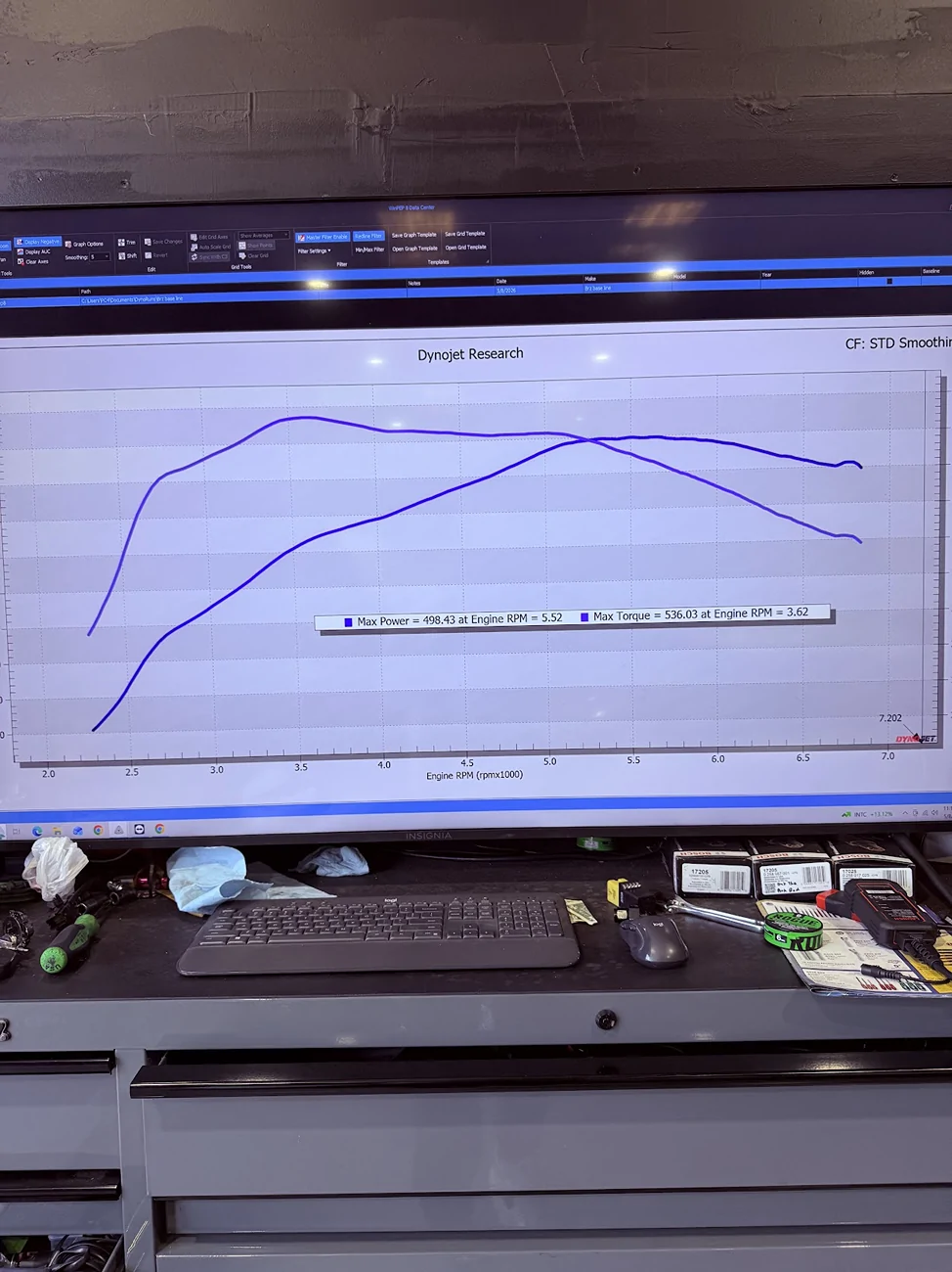

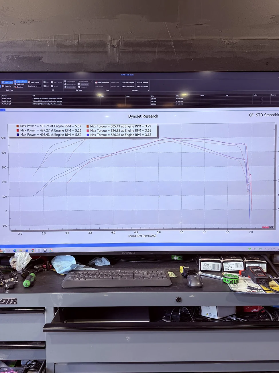

Did your tune do a modest tune to preserve the clutch? Or was this his best?
From tuner:
“Consistency, safety and repeatability are always the priority over peak power or glory numbers.”

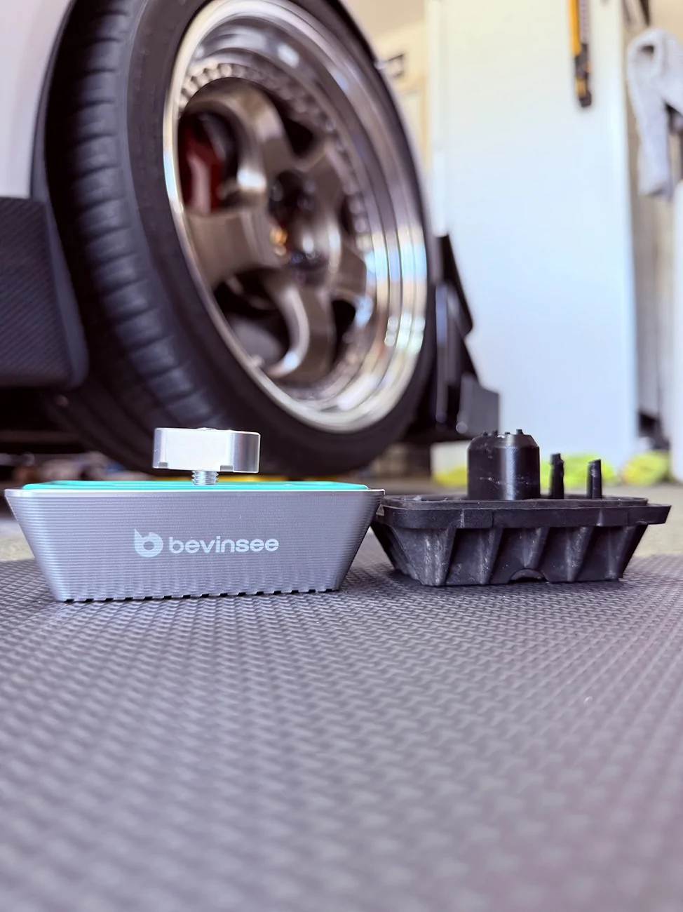

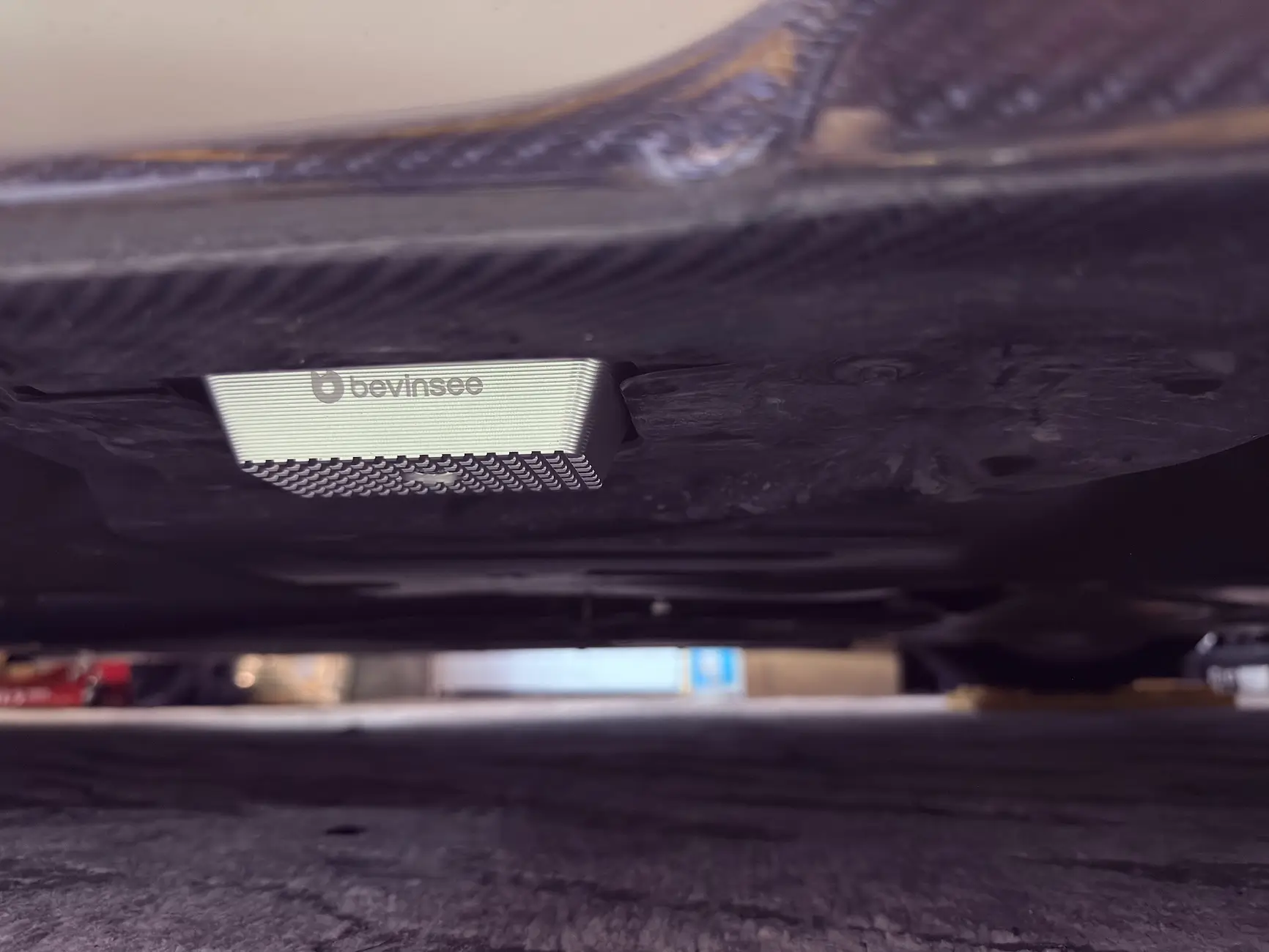

10.TKL
Jul 6, 2025
NA
2026 AT

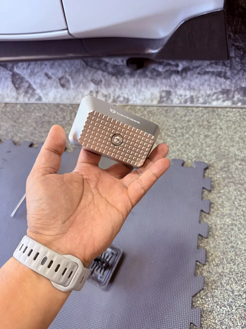

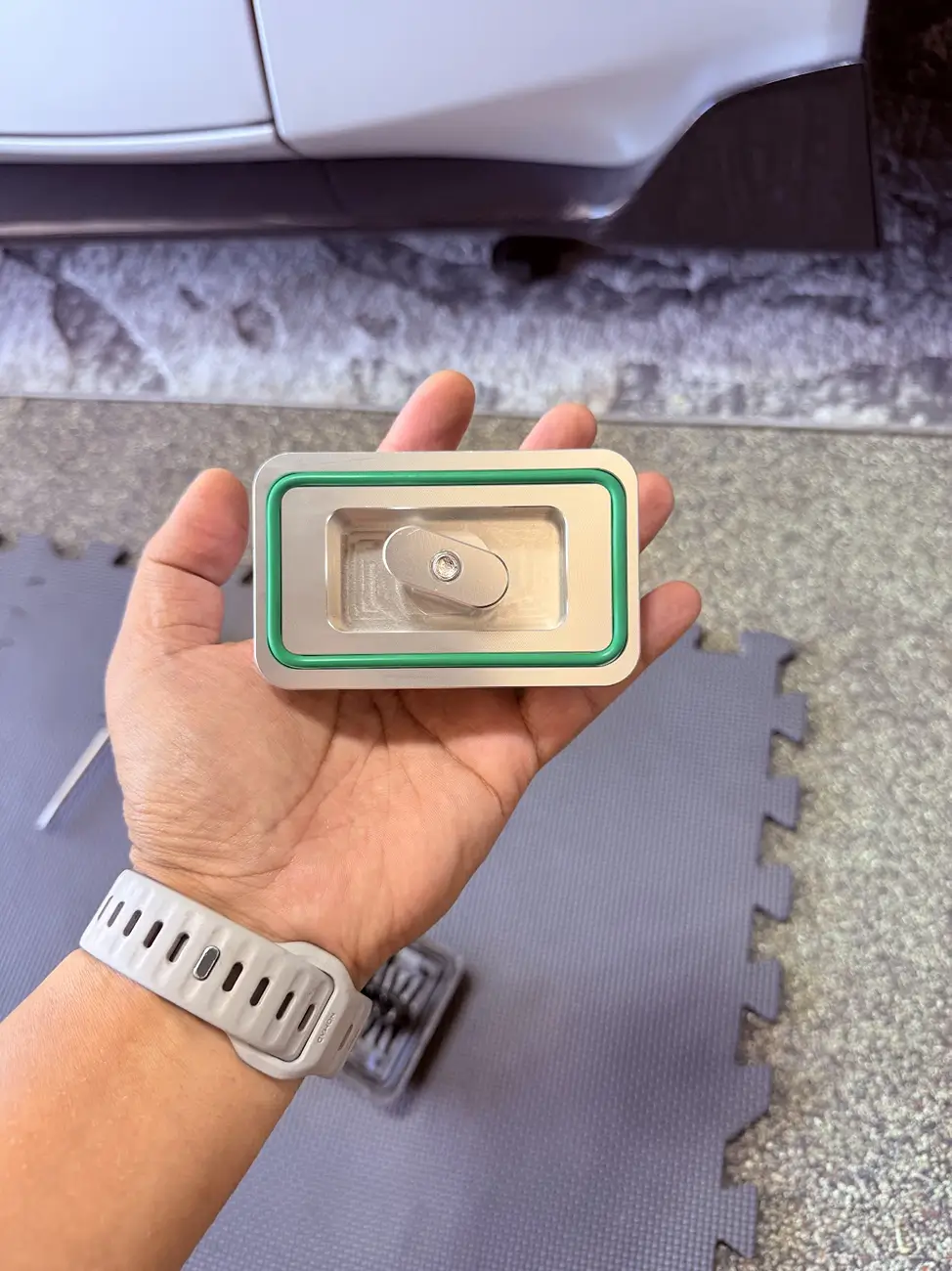

Do they scrape since they stick out a little more than stock?
i've got these bulkier (40mm height)ones and i do not scrape, tho im stock height. his version(31mm height) is 9mm thinner. i once hit a deep pot hole pulling into a parking lot and i think it actually saved me from damaging anything else. tho if you use jackstands these might not have a snug fit, i got some circular jackstands for them instead.(unless you're using multiple jacks to prop up the car lol).
RyanA90
RyanA90
Ryan
Aug 6, 2020
1,118
1,171
Fairfield, Ca
www.instagram.com
‘23 Supra A91-MT Burnout
They don't hang that much lower than oem, at most a quarter inch. I haven't scraped anything yet.
