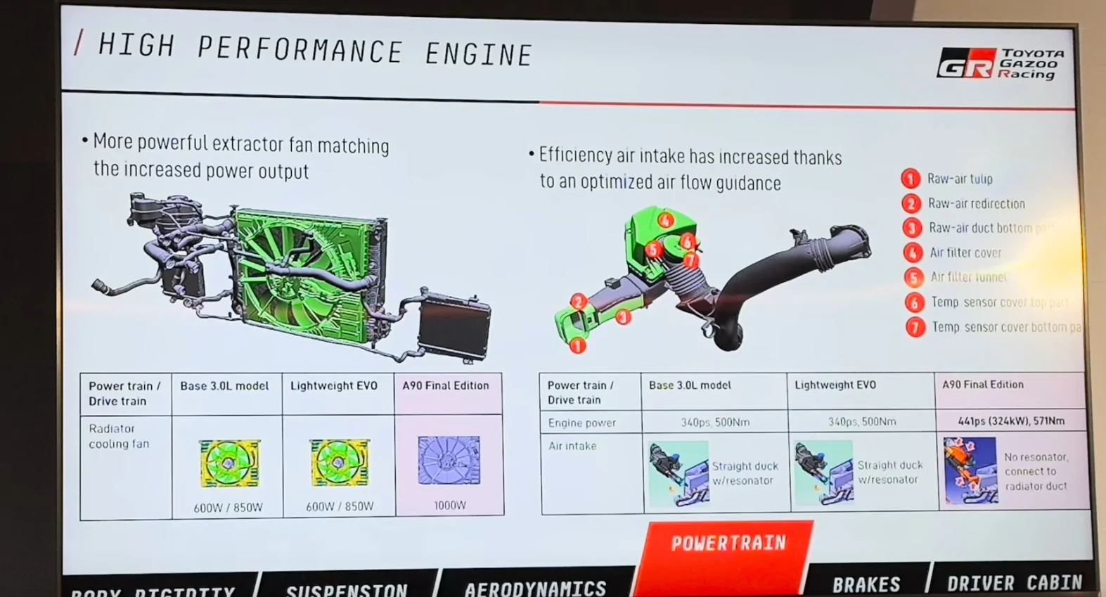

I’m reviving this thread because I’d also like to improve the engine cooling to reduce strain. Ideally, I’d like to install an intake manifold from DO88, since, as many have already mentioned, this seems to be the best solution for lowering or keeping the intake air temperature consistently low. However, there’s no way I could ever get such an intake manifold approved here in Germany.
The aftermarket radiators from CSF supposedly don’t really make much of a difference.
Do you think the larger radiator fan from the Final Edition (1000W instead of 600W) as well as the modified air intake would make a difference and fit the regular models? I know that the Final Edition also got an additional sub-radiator

The 1000w fan has been around for years. Available on M240/340/440 with cooling package and on G series M cars as standard. It bolts right in to the Supra.

Thanks for the quick reply. Do you think it would have a significant effect on the cooling, or is it not really worth mentioning?

That fan is only really effective up to 75 MPH, from my research the Verus Oil-to-Air + intake mani is the path to reliable heat management. That's the path im working through now.
