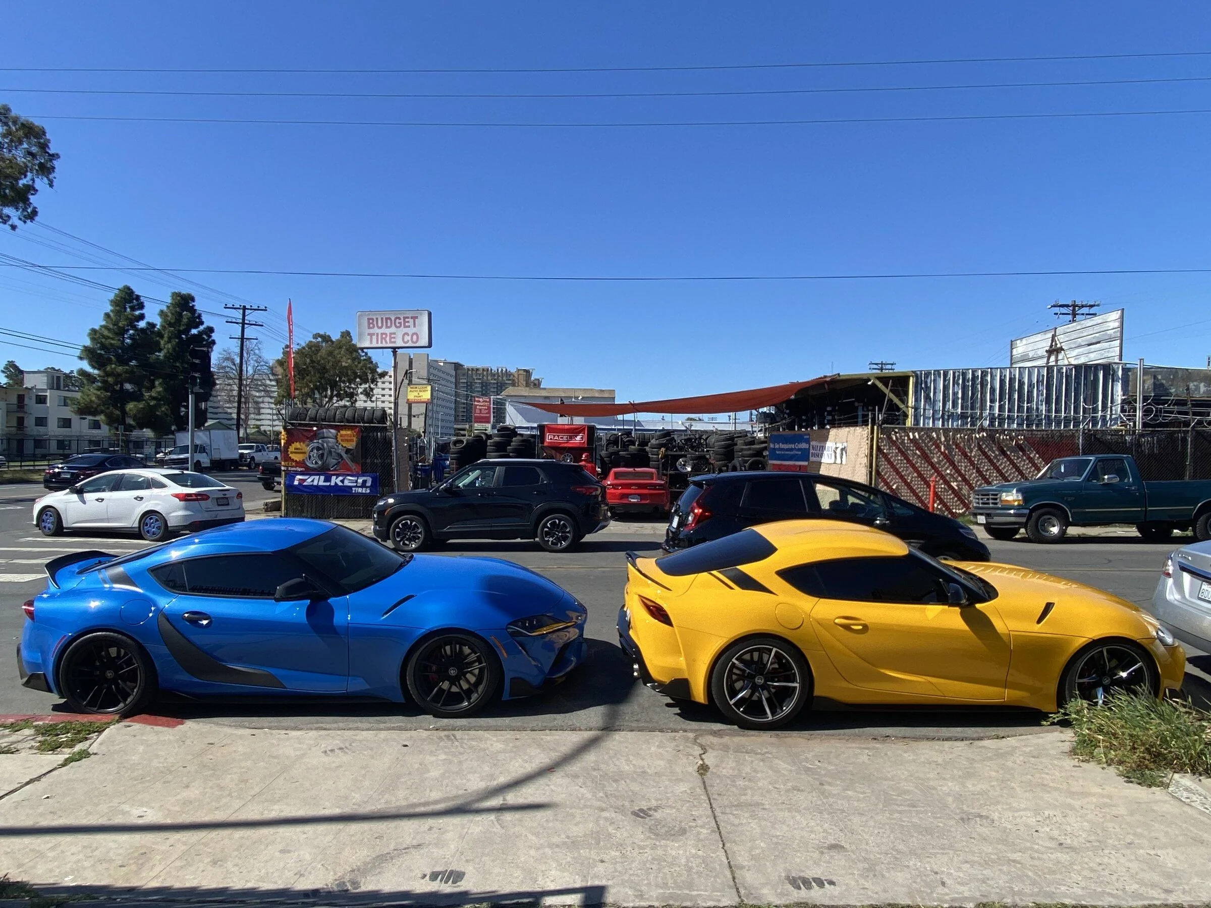

I am running the same setup with the same tires. Should be here tomorrow afternoon. From what I researched for hours, the 265 and 295 has no issues

I’ve had the rt660 265-35-19 295-35-19 on the car the last two days breaking the rubber in for my Ax event this Sunday. I’ve driven aggressively to test the setup and no issues or rub. This is on stock wheels and springs and no spacers. I’ll report back on original post linked above after event too. Rt660 are wider than the MP4S so you should have even more clearance.

There’s slight rub with 295 on rear with 18mm spacers on big dips in normal suspension mode. Source: my car.
