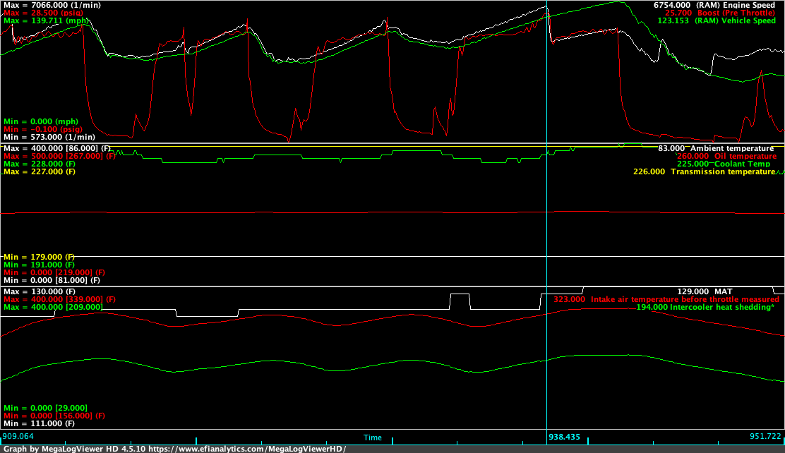

Last weekend I was at Las Vegas motorspeedway outside track. I shared my car with my brother for his first HPDE experience. There were 40 minute cool down periods between my group and his, and another 1.5 hours until I would start again. At this point in the data log, the car has had about 1.5hrs of track time. I was vigilant about taking cooldown laps and getting back onto the public road to get the car to cool down. The car was always reactive to cooling down fast. I have alarms set on my bm3 for oil (275F), coolant (230F) and trans (230F). I had the top down on my run and didn't even realize my temp alarms were going off during my run. I only noticed after checking the data logs. I'm a little surprised that the car doesn't give any errors with temps being so high.
I'm under the impression that the general conscious that auxiliary heat exchangers and radiator upgrades yield negligible changes. Obviously, these temps are unacceptable but is the only solution to just have longer cooldown periods? Oil is being sent out to blacklab for analysis.
https://www.bootmod3.net/log?id=661ac50b7347152440e4aa37

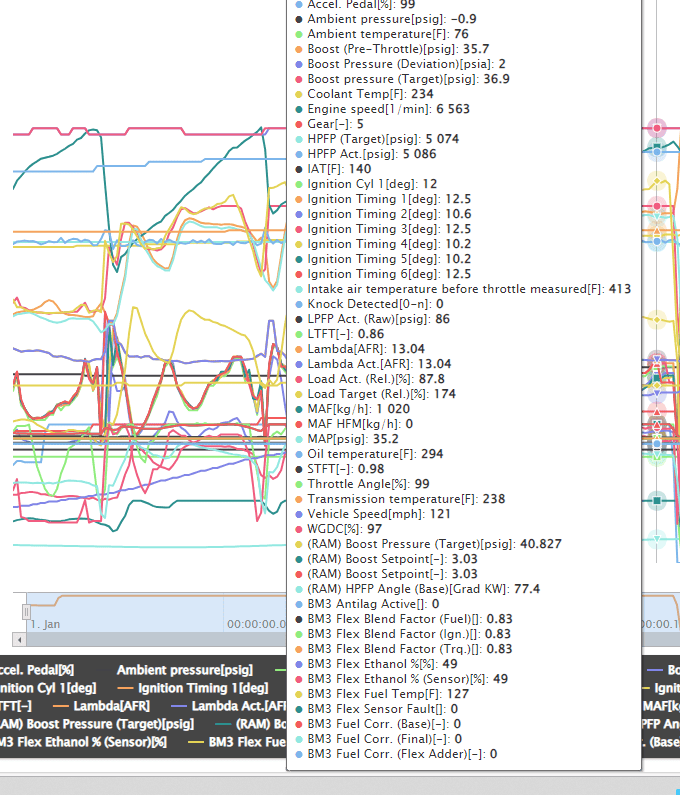

Too much boost on stock turbo with the OTS E50 mapping for track use. Heats everything up a ton.
looks like around 21 psi at 6500 rpm. Stock turbo is a hair dryer at that point.
Car is def pulling timing at 140f IAT
I was thinking more ethanol, the cooler the combustion temps but I guess the stock turbo is just out of the efficiency range at this point. Even though IAT's are high, I am impressed how much the wagner is able to bring down the temps from the pre-throttle measurement.
As far as solutions go, it sounds like running less ethanol or a larger turbo seems to be the direction?

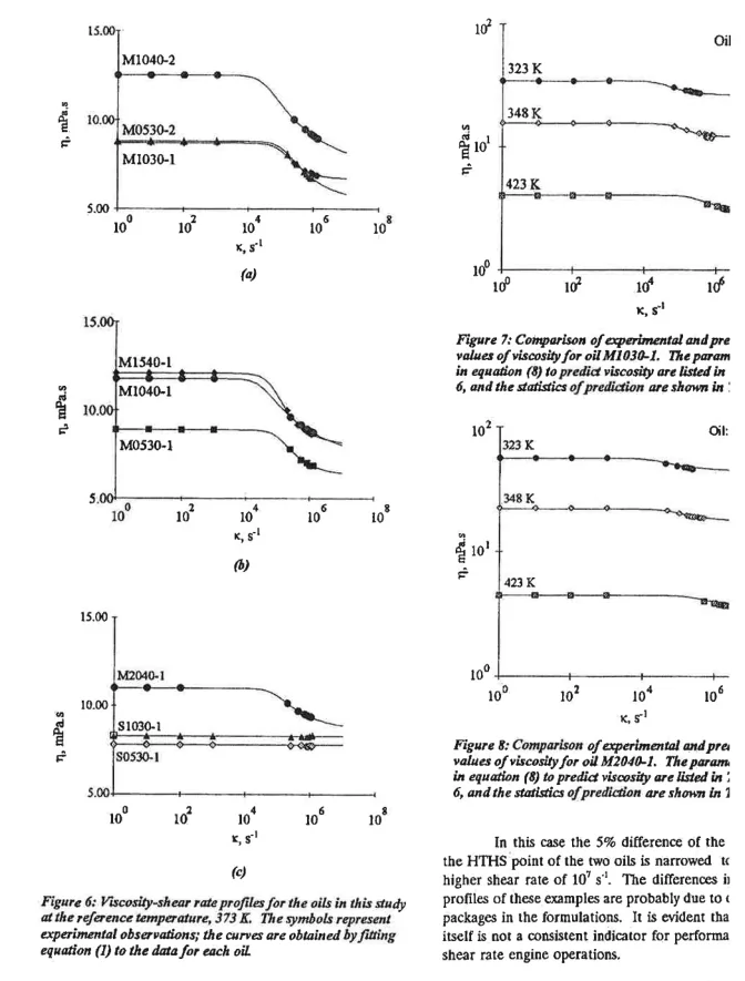

I'm still trying to read all the info in that thread and I started at the beginning about a week ago lol. While I see these engines running hot but cooling down pretty fast, there have been mixed information about oil temp thresholds. Some have said synthetic oils begin sheering and breaking down at 270F, but others have said they're good for 300+F.
i3igpete
May 16, 2022
315
249
Chicago
2023 3.0L 8AT

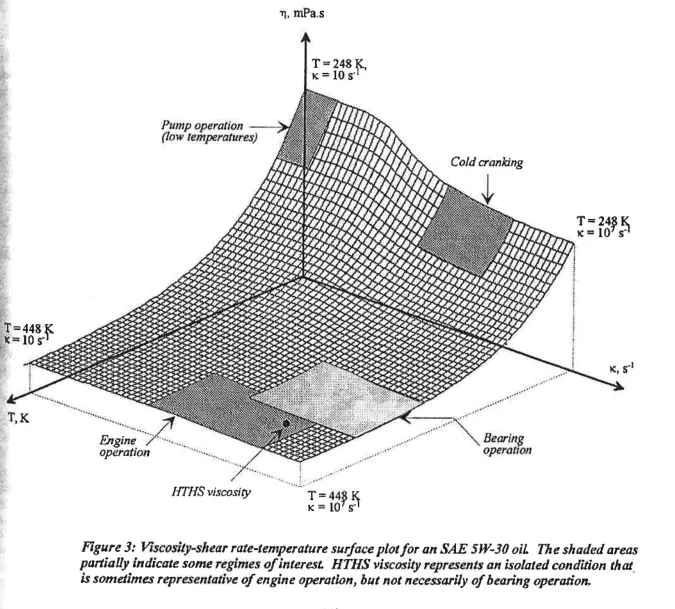

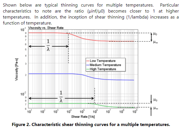

So, I probably know more about oils than I care to talk about, but it general, all oils are LESS sensitive to shear strain rate at high temperatures than low temperature. Consider figure 8, on a logarithmic Y-axis, the 323K drop is larger in magnitude than the 423K drop.
Beyond that, some synthetics are resistant to shear-thinning dependency (see fig 6, s0530-1) but this is not true of all synthetics. Note that this is dynamic shear, not the same as aging shear.
Taken from J.Sorab (1993). full text: https://www.sae.org/publications/technical-papers/content/932833/:
Some guidelines I wrote:

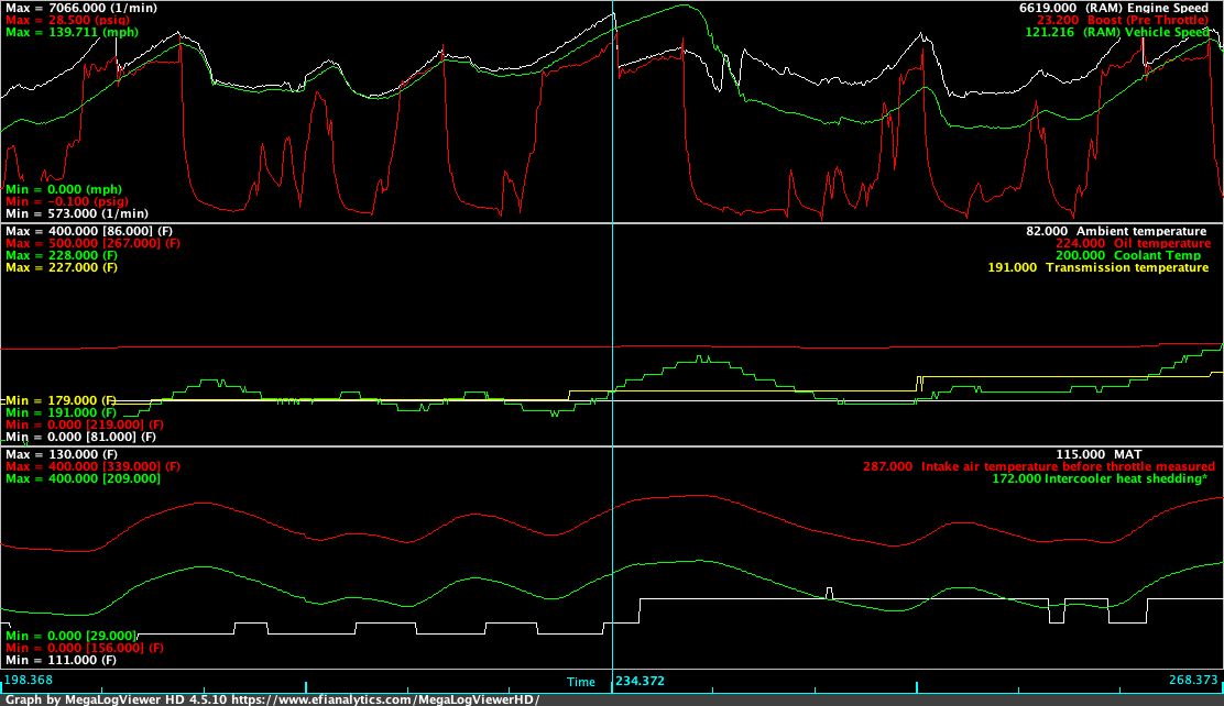

I went larger turbo mainly for efficiency reasons. It creates way less heat than cranking the boost up on the oem turbo.
I created a virtue channel in my log viewer tool which shows how much heat my wagner manifold sheds from the intake charge. It's satisfying to see it sheds A LOT of heat from the intake charge. In some instances, it sheds more than 200F!
Here is an example of that. Also, this log is from a 15 lap session in around 83F ambient temps. You can see I have much less oil temps and actually all my temps aren't too crazy.
All coolers are OEM except for the Wagner intake manifold.
Start of session and then 15 laps in:
15 laps in:

Yes but ethanol can only do so much cooling. Yes, the wagner manifold works really well. Imagine what your IAT's would be without it!
15 laps in:
