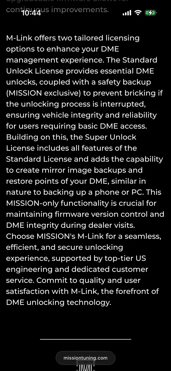

I did the unlock last night using m-link. Very straight forward (although the dme connectors are a pain to get out and out in if you are prone to stress lol). I can confirm that this is an at home unlock.
this was done on a 2024 mt, and I purchased the super license m-link package. I flashed mhd onto the car afterwards. The unlock itself takes about 15 seconds to complete and is a series of pressing two buttons. Super easy. I was also able to back up an image of my dme prior to unlocking in case I need to go back for any reason.
it’s a little expensive compared to other offerings atm, but being able to do this at home and re-unlock in case it gets locked again is nice peace of mind.
car is fast af now would recommend lol

Yep as far as I can see you can ā€œrelockā€ by going back to the backed up dme image.
I paid $500 for mlink. There’s also an option without the advanced backup (no relocking I think?) for $350. With that option you can unlock multiple times though. This is how they describe the two options

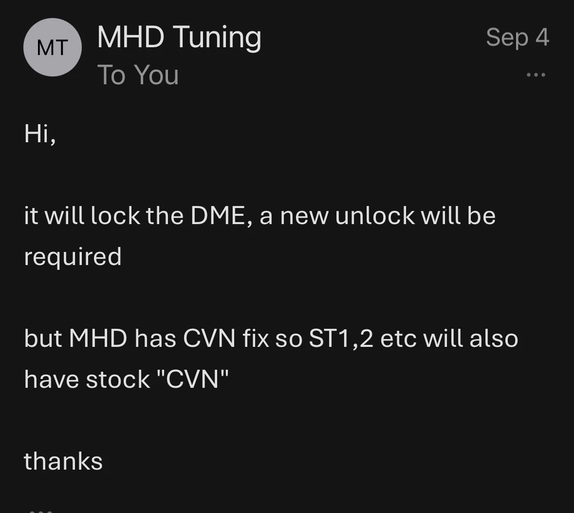

Anyone have an answer yet for whether MHD ā€œflash back to stockā€ reinstates the OEM Cal ID/CVN? I got my ECU unlocked at a local shop and didn’t realize Cali smog checks DME’s lol. Will I have to have Toyota flash it back in a couple years or what? According to ChatGPT it shows my factory software codes but I don’t know if thats correct
I asked MHD and this was their response, which I think it means yes it will be OEM cal ID and CVN, but their English isn’t great so I’m not sure

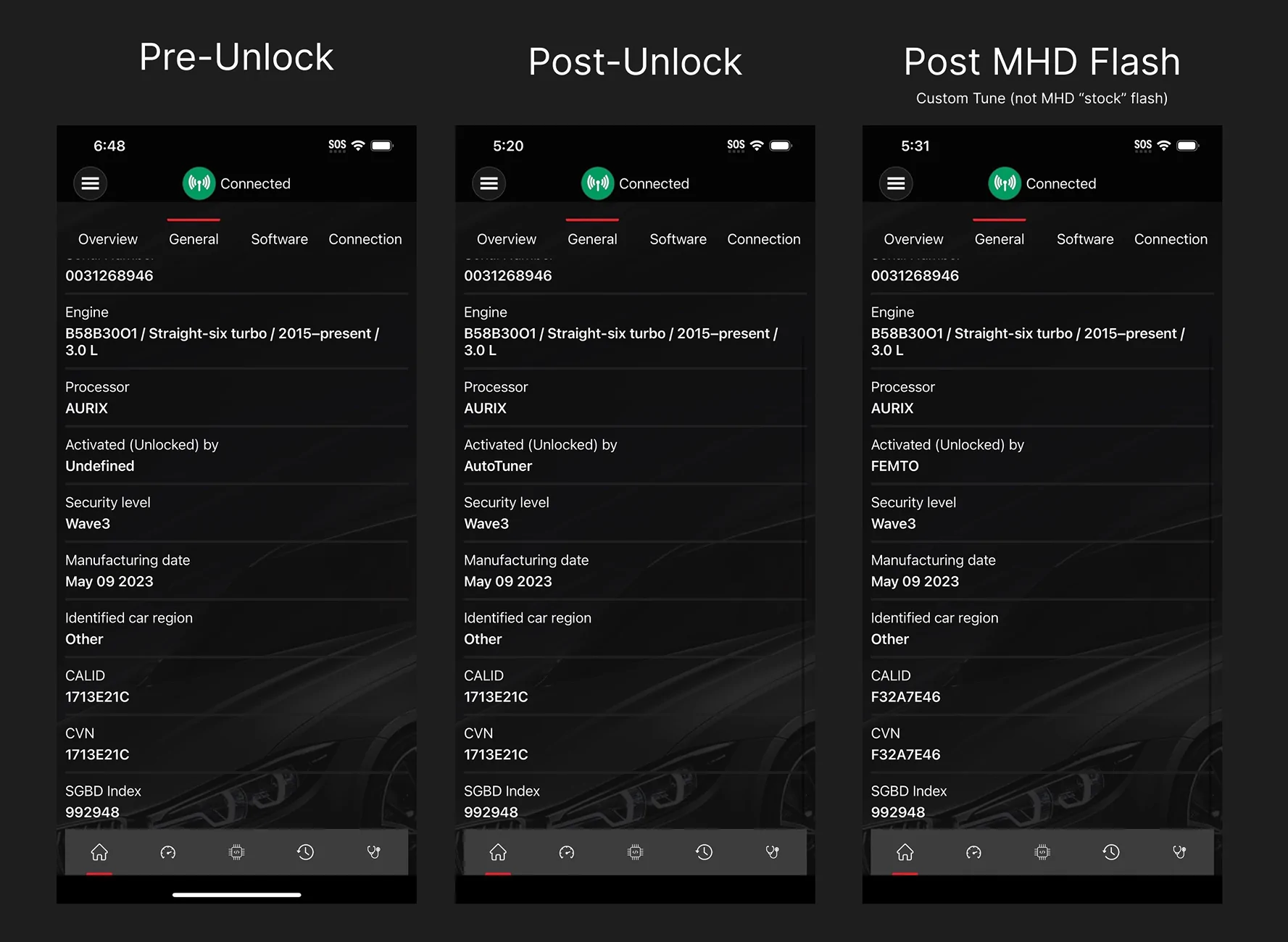

That is absolutely untrue that MHD has a "CVN fix" and flashing with MHD will retain stock CVN, easily proven by just looking at the CVN before/after:
