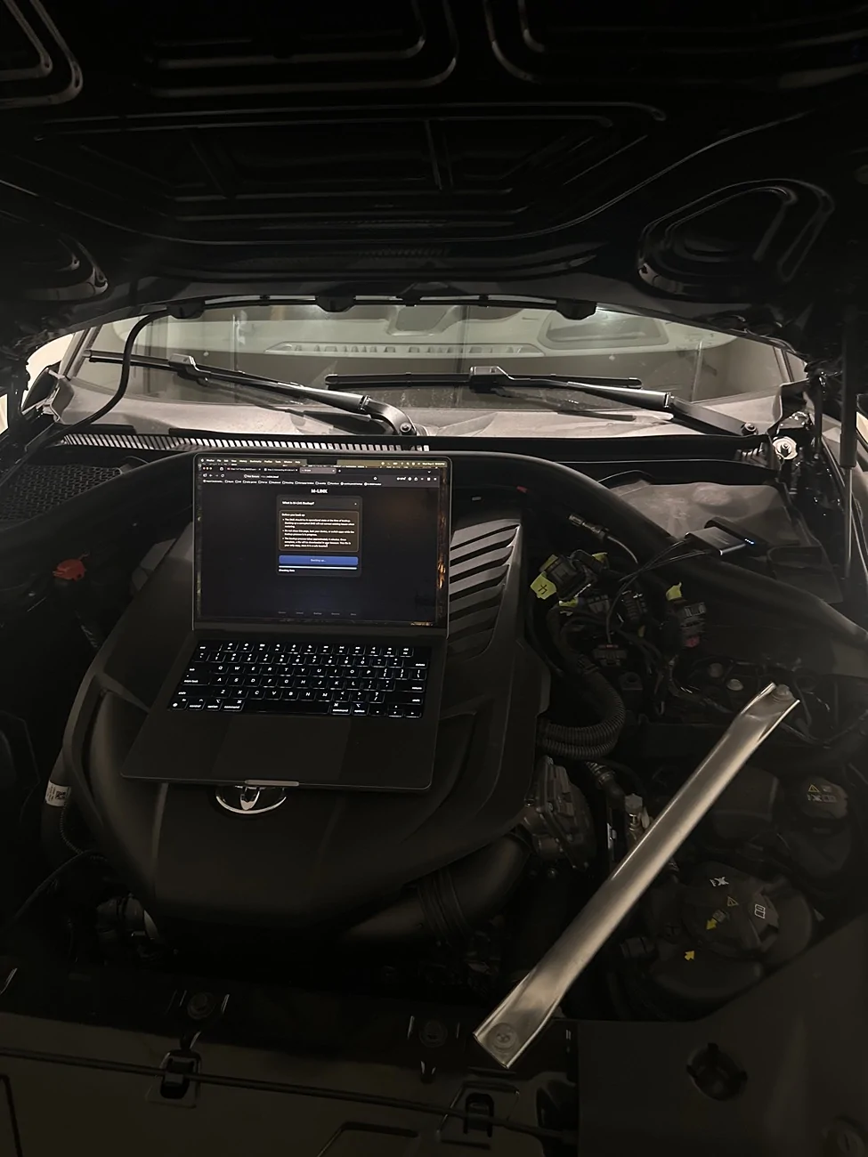

I did the unlock last night using m-link. Very straight forward (although the dme connectors are a pain to get out and out in if you are prone to stress lol). I can confirm that this is an at home unlock.
this was done on a 2024 mt, and I purchased the super license m-link package. I flashed mhd onto the car afterwards. The unlock itself takes about 15 seconds to complete and is a series of pressing two buttons. Super easy. I was also able to back up an image of my dme prior to unlocking in case I need to go back for any reason.
it’s a little expensive compared to other offerings atm, but being able to do this at home and re-unlock in case it gets locked again is nice peace of mind.
car is fast af now would recommend lol
