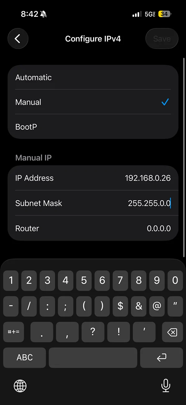

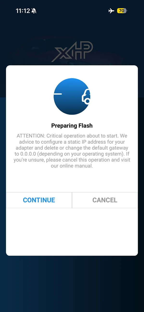

i just got an xhp transmission tune but am running into issues when trying to flash. it fails halfway through and it won’t even complete the process to undo the flash. so my car is now stuck. it gives me this message before i flash. i go into my wifi settings to change this in my adapter but it won’t let me save. can anyone tell me if im putting in the numbers wrong or maybe where specifically in what slot they go in.

i’ve done eveything right. connected to my adapter. seatbelt/dogionistic mode/airplane mode with no bluetooth on. but it never seems to work. not sure if i have to edit the settings of the adapter manually (which i’ve tried but it doesn’t let me save the settings for it). so i’m at a lost. and the adapter is a bm3 one which works with xhp

i will try to put the 0.0.0.0 in the router spot but i swear i tried it and didn’t let me save the settings. but if any other advice let me know. will try later tonight

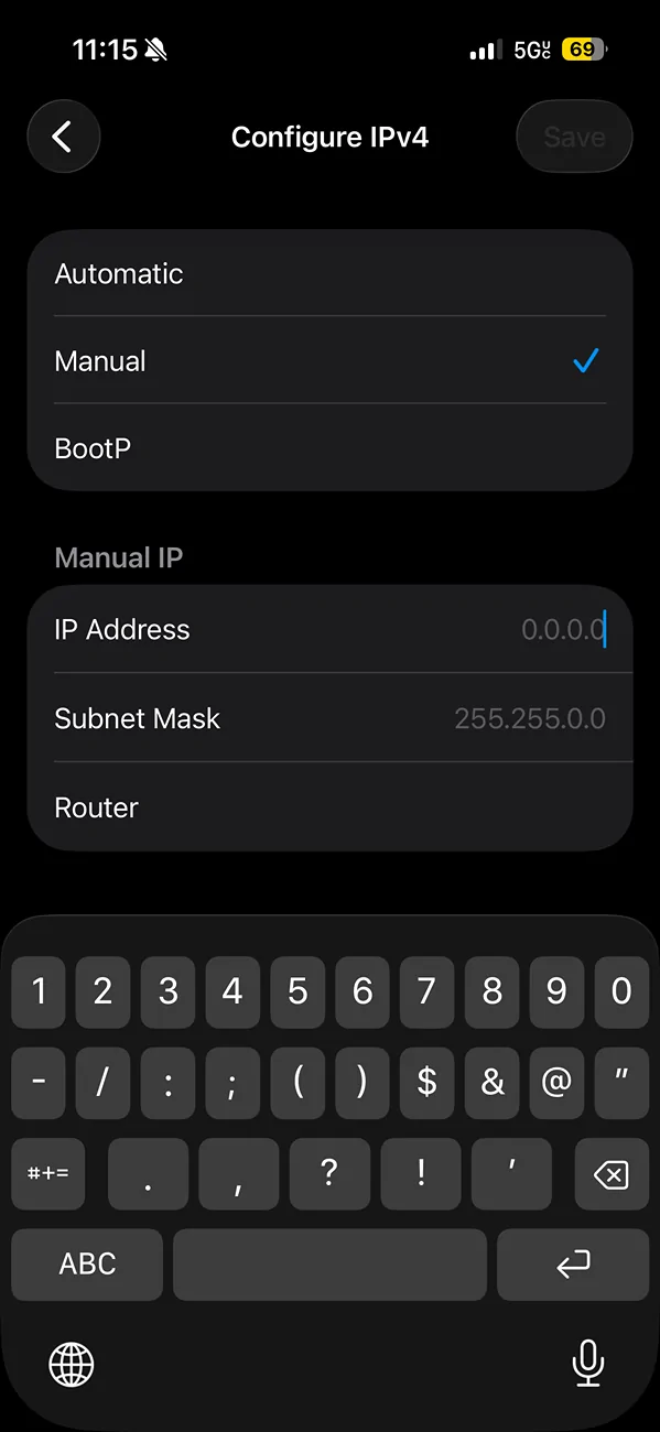

when trying to enter 0.0.0.0 like the app tells me to the save button turns grey and i can’t press it. so not sure how to change it like it’s asking me too

okay finally got it to work. i did not listen to all the instructions for it to work. i only turned off bluetooth. left cellular service on and did not turn on airplane mode. i didn't edit any of the wifi adapters settings like it told me to. went into diagnostics mode and flash went until about 80% finished and then i got a text message and the flash failed. i tried it again after that with no text message interruption and it went through. i didn't this time after time today so not sure why this time it was different. i know for a fact that my cellular service was off all the other times i tried and it failed, but when left on it worked somehow
