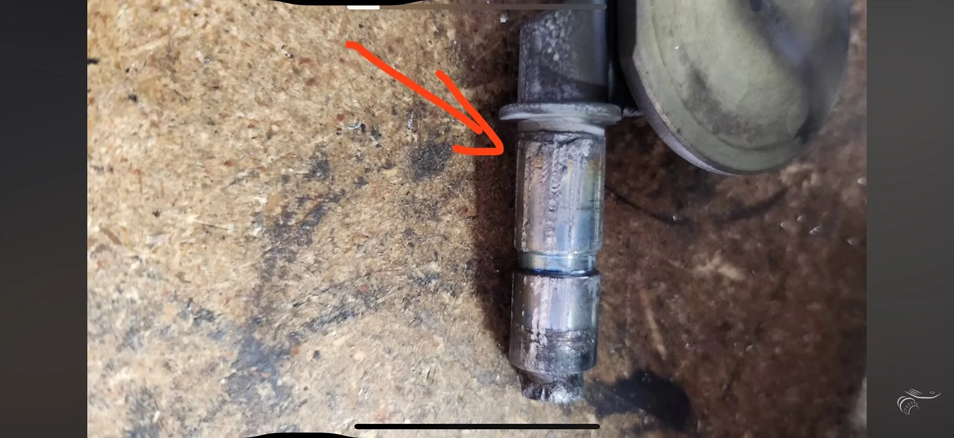

Can you move the wastegate flapper with your hand? I can't remember if you did that or not. It could be as simple as a mis-calibrated Wastegate Actuator.
Haven't even tried. This is a vid from the 1st time around. Almost certain it's the same issue....

Yeah, this is very similar to that video I posted a few months back about @kern417 having this issue. The following videos are just snippets from his post with the 1st one showing a proper working waste gate vs what was wrong with his. The photo shows it looks like the waste gate shaft was marred and caused binding.
Every time you start your car, you the waste gate does a verification. It should go from fully closed to fully open, and you should be able to watch this happen every time you turn it on. When it fails, you get the “electronic waste gate stopped learning”.

OP, just one thing I recommend I did for peace of mind, is spray some lubricant in the joint and cycle it in the wastegate a few times before install to spread it around. helps keep anything from getting in there and keeps it moving smoothly.
no, it shouldn't be necessary. but i saw it on another forum and figured why not. the graphite can handle the heat etc so seemed like some cheap insurance. my issue popped up at my first track day after install during the 1st full session, and i've done several track days since with no issues.
