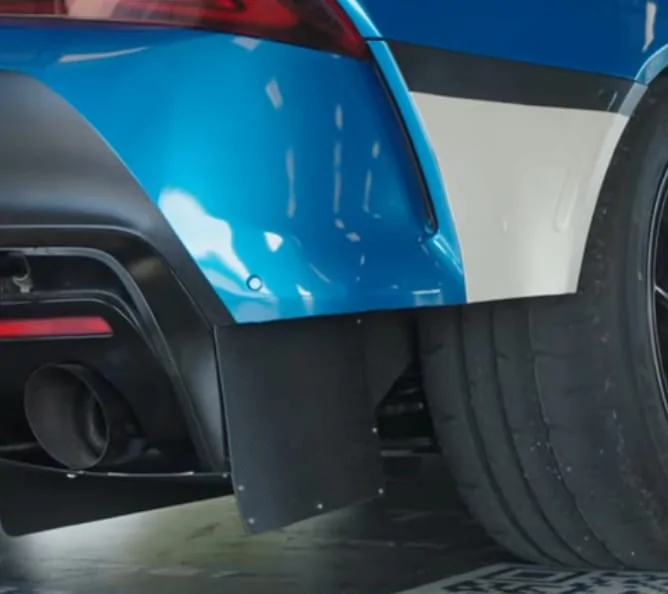

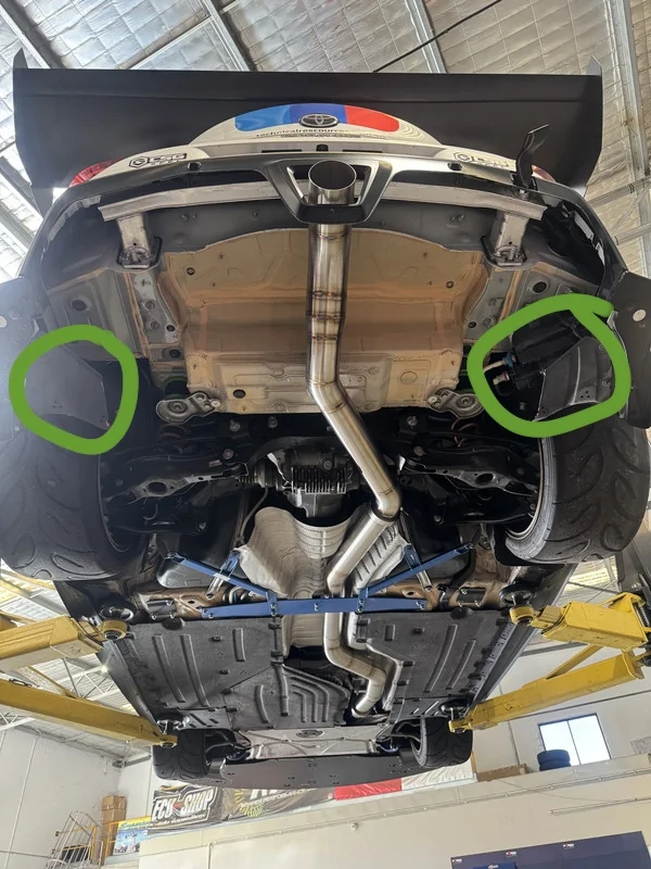

We looked into cutting the rear bumper, but err what do about the EVAP canister?
What part do you want to cut?
Mine is cut for a diffuser and I still have the canister?
I assume he wants to cut this and then build a tire wall against the diffuser, similar to what Jackie ding did to relieve tire wake.
Start at 4:00
Jackie and Paul from verus discuss it in this video here around 31:30. The take away is don't bother to do anything fancy with that air. It's so dirty, the most important thing is to get it away from the tire as quickly as possible
Pretty much what i3igpete said.
Here's another shot from another car

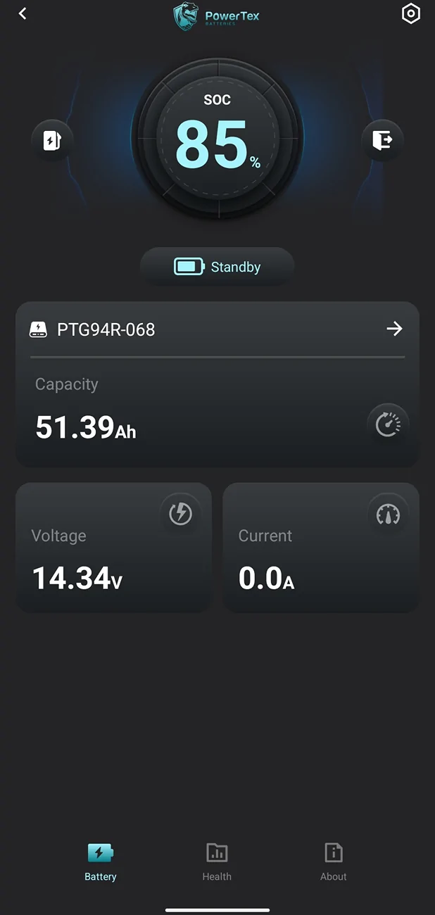

My replacement LiFePO4 battery is in. This was was shipped directly from the manufacturer in China. Came with a SOC of 85% this time.
Considering what happened the last time, and how hard (and expensive) it is to get a LiFePO4 battery here, i'm quite paranoid....
Is 85% SOC good enough to use, or do i have to bring it 100% before using it?

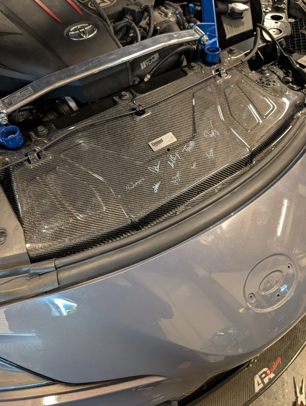

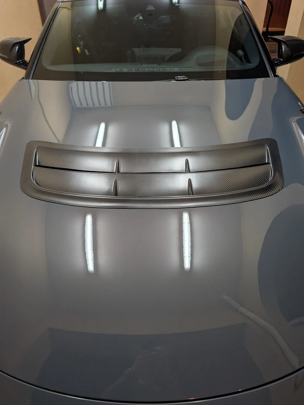

Looks like everything started to come together the evening before race day, thanks in large part to the shop. New OEM parts got painted. Vents back onto the new hood, including the new CF 777 one.
Cooling plate got a clear cat
Are was still a bit messy here, but that do88 intake is just hnnnnng
Reservoirs tucked nicely on either side back here. At some point will get longer lines to extend them a bit more towards the center

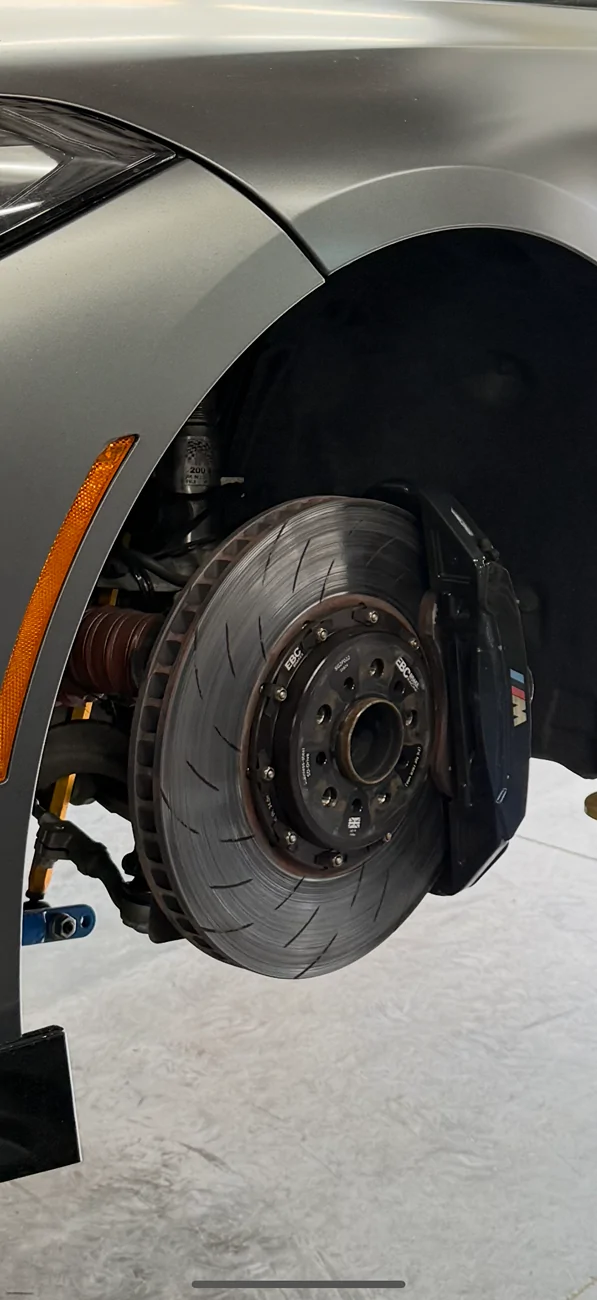

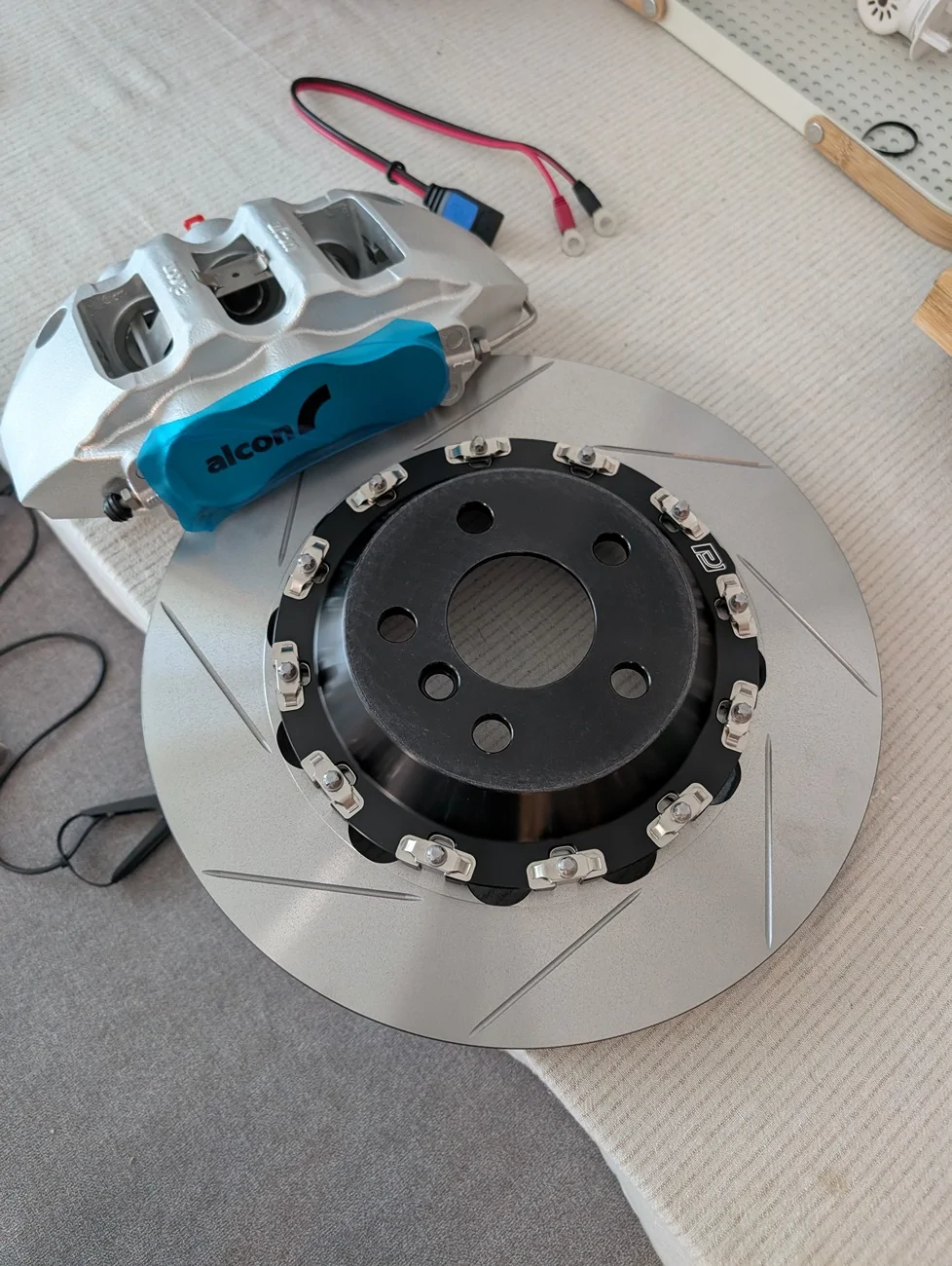

Alcon BBK is in. Didn't install it, for a couple or reasons. First and most importantly, my existing racer 999 pads are brad new with just 1 lap done. So i'd really like to get my money's worth first. Second, i want to paint them blue first before putting them on
Z4m40i

2020 BMW z4 m40i, 2020 BMW X7 40i
Have you looked at doing nickel plating instead? Powder coat turns to ass when you’re braking as hard as you should on track.
I haven't no, but now i will. Not really an area i know too much about. Also, the plan wasn't to powder coat but to paint. Reason being is that these are new calipers, and i don't want to disassemble them at this point, which i'd have to. Paint is less durable, but it much easier to touch up, and doesn't need caliper disassembly. That's been my thought process, and then to look into power coating once i need to service the calipers.
edit: your rotors looks so damn good

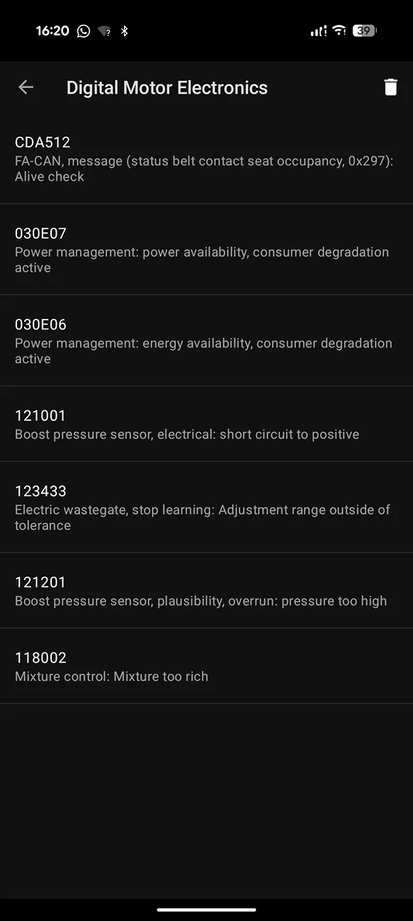

General update:
So it seems the turbo shit the bed again. The fix either didn't work, or whatever was causing the issue is still persistent. At this point i'm quite upset at all of this, because i'm spending more time chasing my tail than moving forward. Doesn't help that i've failed to log using BM3 quite a few times....I don't know how much of this was the wastegate and how much of it was tune, but my partial throttle was garbage. It was so hard to power out of corners. I think it's a little bit of both.
I'm going to err on the side of caution by taking 2 measures
1) not going to fix or replace the jammed flapper again. I'm changing the entire turbo. Itwould've taken too much time to get my hands on another pure800 turbo, so i've placed an order for a DAW Ultra Flow X. Similar spec (62mm) as the Pure800.
2) changing my tune, and moving from using methanol as a power adder to using it exclusively for cooling. Open to suggestions as well. I did reach out to Bend Calibration as a plan b, but they don't do BM3, and at this point i think i'm married to it because i've already picked up the rev2 controller for a little bit later down the line when i go PI.
Other than that the car is a monster. I was only able to do 6 laps out of my allocated 20 before i lost all boost, and i wasn't pushing too hard in that first session because i was still familiarizing myself with that specific layout. Despite only doing 6 laps at 85%, and not having any partial throttle, i still placed 2nd in a very competitive class with much better drivers. The car is just that good.

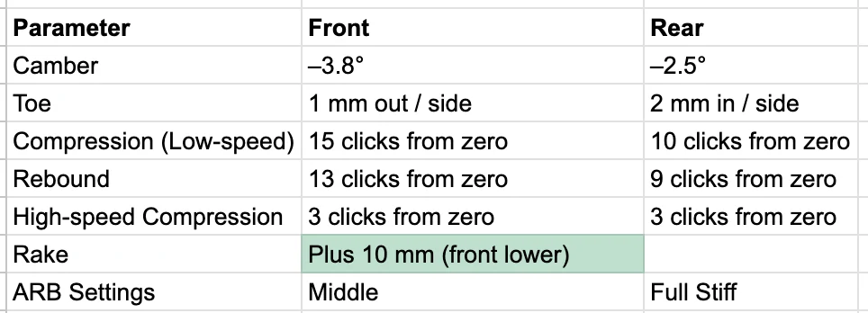

I was getting a bit of understeer on mid-slow corners. Part of that was because i was carrying a bit more speed than i should've to compensate for not being able to throttle out of corners the way i wanted to, and part of that is def setup related. Here's my current setup, and my proposed plan to remedy the slow-mid corner understeer:
First thing i'm going to try is to reduce the rear sway from full stiff to the middle setting. Will see how that feels. If the issue persists, i'm going to change my front low speed compression from 15 clicks from zero to maybe about 17 clicks (26 clicks total). 3rd adjustment from there would be to stiffen rear low speed compression from 10 clicks from zero to 8 clicks from zero.
This is my first 3 way setup, so it's going to be quite the steep (and bumpy) learning curve for me.

Did you have any codes when it stopped making boost? It's a little frustrating seeing you have all these issues, then just guess at things. Then you have a bunch of people with experience giving you input and it seems to always just turn into an argument.

Keep in mind that the issue the wastegate/flapper issue was likely there from the start of the session and just progressively got worse. Would make total sense as to why my partial throttle was so bad. Right before everything went to shit I glanced at my canchecked and noticed that I overboosted to 43psi.
Yeah I heard about the DAW guy
Yeah I did pull some codes.
8,810
17,286
Can you move the wastegate flapper with your hand? I can't remember if you did that or not. It could be as simple as a mis-calibrated Wastegate Actuator.
