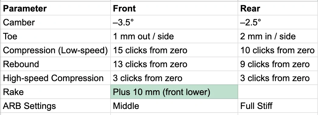

Alignment and suspension setup starting point. Would love to hear thoughts
What i'm still not 100% settled on:
1- might increase front camber just a bit as the starting point. 3.6 or 3.7.
2- considering reducing rear toe just a tiny bit for better rotation. Maybe from 2 to 1.75

Mo camber in front.
aye. I'm currently at -3.4. Considered starting at -3.6 or -3.7. Perhaps -3.8 at most....because it's a starting point and i'll be realigning very often.

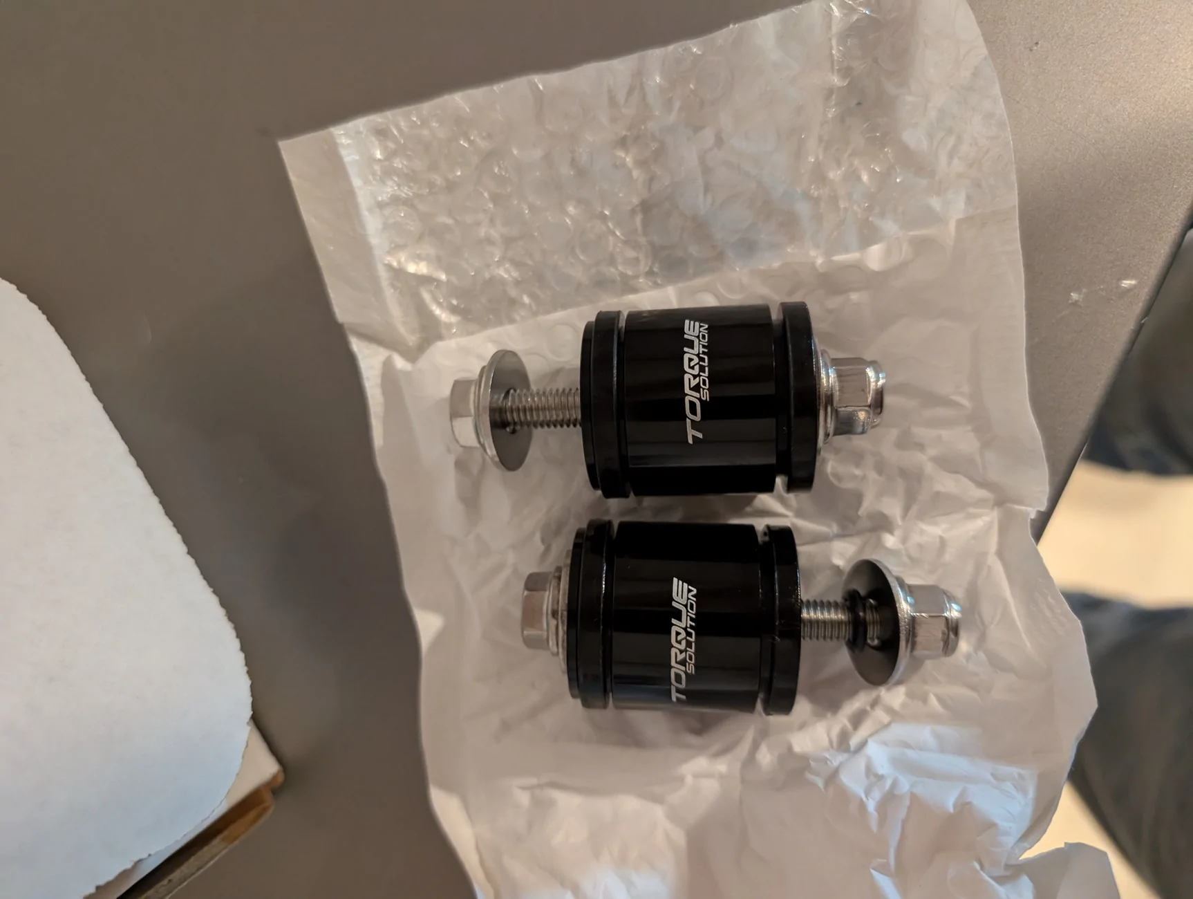

- It seems my "street" powerflex trans bushings cracked. 600+whp and a stage 3 trans tune i guess. Torque Solutions billet trans mounts on order

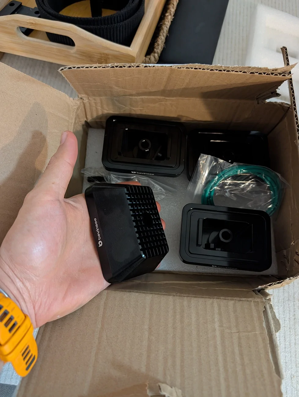

These also came in to replaced my cracked powerflex rubber ones. Torque Solutions always worked for me in the Subaru days.
These billet aluminum pieces also came in to replace the OEM plastic ones. Don't like the Verus ones. Aside from the fact that they're too expensive, i don't like the fact that they force you to use a specific type of jack stand.

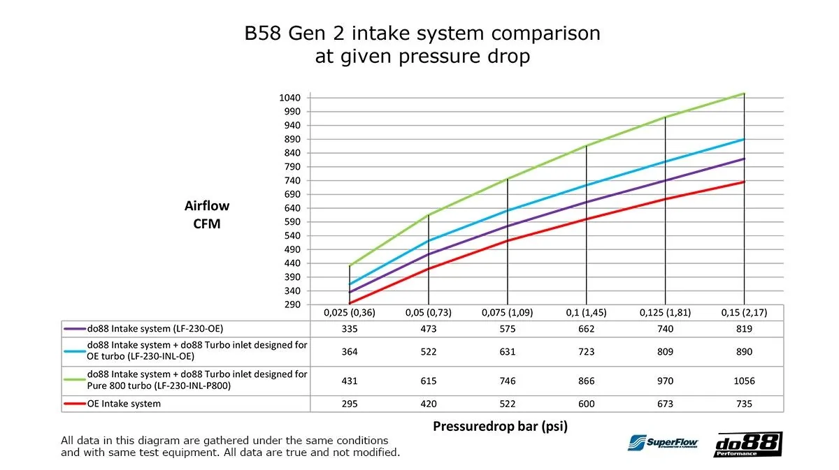

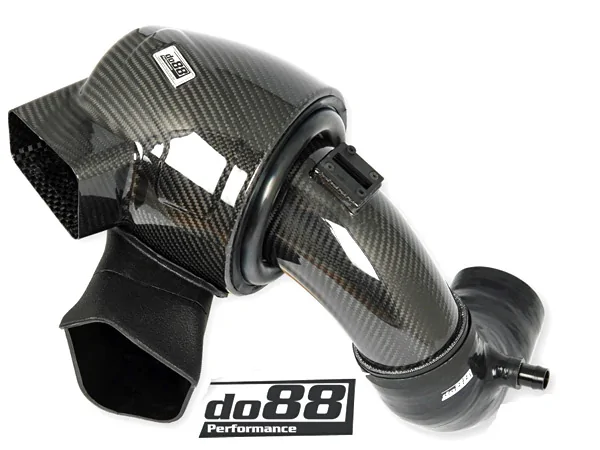

The new intake should arrive tomorrow. Moving from open to closed box. do88, which imo makes great quality stuff. You also have the option to spec a pure800 specific turbo inlet, which is great. Not cheap, but great quality stuff.
Silly manufacturer CFM / Pressure Drop data

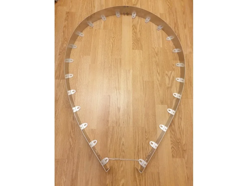

The downside of course is that they take forever to make. But that's fine. My APR splitter is decent for now. But i need to install an air dam ASAP because the gap between the splitter and the bumper is def not doing me any favors. So i have one of these universal ones on the way

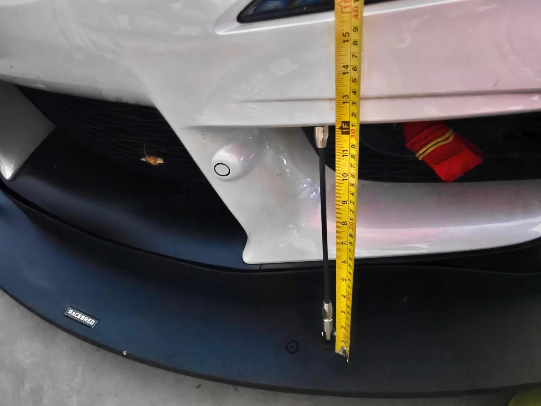

Suggest buying the professional awesome support rods now (2x critical, but 4x recommended) and tossing the cables immediately into the garbage. Get the fancy bottom (standard will dig into the wood) and standard top (fancy will be tricky to fit on the crash bar).
Use a round wooden dowel for test fitting before you cut the carbon rod
Thanks for the tip. I was actually just browsing the professional awesome site earlier today for some skid blocks.
Didn't know the cables were that bad.
2 fancy, 2 standard. Err what size rods?

All 18 inches. Keep in mind the ends add another 2 inches on each side, so that's plenty of length.
Thanks. The car is at the shop so couldn't even eyeball it. I was thinking it was close and might be worth getting the middle length ones and shorten them. But yer 18 looks like plenty. Thanks!
Any particular reason you have that rod set up like that rather than how Racebred recommend? I believe the middle ones attach just behind the lower bar. Seems like plenty of leverage as it's just about the middle of the splitter. Just preference?
Considering how long it takes to get a replacement blade, i'm also going to err on the side of caution and run 4 skid blocks across the front.
