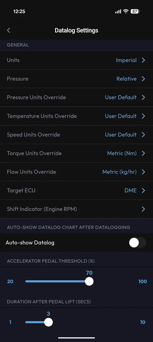

bootmod3 logging can be shitty. Sometimes the refresh rates get really really slow, sometimes i lose connection. Shut down the app, cycle your WiFi, unplug/plug your dongle.
not sure if you adjusted the logging thresholds, but you can go to
Menu-> dashboard -> configure dashboard -> data log settings -> scroll to the bottom.

Yeah i think i'm good on the setting front. I think the fact that it's logging 1-3 seconds indicates that there's some kind of interference happening. I've tried restarting etc.. all that. I dunno could be android auto maybe trying to connect to my phone or something.

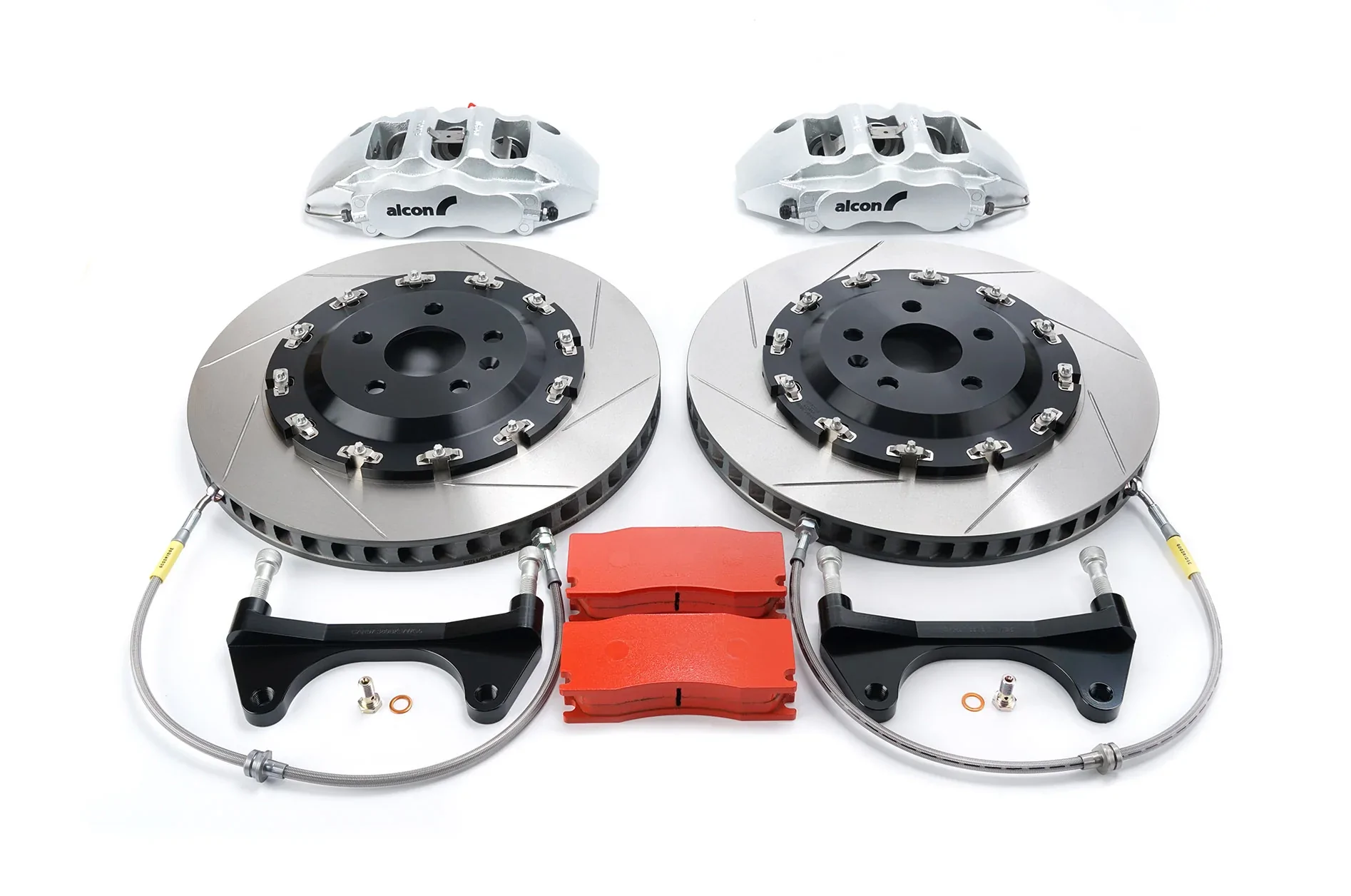

This is the Alcon BBK i have on order. The 6 piston Alcon calipers weigh about 2lbs less than the OEM ones. The rotors are 8lbs less each than the already decently lightweight Paragon rotors i currently have on. So that's a cool 20lbs dropped off of my current setup. I believe the OEM rotors weight 28.1lbs each, so the difference between this setup and OEM would be around 26lbs in total.
Made to order. Will be a 4-5 week wait
Will be running the Winmax R7 pads

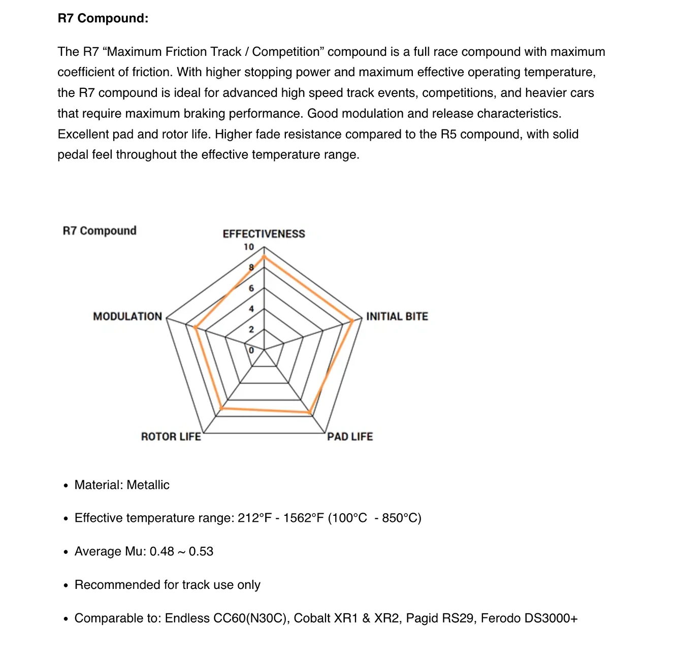

Be interested to see what you think of the Winmax R7 / Paragon R7. I have yet to meet someone that had a good review of them.
Will share my thoughts
For now, i've just run through a set of Project Mu club racers. Not bad, not bad at all. They're clearly meant for lighter cars, but for the $$, not much to complain about. They didn't trash my rotors either, and initial bite was better than expected.
I've just replaced them with Project Mu Racing999, so the more aggressive pad. Let's see how that goes. I'd love for these to last until the BBK comes in. Have track days/races on the 1st, 3rd, 11th, 15th, 22nd and 30th of November.
Edit: i didn't intentionally go for the Winmax R7 pads....the BBK comes with a set of pads and i chose the most aggressive Winmax ones
Are they the calipers that take 25mm thick pads? If so, it looks like the same kit I'm running. But I use Ferodo DS3.12 in the front and DS2500 rear.
No I don't think this is the same kit as yours. I prioritized lightness, while still improving overall braking, just not by as much as if I had gone with a bigger set. So my rotors aren't massive by any means (355mm), and the calipers take a large but not so thick pad. Can't remember the thickness but was either 18mm or 20mm

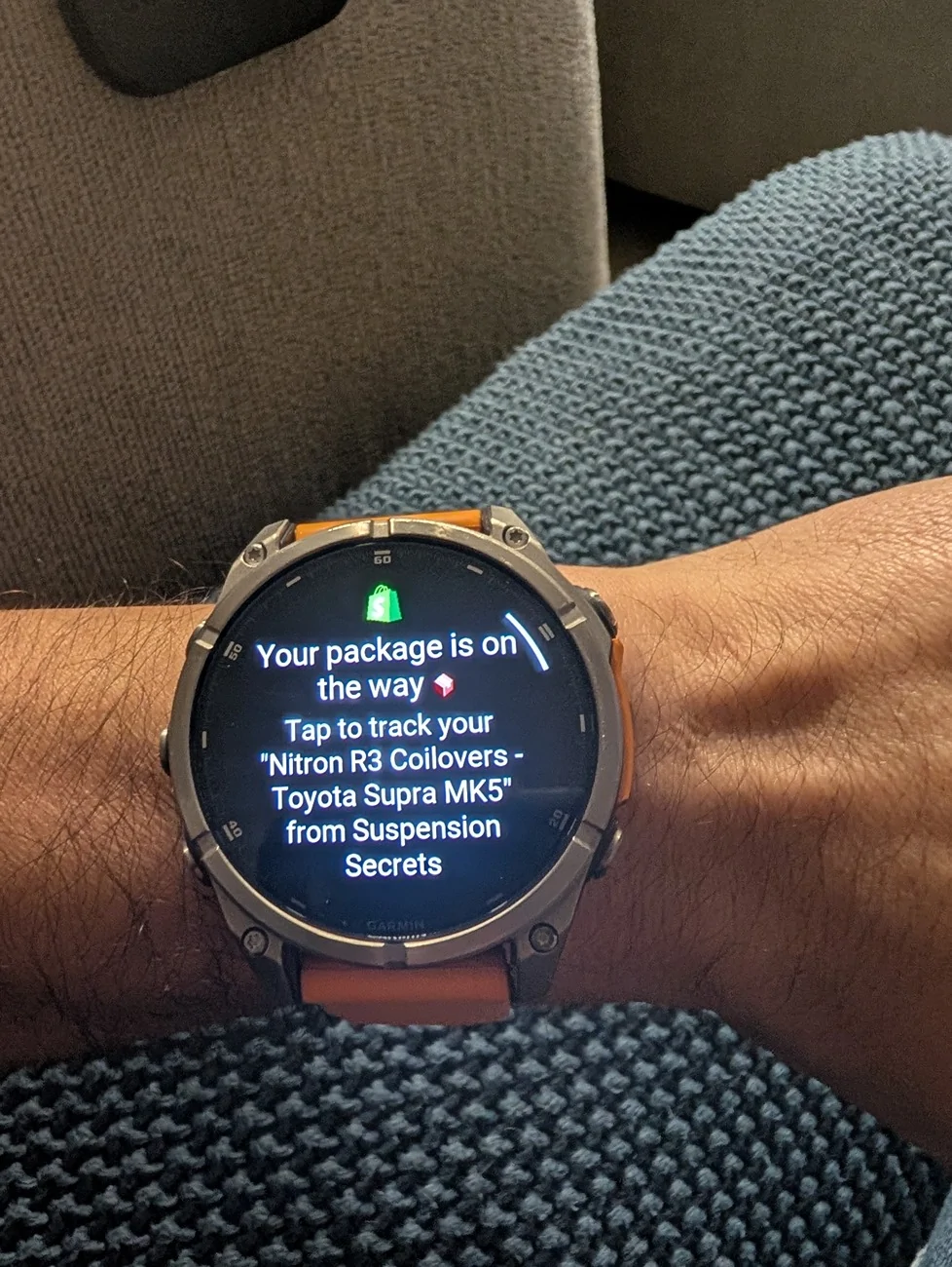

Finally shipped.
I've also spoken to both Nitron and Suspension Secrets about the spring rate debate. Suspension Secrets folks think i should go ahead and try the ones i've already ordered and then get back to them. Nitron on the other hand were a lot happier to recommend the Track/Race springs. 457/914 vs the fast road/track ones 343/800 if i thought i wanted a stiffer spring. Not the the type of answer i was looking for, which was more about the logic rather than the rates themselves, but i guess their willingness to recommend a higher rate is.....something.
I enjoy A/B testing things, even when it comes at a (literal) cost. So i ordered the the other set of stiffer springs. Will be a fun experiment. And Nitron assured me that the rates weren't too far apart to worry about valving. It's not everyday i get to run this kind of experiment, so i'm a little excited about it.
