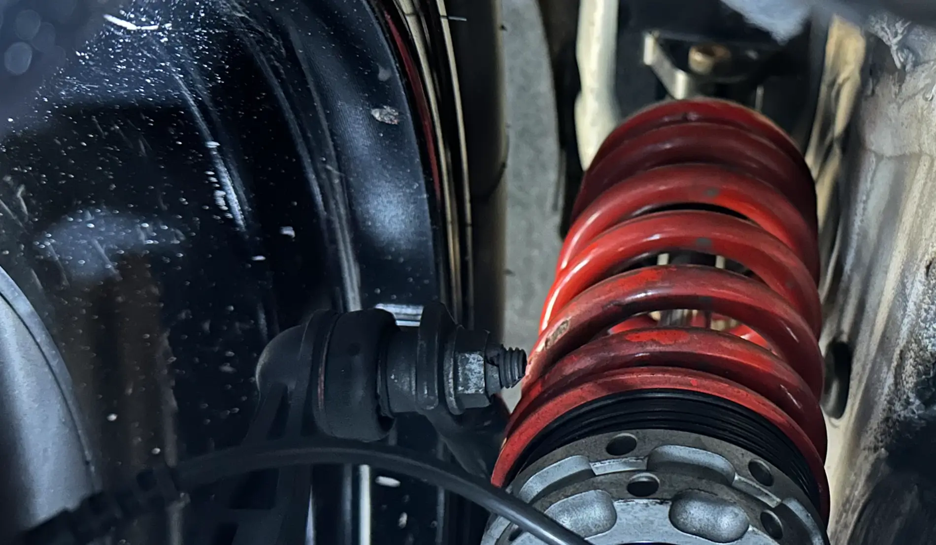

Unless someone can tell me otherwise, I don’t really see a benefit for true coil overs other than the ability to change springs and adjust ride height easier. Maybe big aero can benefit from it. For me, I set it and forget it.
I had clearance issues with my aFe swaybar and had to go back to OEM. Even still, I needed to make modifications to the swaybar link stud and fastener to clear.
8,756
17,169
Meh, that shi self clears. Going on three years of IDGAF:

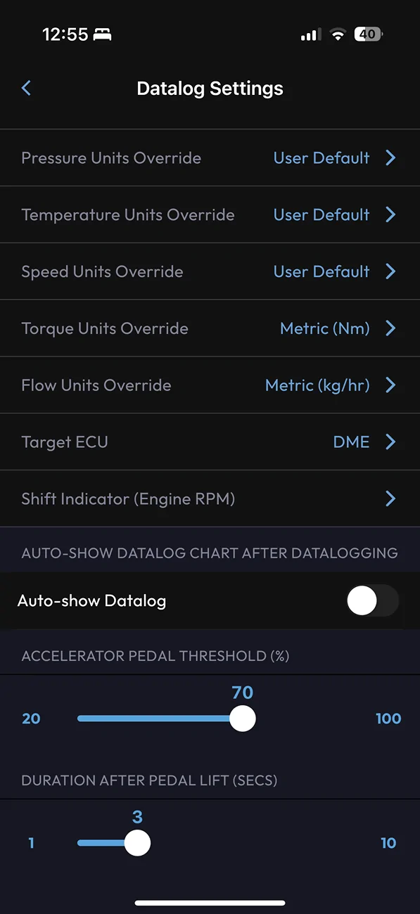

3- FFS i need to figure out how to log with BM3...this is really starting to get to me, but i NEED to log at the track. Everytime i try, i get 1-3 seconds logs at most. There's clearly some kind of interference happening. (Bluetooth is off)

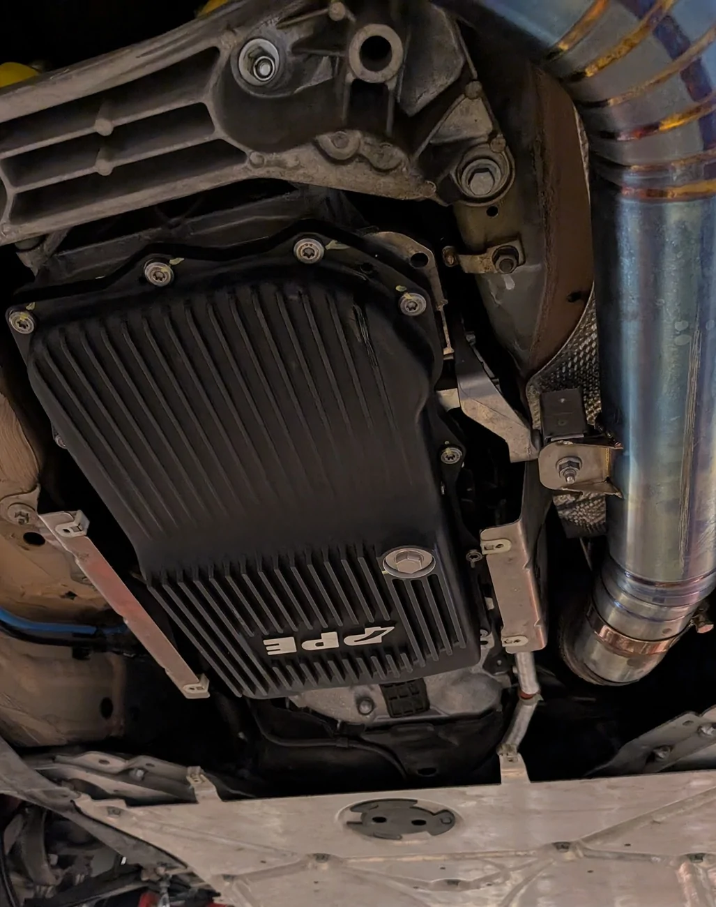

PPE pan. We cut around it to make it fit

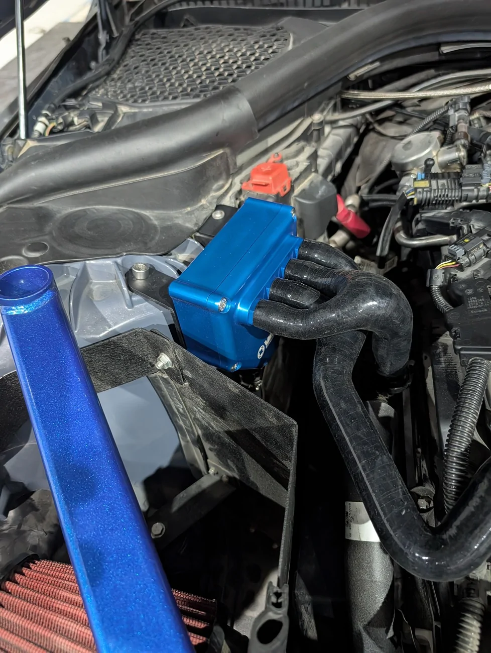

AOS. I don't know if it's even really needed, but 1i'm never going to be upset about a reliability mod and i'm not sure what happens when we keep pushing the numbers up.

bootmod3 logging can be shitty. Sometimes the refresh rates get really really slow, sometimes i lose connection. Shut down the app, cycle your WiFi, unplug/plug your dongle.
not sure if you adjusted the logging thresholds, but you can go to
Menu-> dashboard -> configure dashboard -> data log settings -> scroll to the bottom.
