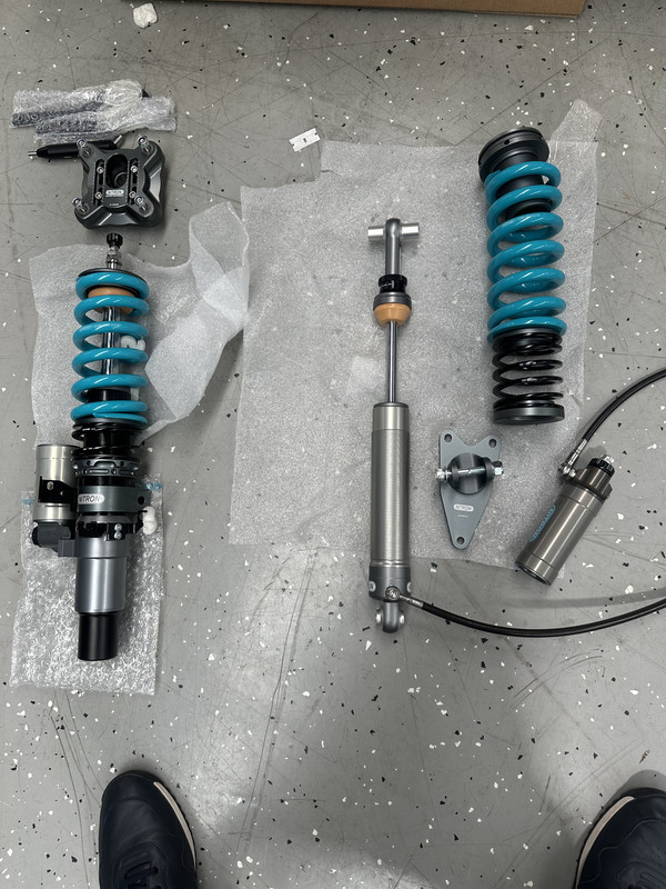

I just received my Nitrons R3s yesterday, they are beautifully made.
Spring rates were supposed to be
16kg front (895lb/in)
17kg rear with true coilovers. (951lb/in)
But they sent me a divorced rear spring set up so asking them what's up before I install.
I currently have 24kg (1343lb/in) rear springs in the car so could just use those.
I have decent aero, Sydney composites dual element wing and diffuser, Triple 7 hood vent, canards and a custom splitter are currently being made.
Now that sounds more proper.
