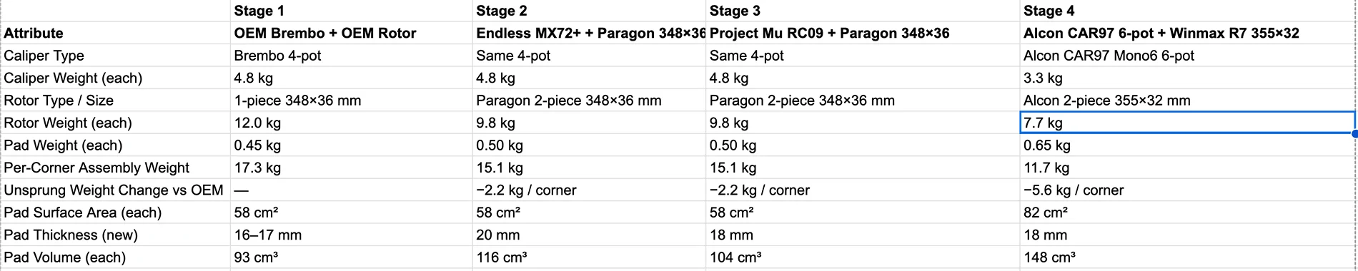

Back to this again. OEM data is a bit tricky, but i'm fairly certain the numbers are either accurate, or close enough to be representative
Here's the progression of my braking setup
So with my new setup, i'm dropping another 3.4kgs (7.5lbs). That's 5.6kgs (12.3lbs) less than OEM. Unsprung of course.
And in the process i'm increasing pad surface area and volume significantly. The downside of course is the thinner pad than something like the 25mm in yours. Mine will heat soak sooner. That's something i can live with though, because i don't do 30 mins of continuous driving. Or 20 even. I'll do a few hard laps and a cool down lap or 2 and back on it for a few more etc...I'll occasionally break that rule and do 4-5 hard laps before cooling down, but almost never more.

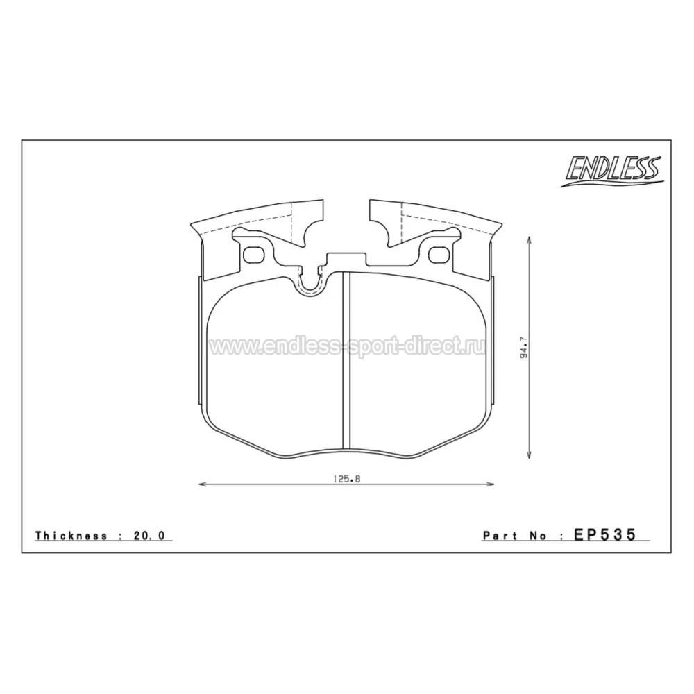

I think your pad thickness between OEM pattern pads is incorrect. All FMSI D1867 pad shapes are the same thickness, 18.8mm, or less.
20mm wouldn't fit.
20mm wouldn't fit.
That's what i thought as well. But for whatever reason Endless for example list their pad thickness for the Supra @ 20mm. Are there different ways of measuring pad thickness? Maybe they cheekily include the backing plate?
8,760
17,183
Manufactures publish incorrect stats all the time. Looking at you Toyota. ;)

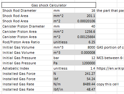

What is the shaft diameter and canister prefill pressure that you're running? I can calculate the gas contribution to spring rate at full droop for you.
Shaft/rod diameter: 16mm front and 14mm rear
canister prefill pressure (range): 11–12 bar front 9–10 bar rear

ok, I'm calculating about ~50 lbf/in rate from the gas pressure with those specs, so the coil spring still dominates.
That's very interesting. So as we're talking about the front shocks here, does that mean the "true" spring rate is whatever i have + 50lb/f because of the canister? Is that would it works?

Correct. There is a slight nuance because gas pressure rises non-linearly, but in a nutshell, yes.
Recall springs in parallel add keff = (k1+k2), but if you look at the spreadsheet, the tire stiffness is a spring in series keff = (1/k1+1/k2)^-1 = (k1*k2/(k1+k2))

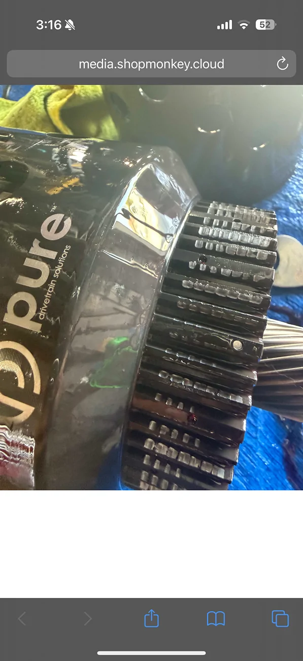

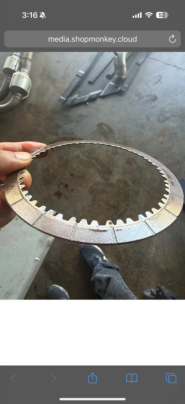

Best to stay away from Pure anyway.
Damn. I'm sorry that happened to you. has to be a fluke though, right? I do like the fact that Dodson is, well, Dodson. Strong name in the business and they often stand behind their product.
That said....

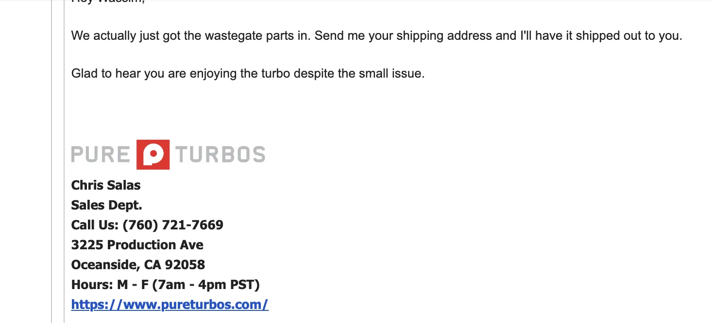

Pure just shipped me the replacement parts for the wastegate. Should have them by Saturday or so. Won't go on until mid next week, so i'm hoping the current patch job lasts the 2 trackdays i have lined up on Saturday and Monday. Chris has been very cool and easy to deal with, and sent me the parts even though i didn't send them the turbo itself to inspect (since i'm halfway across the world). So that was a lot better than expected.
Edit: OK, i was today years old when i found out that Pure Turbos and Pure Drivetrain Solutions are not owned by the same company. Shirley i can't be the only one.....shirley.....please? :(
