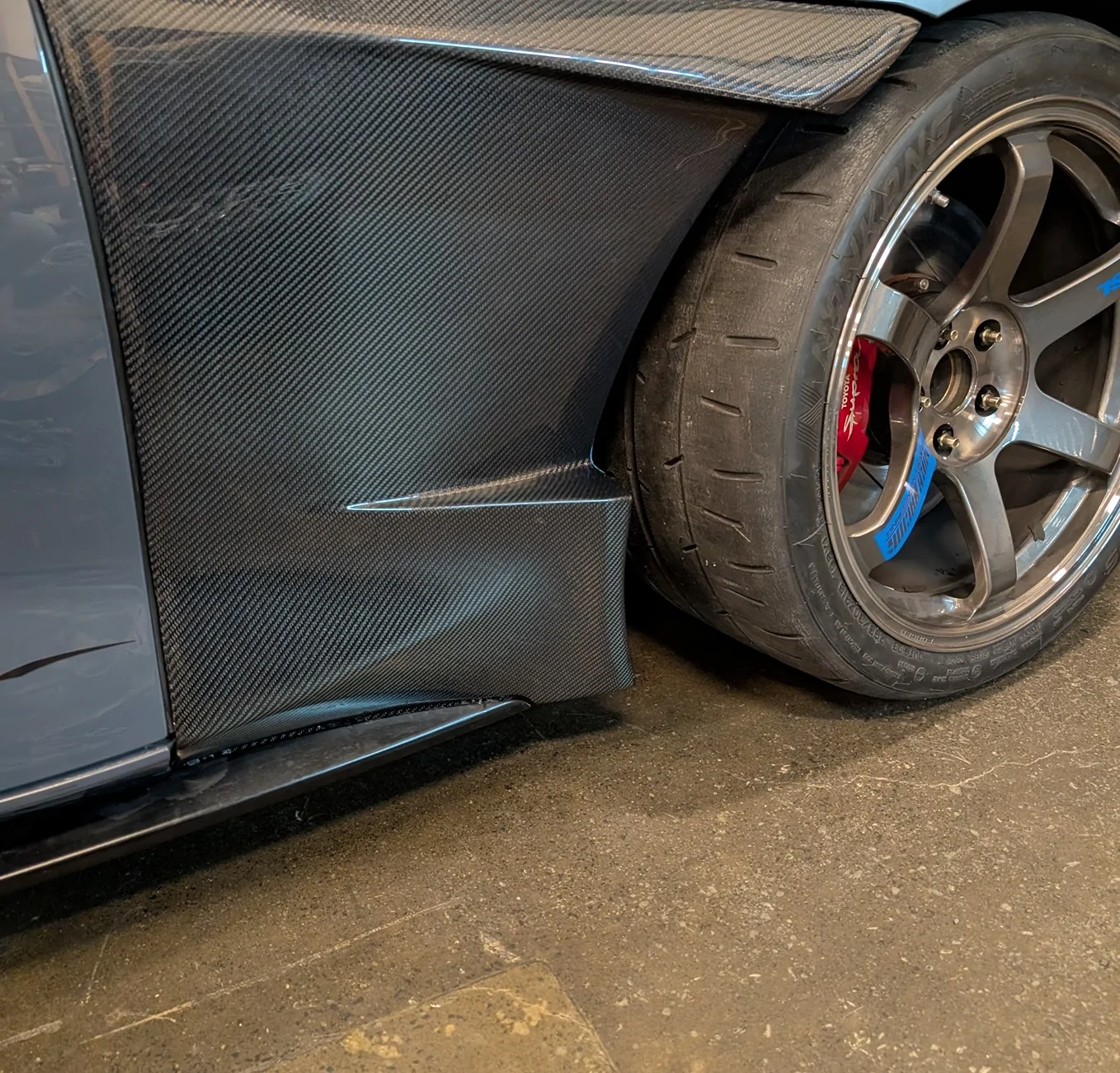

Really is hard to beat these fenders for function. Will be paint-matched

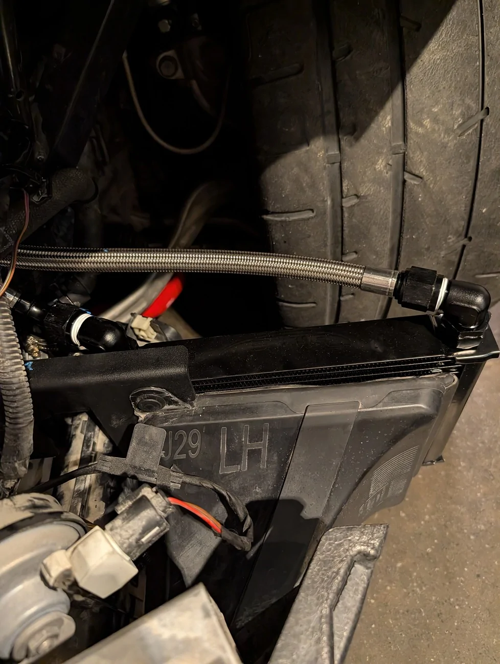

Verus oil cooler shot

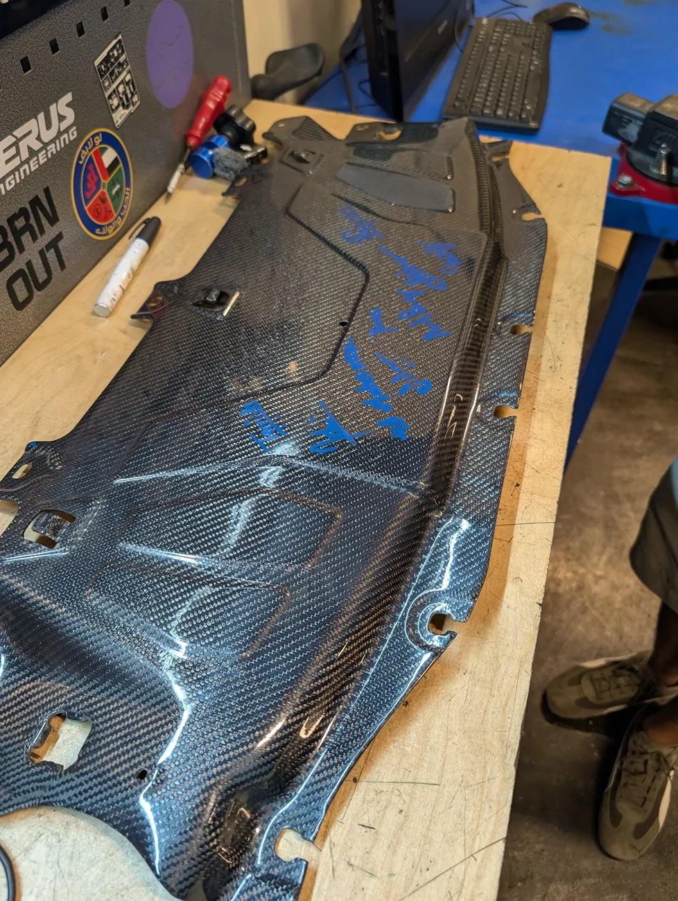

Asked the guys at the shop to sign my cooling plate, so instead of signing my OEM one, they signed a carbon fiber one they made. Nice gesture. They're still working on the plate.

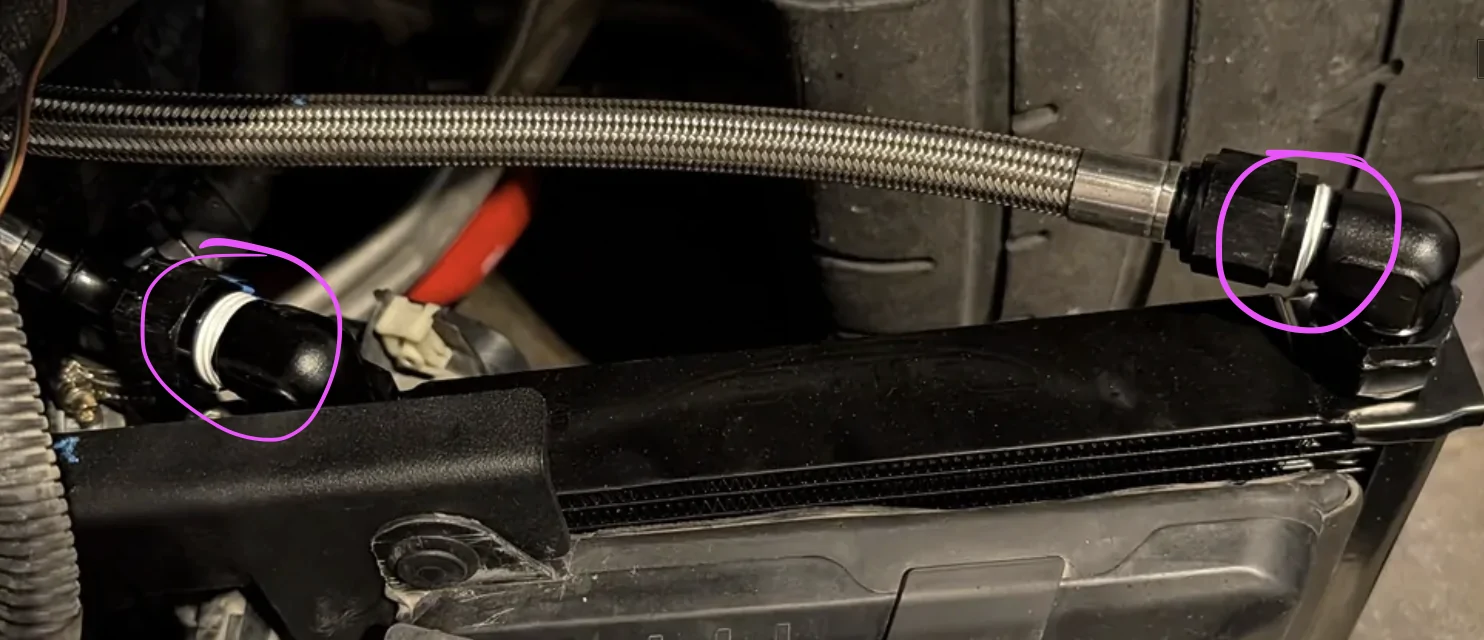

Is that Teflon tape on the AN fittings? Its my impression to not use Teflon on those…
Nope, no teflon. I think you're just seeing the shiny machined aluminum collar?

That is 100% teflon tape. A big no-no on AN fittings.
Will check when I head into the shop. Even I know that you shouldn't use Teflon there, and that's saying something...so I'd be surprised if it is.

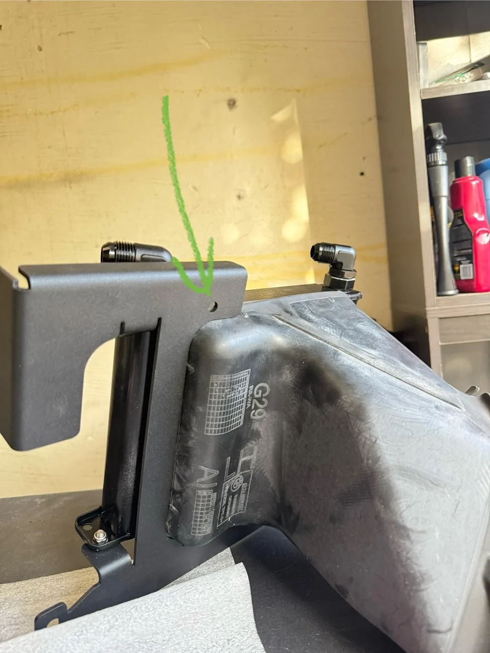

While you’re at it, have them check the mounting of the duct to the oil cooler. It should be abutted to the cooler with no gap. It looks like they decided to mount the cooler first and then they added the duct when the should have added the duct first.
Oof thanks for picking up on that

It was Teflon...

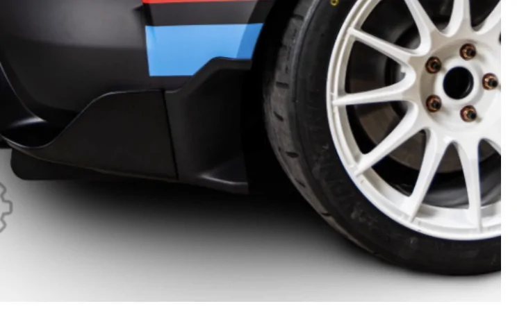

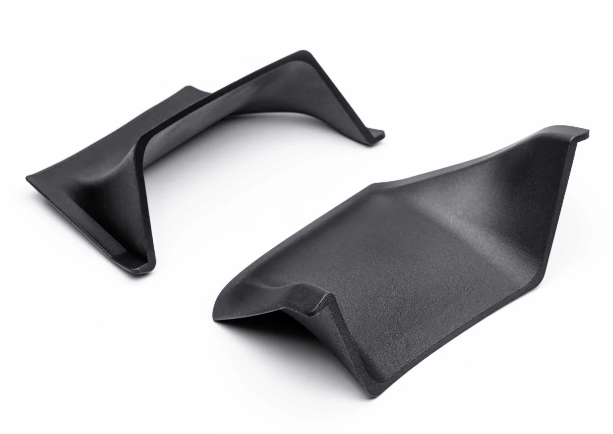

I guess this is my plan B. Not as effective, but....something. Bonus points for being a lot more subtle
Edit: plan B engaged. Ordered these. Stupid expensive for what they are....
