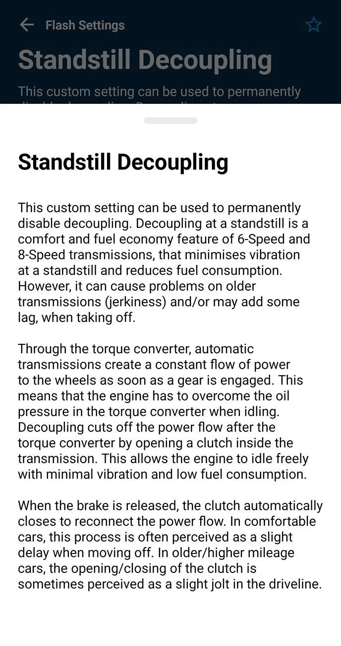

I've experienced this delay with my 2021 Supra as well. I also experienced this in a significantly more severe/dangerous manner with my tuned 135i back in the day.
I recently 100% eliminated this behavior with my Supra with 2 mods.
1. A few months back I installed the Dinan turbo inlet pipe. This drastically improved throttle response.
( As a control I had the Dinan intake without the inlet for 2 months and it made little to no difference to throttle behavior.)
2. Using XHP I disabled "Standstill Decoupling. "
This completely removed throttle tip-in delay/ hesitation for me in all instances and from a stand-still the throttle tip-in behavior is accurate and instant.
Hopefully this helps!
