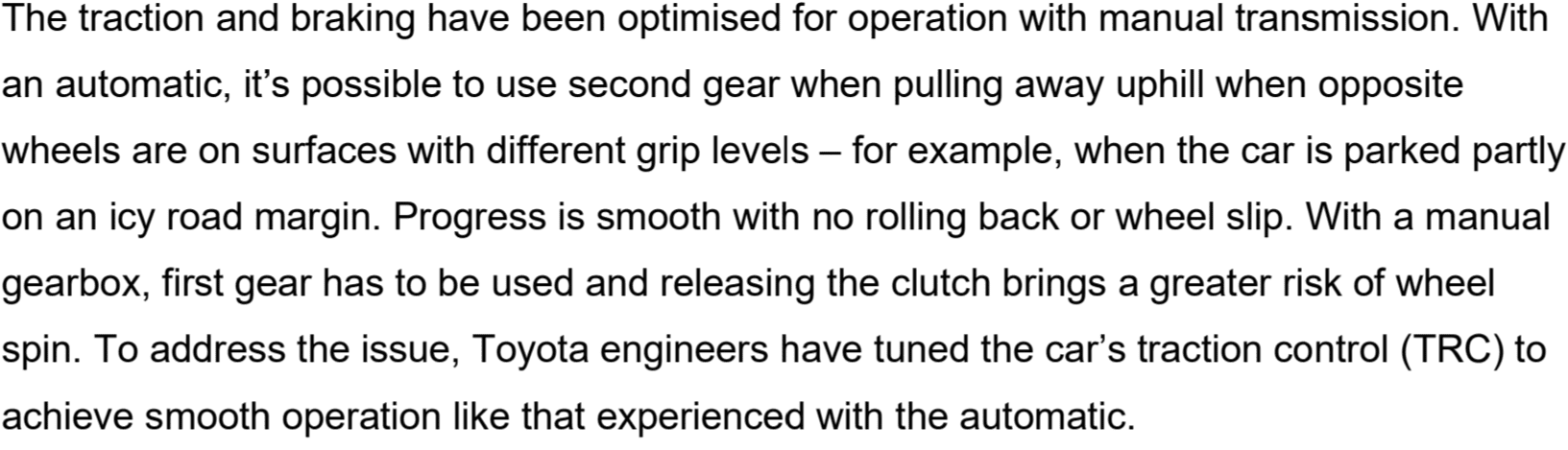

Found this interesting section of a toyota article relating to TC mapping in 1st gear that may affect MTs in regard to ths topic of this thread:
