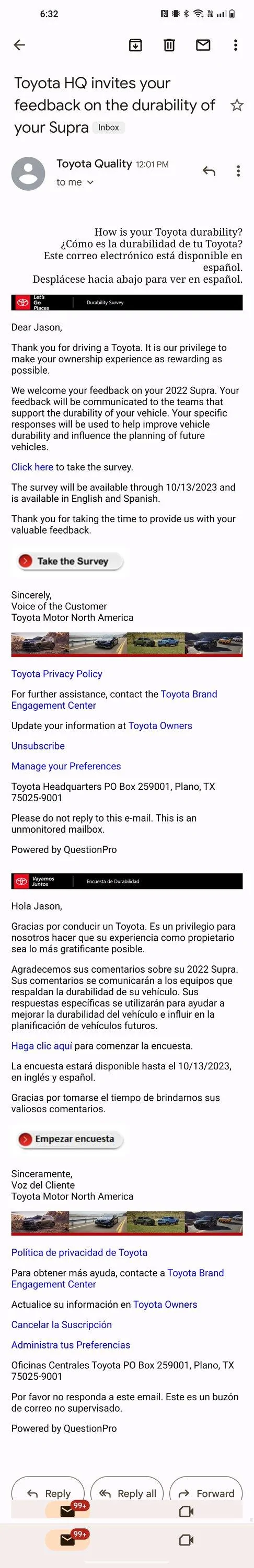

?!!! IMPORTANT PSA!!! ?
Toyota HQ just sent out a reliability survey today to registered Toyota owners, one of the questions asks about power train issues with "Hesitation" as an option and fields to explain in more detail. They must have some awareness of this and looking for direct feedback.
If you receive this survey in your email from Toyota HQ, please give Toyota a link to this thread, select "Hesitation" as an issue, and provide a description of what you've experienced in as much detail as possible. Get the word out direct to their corporate staff in Plano. The more consistent feedback they get from owners, the better chance Toyota NA will put resources into investigating this and hopefully get Toyota Belgium to get the fix from BMW to issue a TSB and have dealers issue a software fix. We know BMW has already done this for the Z4.
End rant
End rant
