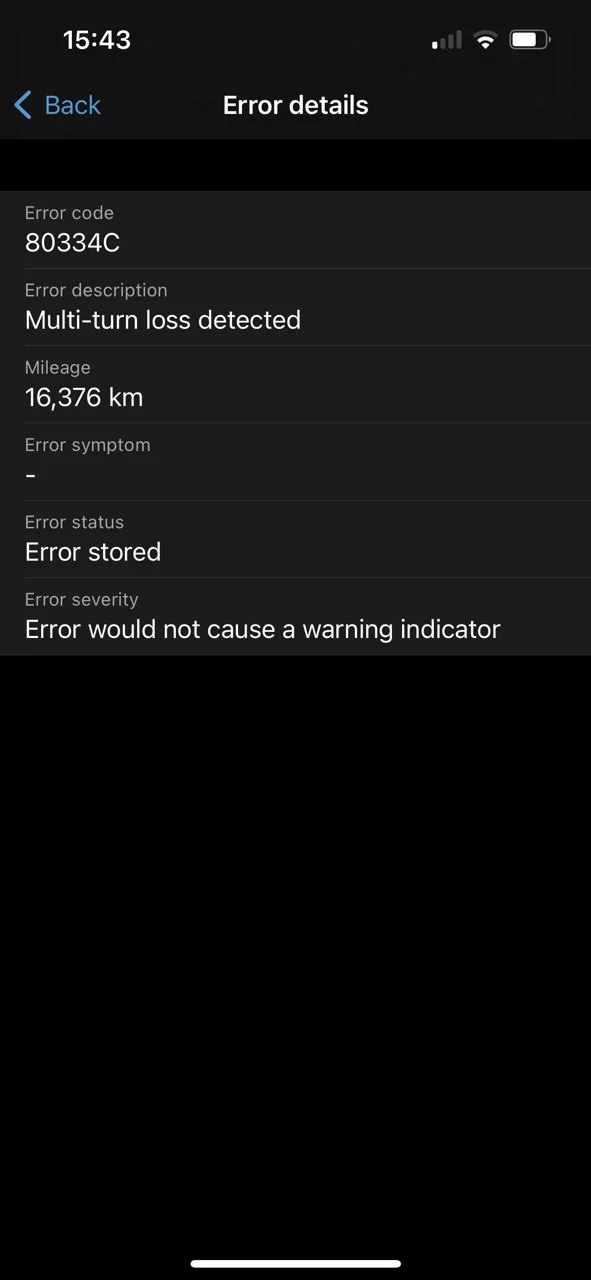

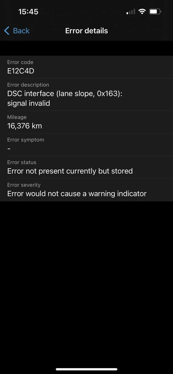

Checked for errors myself. I am on S18T-21-7-519 firmware.
These two happened when the car stalled:
E12C4D: DSC interface (lane slope, 0x163): signal invalid
80334C: Multi-turn loss detected

Looks like it is a TC issue and that explains why it doesn't happen as often anymore after turning off TC
Pretty sure it is as it happens every time when a) one of the wheels gets in the air when going reverse on a slope b) when the throttle is pushed.
If I just roll down without pressing the pedal, it will be ok, no issues.

I had those same error codes in my error memory. I wasn't checking the codes for the topic of this thread though, was for other reasons. But I do experience the hesitation from time to time. Recently experienced it multiple times in a row simply from driving off casually from a stop light. So, not too sure about the triggers of this issue.
