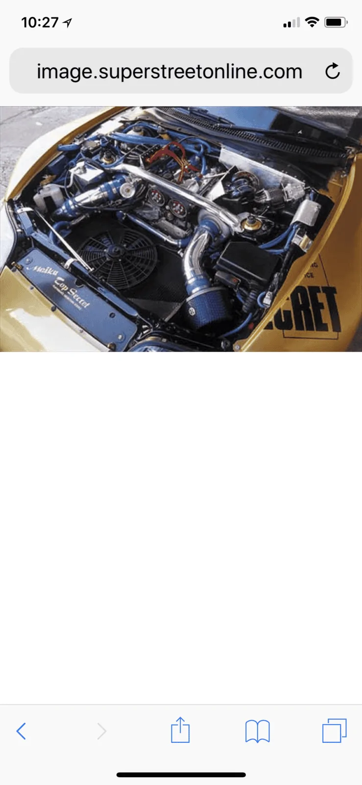

Fyi - JGTC Supra never had a 3S; it had a 503E race engine.
They are significantly different engines and none of the parts are interchangeable. But my understanding is the 3S is loosely based on the 503 design.
I’ve stripped down a Rev 2 3SGTE, 3x Rev 3 3SGTE’s, a Rev 3 3SGE and a Rev 5 3SGE so I really do know my 3S engines.
I then went to Toyota MegaWeb in Tokyo where I got to look under the bonnet of the Castrol Tom’s Supra and also saw a 503E up close on a engine stand; doesnt look anything like a 3S.

(I think that was more of a general reply but...)
it's a good point; it was a 503E
while we're being pedantic though... it has been referred to by Toyota as a 3S (3S-G改/3S-GTM)
