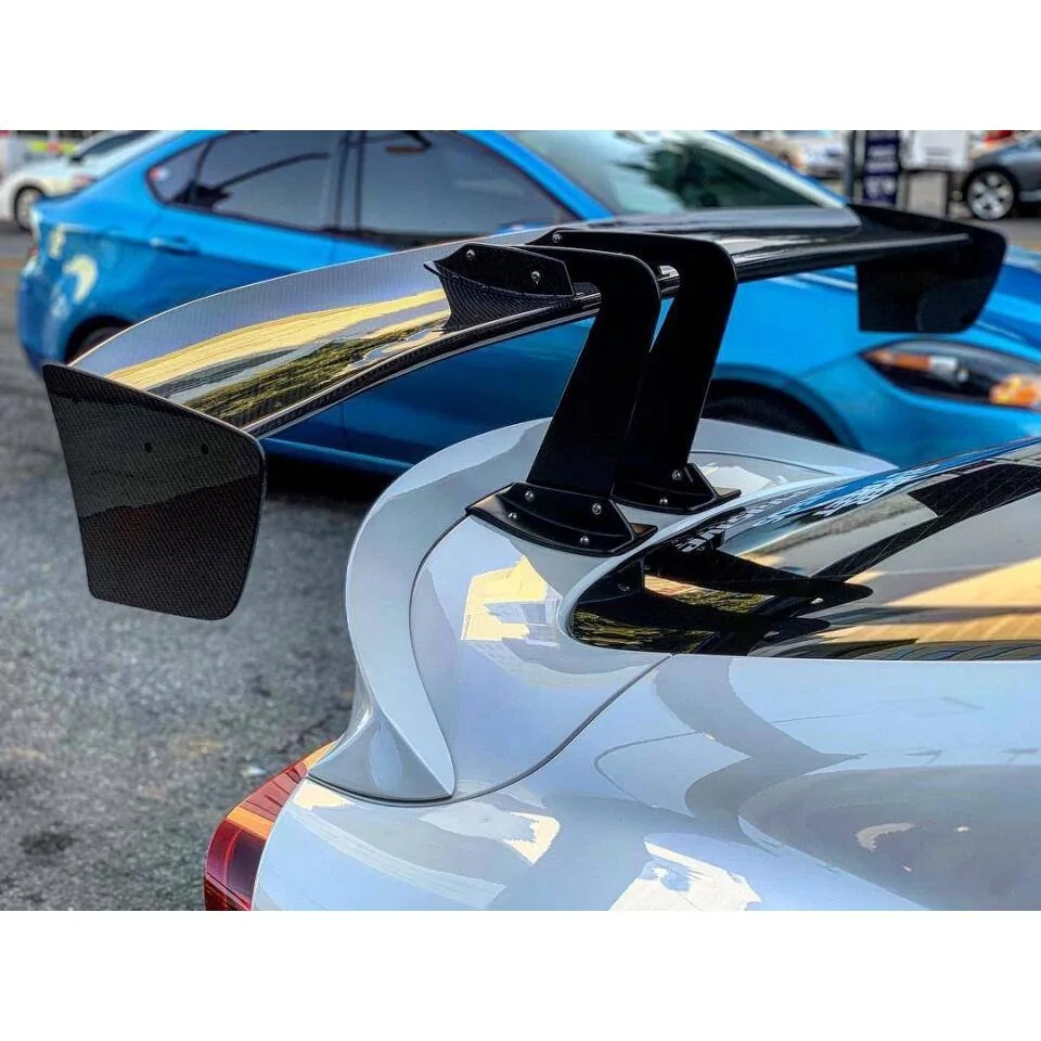

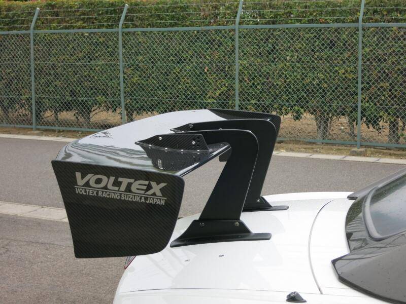

Nope -- the Type 7 has a significantly deeper/bigger air foil than the Type 10. The Type 10 seems to be the popular one among Supra owners, but I wanted the higher DF of the Type 7.
This is the Type 7 (Supra not pictured here, but it's the same wing)
This is Type 10
This is Type 10
I really like this wing. The 7 looks like it has more width between the uprights also which I personally like better.

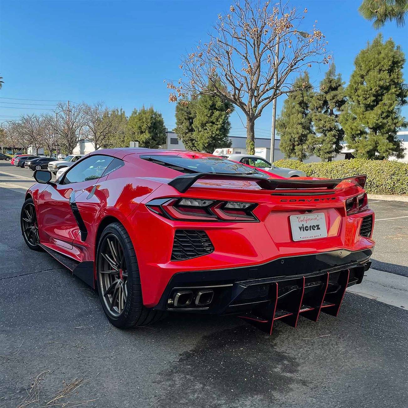

I would guess that the wind over and around the spoiler has some beneficial effect. Take a look at the C8 Corvette's Z51 option rear wing. Here's what is stated by GM about the Z51 package add-ons:
The front splitter is more aggressive. It’s designed to reduce lift and keep your Corvette glued to the tarmac during high-speed runs.
Next, there’s a rear spoiler that’s more than just a good-looking accessory. This wing adds downforce, which means better stability at higher speeds and even more grip when you’re carving corners like a Thanksgiving turkey.
These components aren’t just slapped on for show. They work together seamlessly, providing a balance that makes the C8 feel planted and confident. Whether you’re hitting a straightaway or navigating a twisty mountain road, the aerodynamic additions from the Z51 package really make a difference.
Marketing hype? Who knows, but the wing shown is not exactly a replica of that used on the McLaren Senna with over 800 HP.
Bless your heart. I remember when I used to read marketing copy and think it was actually accurate.

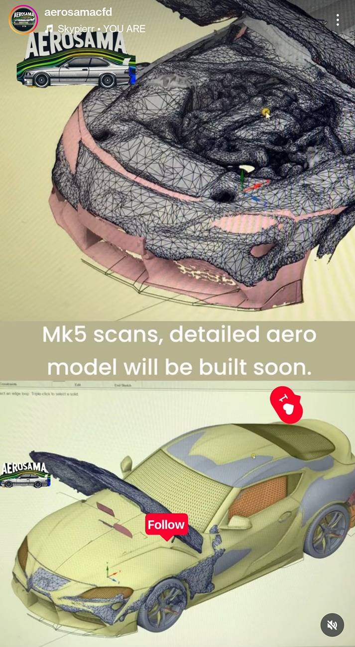

if you're actually serious about finding out, i know an aero guy on ig/fb that does scans and simulations as his side gig.
Yeah man, that’s the plan... Find someone to do a CFD analysis on it if I can unless it’s like super expensive to have that done. From a practical standpoint I was going to measure the pressure differential and multiply by surface area kinda like GRM did in this article:
https://grassrootsmotorsports.com/articles/low-buck-aero-testing/
