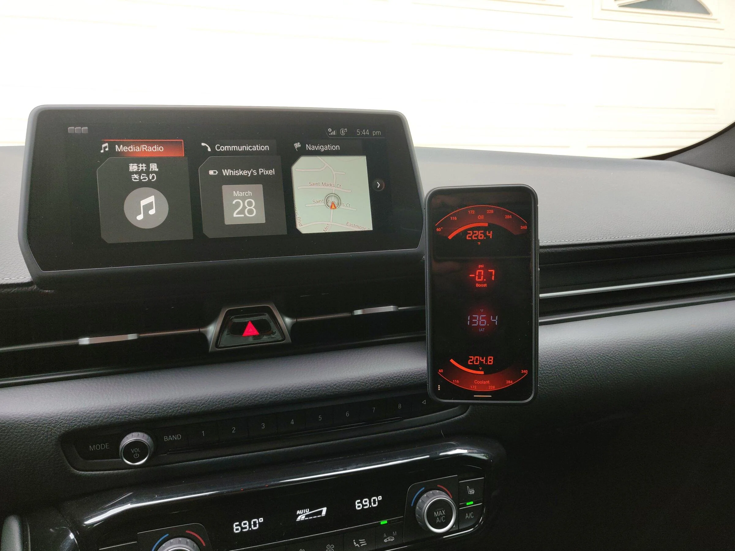

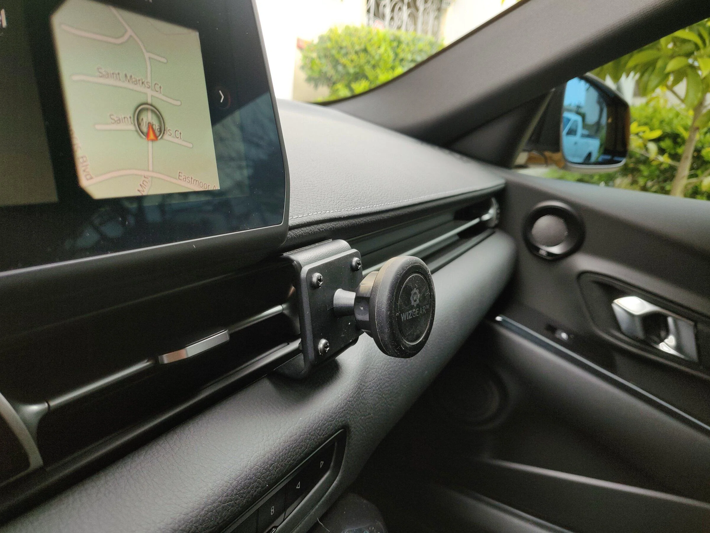

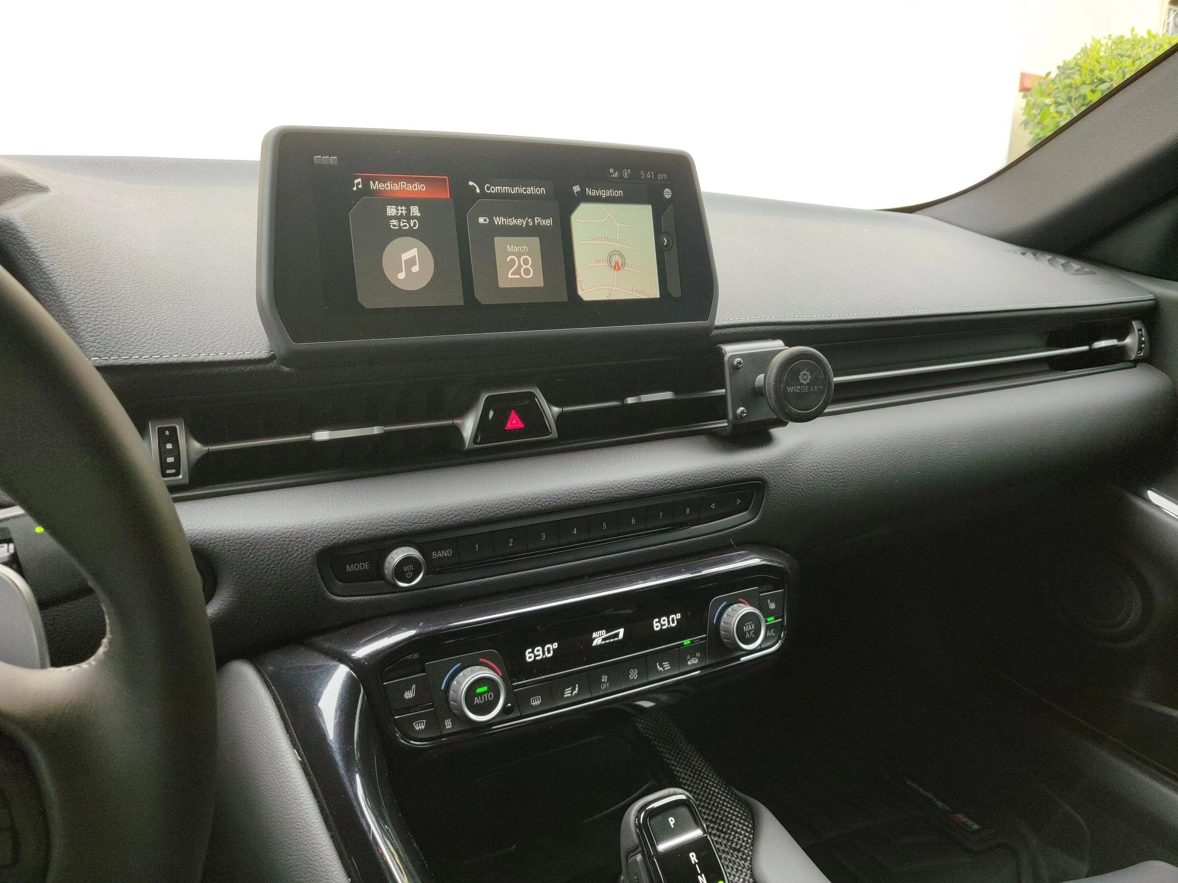

I did a thing.
After waiting for 3 weeks from ProClip to send the mount out, I finally have a freaking phone holder. It's a mismatch of 3 different items but it's rock solid and looks great to boot. I'm surprised but I actually dig the exposed screwhead look on the mount as well. I also took the time to mirror @Bassoonytoon 's post on using OBDLink to create a dashboard.
Had to make a small modification on the ProClip by drilling out the original holes just a tad bigger so I could use the included screws from the adapter plate, I believe it was either a 5/32 or 7/32. I stole the actual magnetic mount from an old WixGear mount I had laying around, simply unscrewed the knuckle and popped it off and it was a perfect fit on the adapter plate.
Edit - Still trying to make this OBDLink thing work, I really doubt that my IAT was 135F when I snapped this photo.
ProClip Angled Mount
Adapter Plate
WixGear magnet mount

That's high, but it's not insane. These cars heat soak like a bitch.
Wonderful. I'm guessing the oil cooler is also a little lacking? I've smelled "hot" multiple times when sitting in traffic, which is always fun.
My other car regularly gets to an IAT of 140F if it’s hot out, the car is up to temp, and I’m sitting still. In FL FWIW. IATs while driving are more important (X degrees above ambient).

Heat soak is an issue. If you are concerned with IATs and don't have a Verus turbo heat shield, by all means get one. It makes a world of difference.
I have one sitting in my garage actually, just waiting for my MST intake to arrive so I can have everything done at once.
