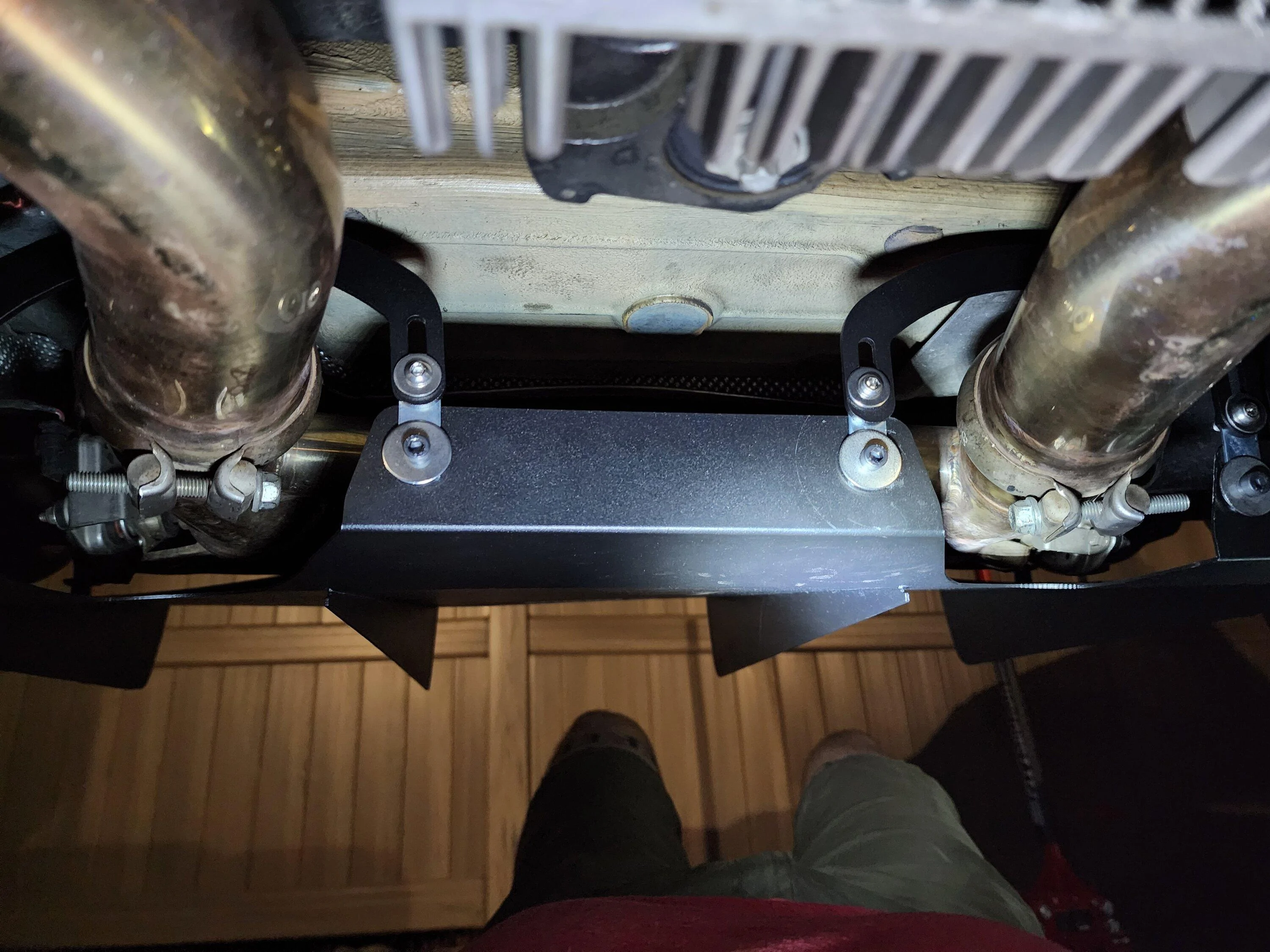

Installed the Verus Engineering rear diffuser. Got some track days in August to see if I feel any difference.
Literally just did the same thing. Pain in the assssss getting everything to align around the dumb ass FI exhaust I have.

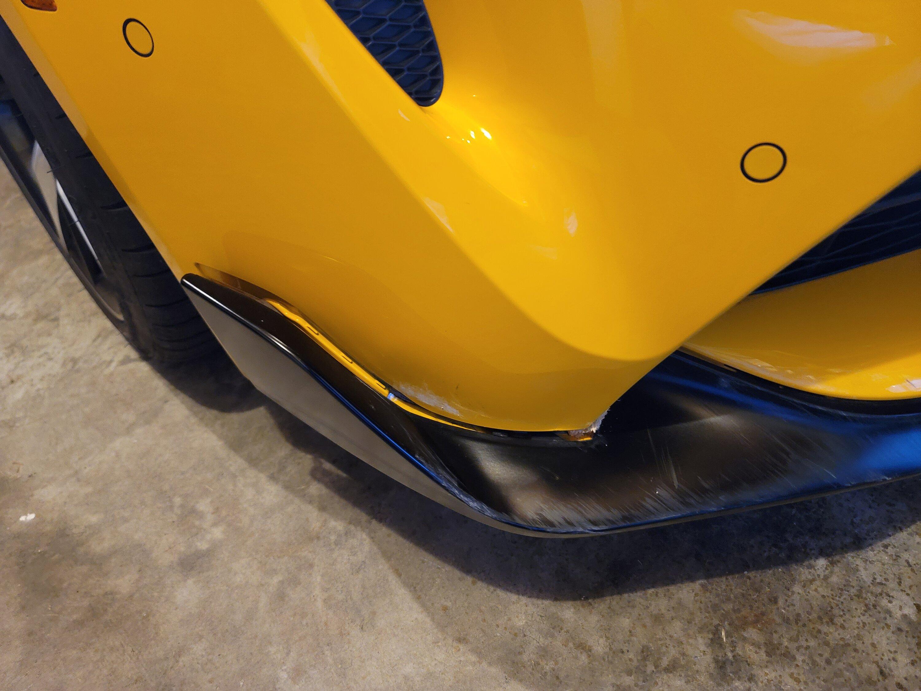

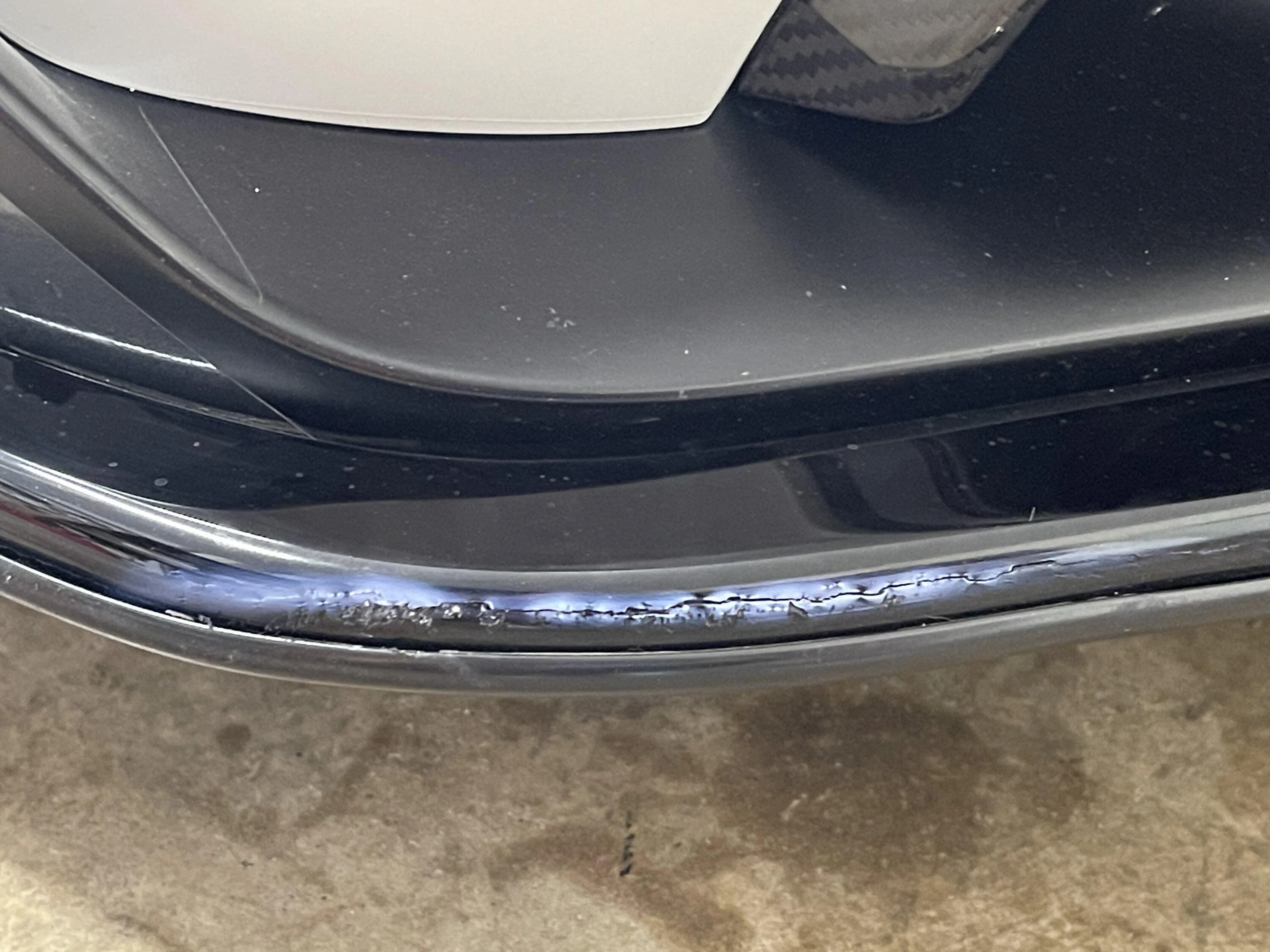

So much power that I decided to hit some plywood on the freeway and damage my front bumper right after the install ?. People need to secure their damn loads...
Pop it back into place + a little polish, it'll be fine.

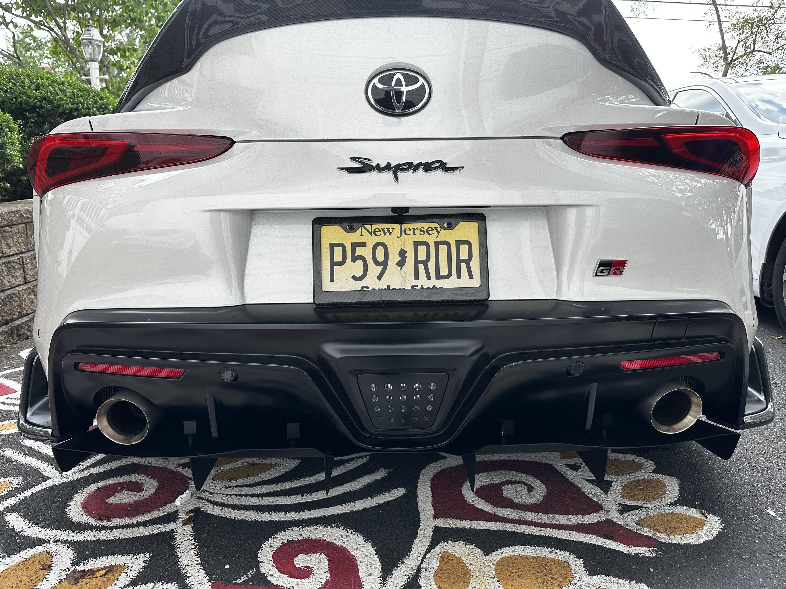

Dude same lol. It was so annoying to put on and for some reason none of the hardware they gave me fit each other. Had to improvise a lot.
Do you also get rocks collected in yours lol? Like small ones?
Damn that sounds way worse. At least my hardware fit even though I had to improvise and extend the U mounts lol.
I have up trying to make it level while on jackstands too and lining up all 3 rear sections to be level laterally was super annoying. Looks great but no idea if it's aerodynamically optimized at the angles it's at lmao

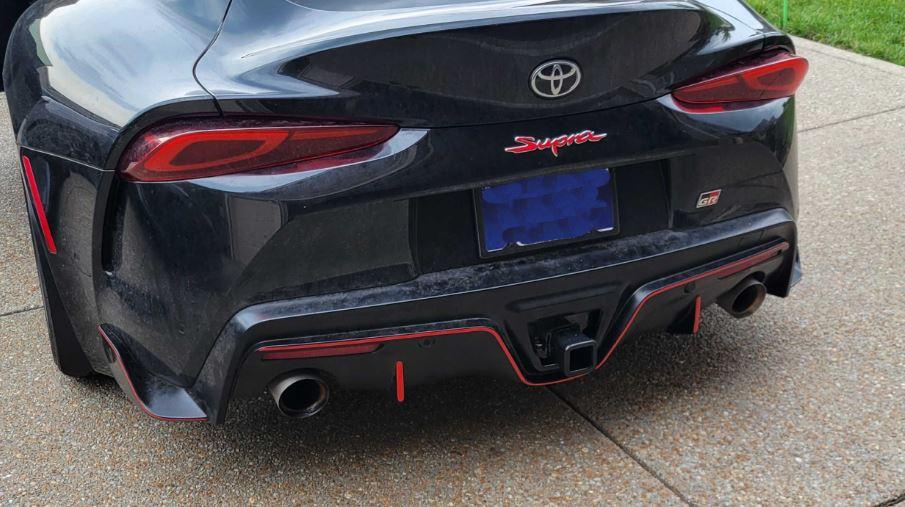

Tow hitch installed and seems really secure. Should be great for bringing tires and tools to the track. Took a little trial and error on fitment but went about as well as I hoped. I went with a CURT 19101 hitch and drilled holes in the rear impact bar to mount it. Used some threadlocker on the pass through carriage bolts to make sure the nuts stayed on.
For the 4 screws that screw the diffuser on, the outside ones needed new holes drilled so I could pull it in to the normal mounting spots as the original ones wouldn't line up due to the hitch pushing the diffuser our ever so slightly. The middle two I just screwed the heatshield back to the spot. It is very secure even without being attached there. The slight pressure from the hitch does a good job keeping it in place. The clips where the brake light previously attached also needed to be cut off on the backside for clearance.
I want to tow my motorcycle with this. Please come do this for me. Lol

I didn't have an issue with those mounts but I understand how you're feeling about the angles. At a certain point I was just like "F it" lol. If it works it works. If it doesn't I'll never be able to tell. ? And I already scraped the crap out of it going in to my driveway. Looks like I gotta angle even more now to get in and my car isn't even lowered lol.
